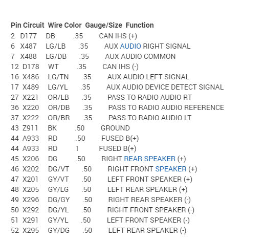

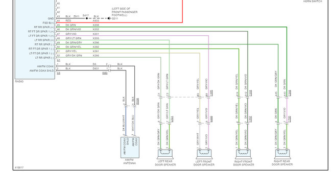

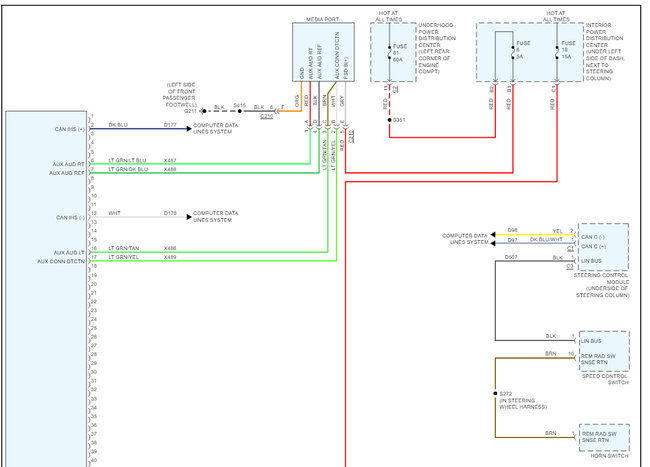

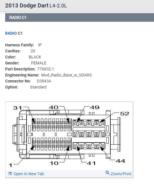

I'm trying to install an inline converter for an amp in my car. Does somebody have a diagram or pinout of the radio harness?
Feb 22, 2022 at 10:05 AM
SQM
Experienced Mechanic
6,383 POSTS
I have attached the pinout as well as the wiring schematics for the radio below. It is for the standard model radio.
