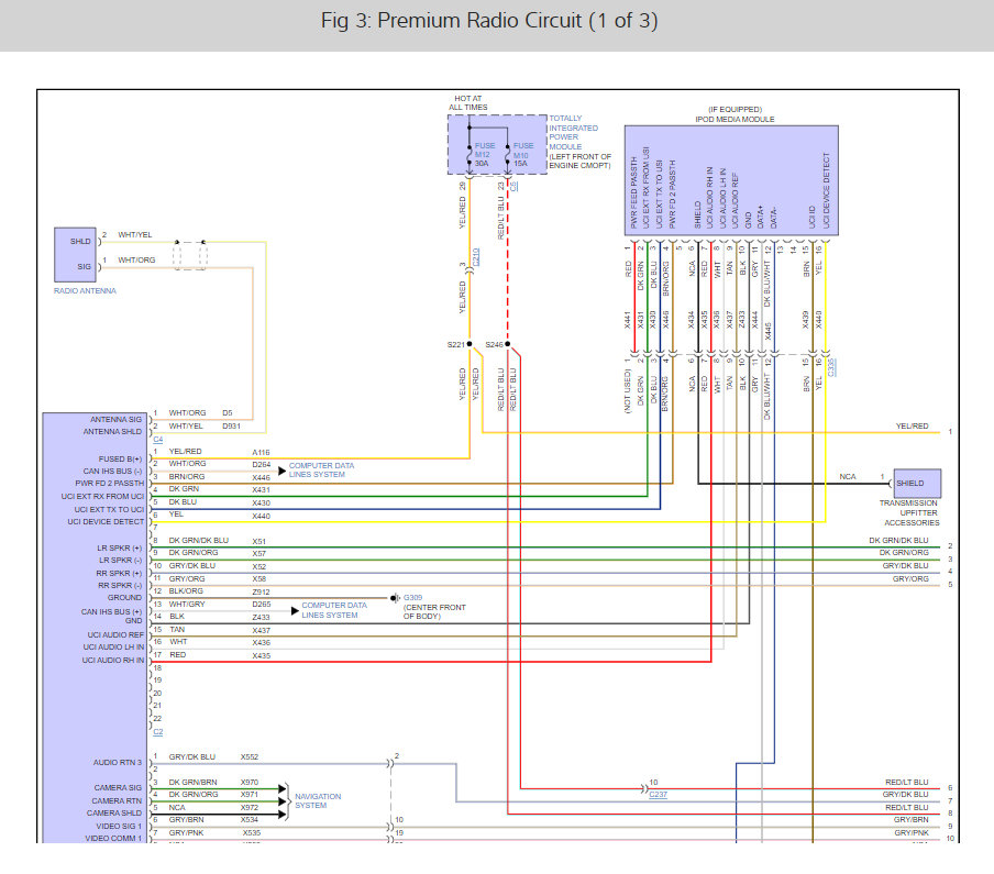

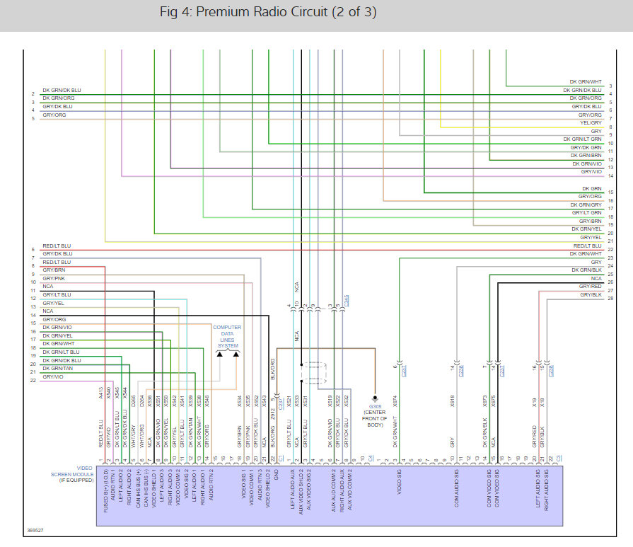

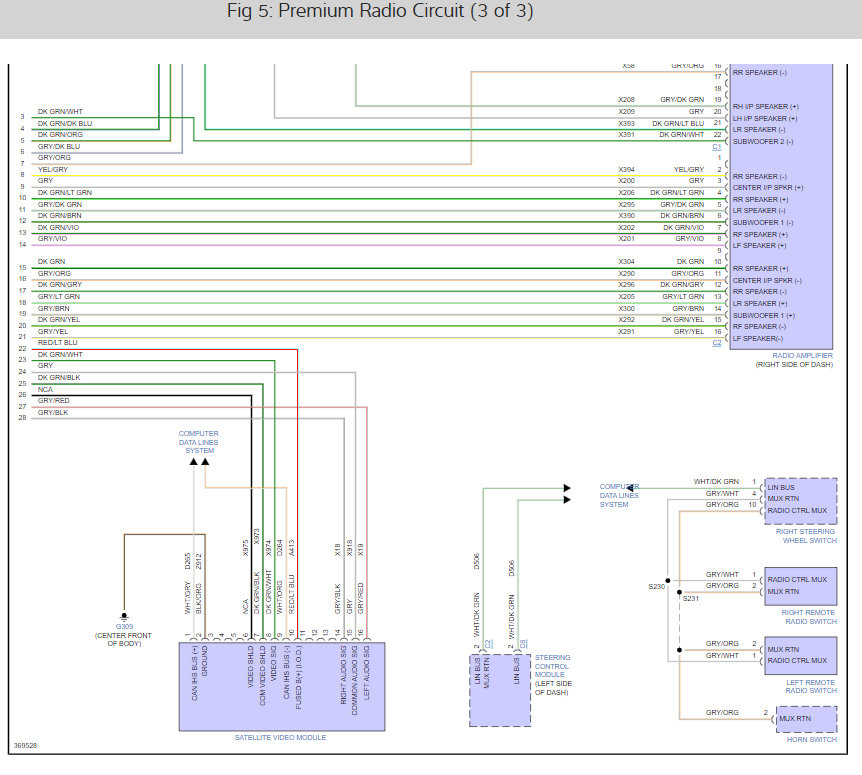

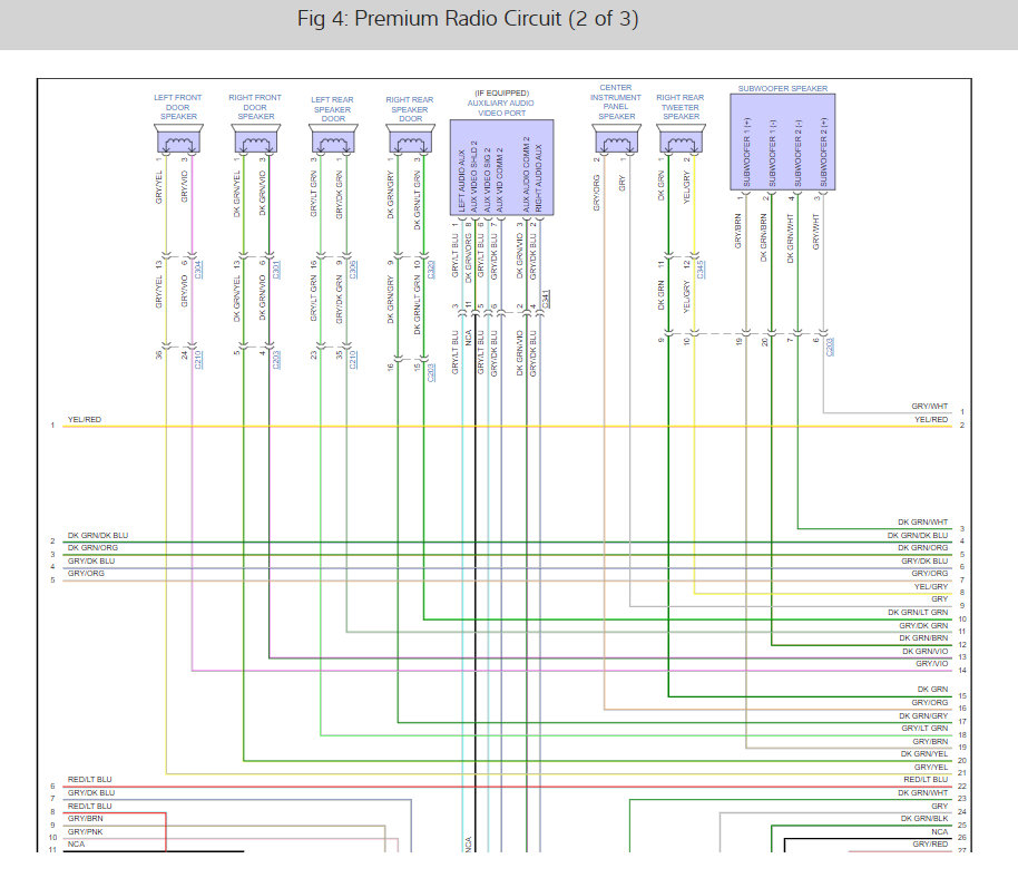

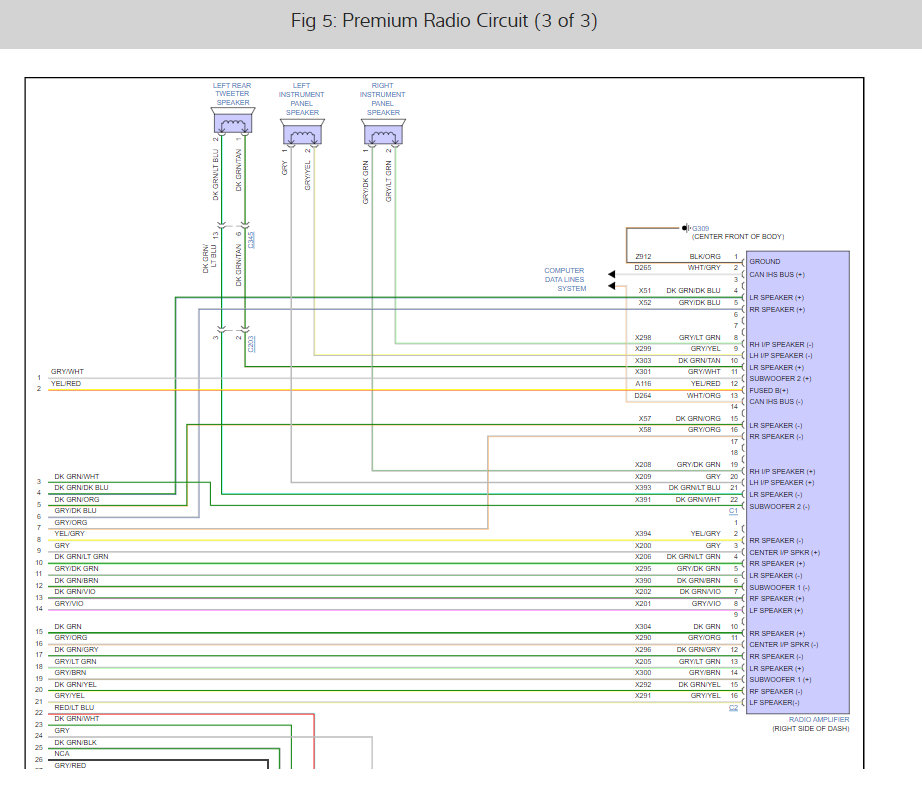

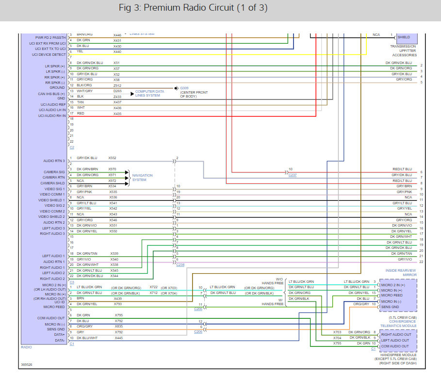

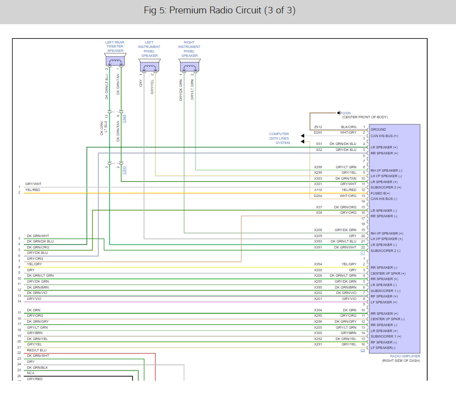

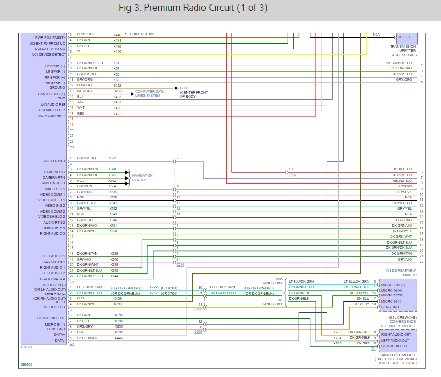

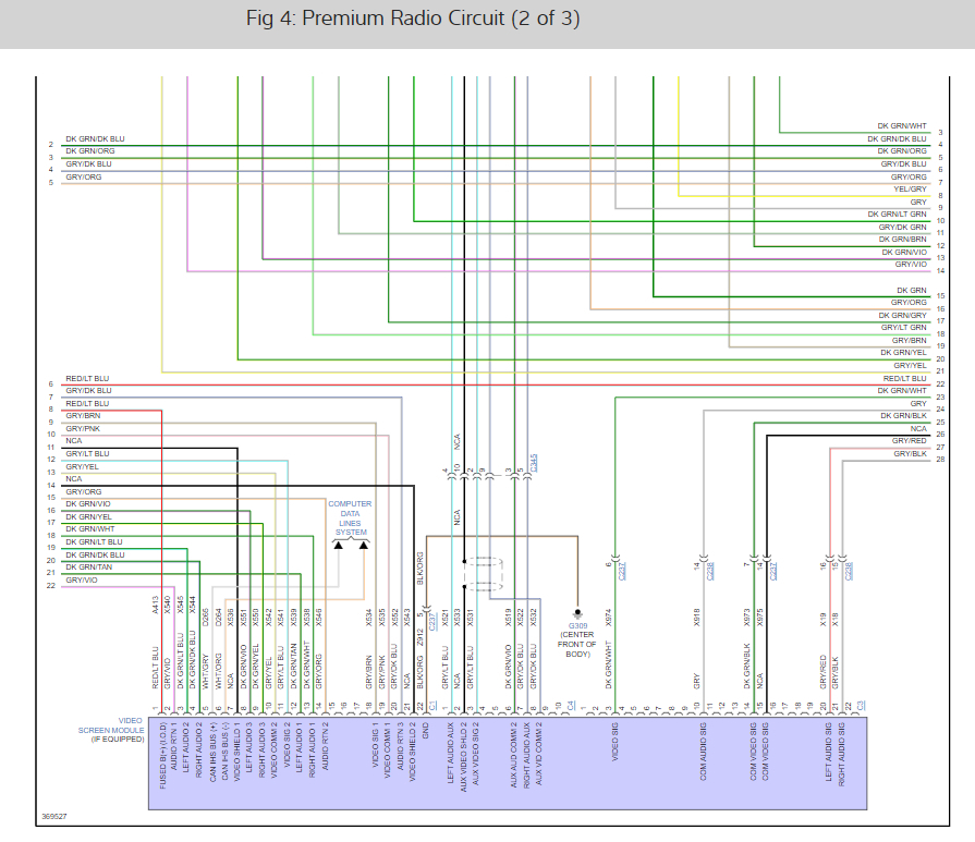

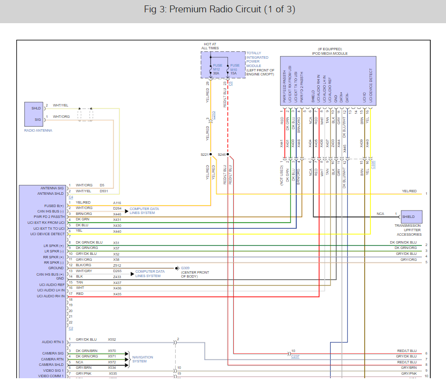

Have the premium Alpine system and need the wiring diagram for the radio.
Jul 22, 2022 at 4:00 PM
Experienced Mechanic
55,561 POSTS
Here is a guide to help you test the wiring connections with the wiring diagrams for the premium radio in the diagrams below.
