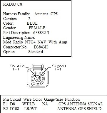

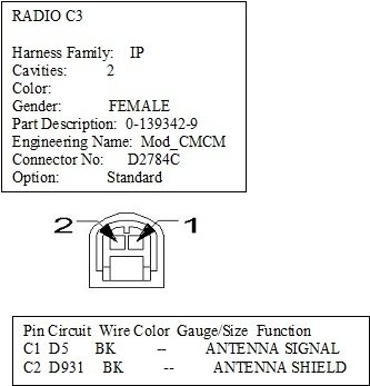

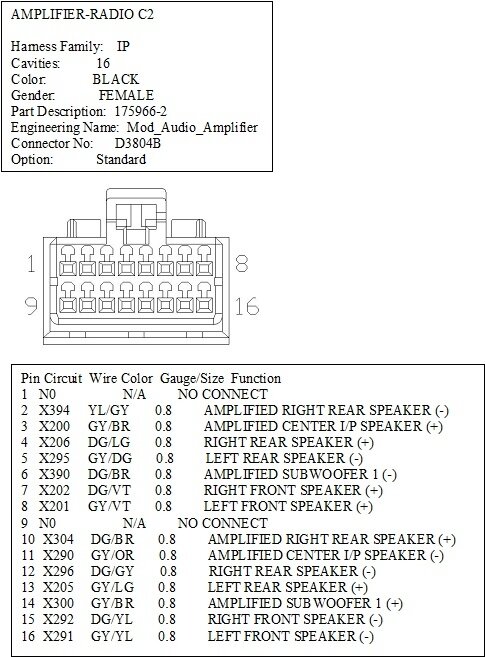

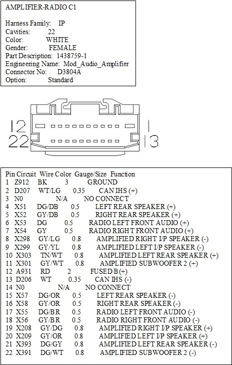

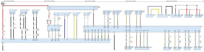

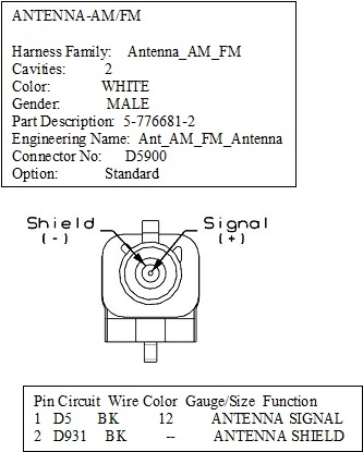

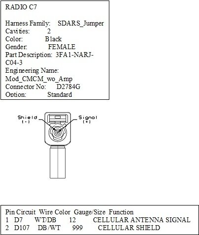

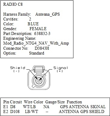

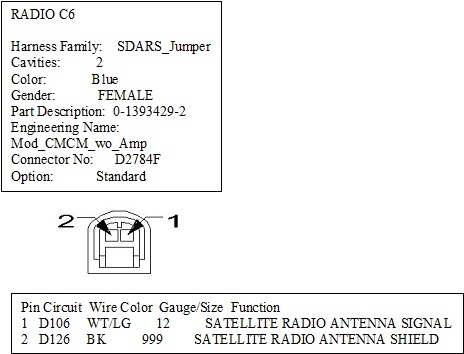

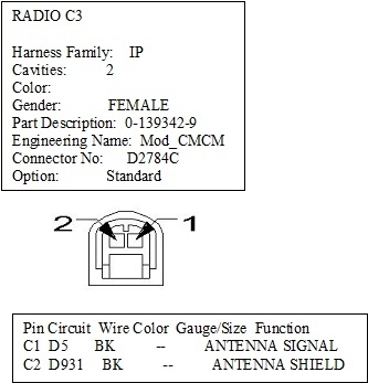

hello, I was hoping someone would have access to a wiring diagram for the factory stereo harness for a SLT 2014 Ram. (No radio controls on wheel)
I was adding RCA cables and needed to splice into the white/black wire and maybe others.
I would greatly appreciate this. Thanks, and good day to you all.

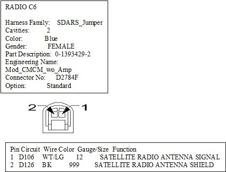

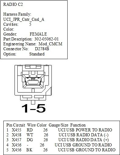

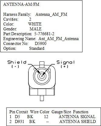

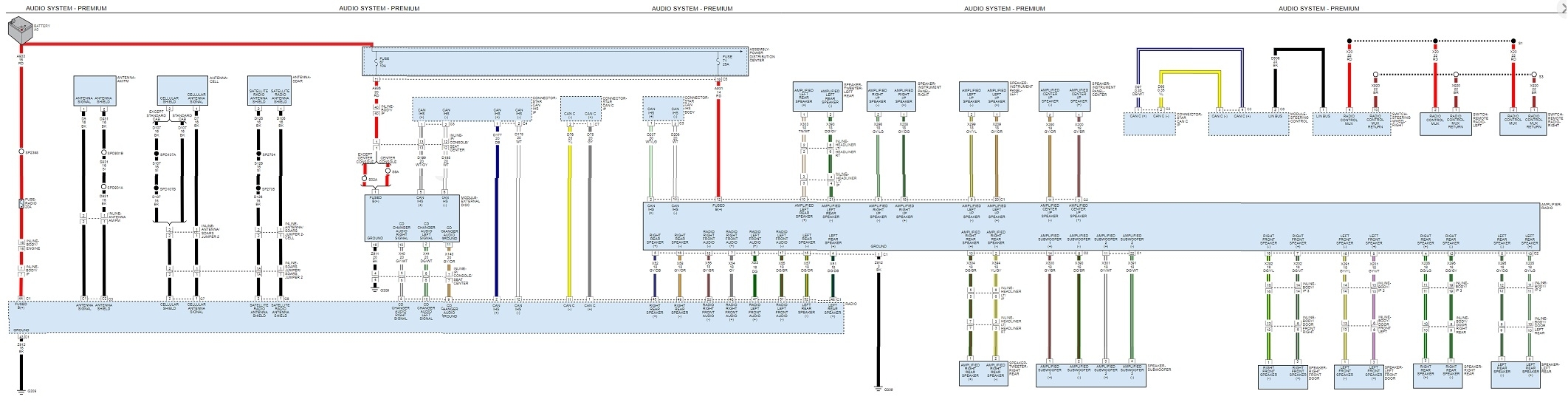

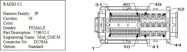

First need to know which radio you have. My 2014 has the touch-screen model. The connectors are different for the base model. These are the connector views for my model. If you need the other version, let me know. Those will take longer as I have to find them and format them for uploading.

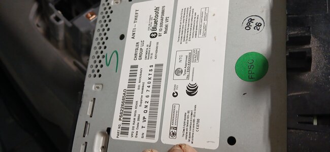

There's two factory models. Does yours include a touch screen with heater controls and GPS?
I just updated my first reply to add the wiring diagram at the end of the drawings.
If you aren't sure which radio model you have, post a photo of the front. I had all of the dozens of model numbers memorized for the 1990s models, but these are too new for me.
Dec 21, 2024 at 8:01 AM
GUNSTERBOB
there is a touchscreen, however control knobs are under the screen.
Dec 21, 2024 at 8:06 AM
CARADIODOC
  • 34,381 POSTS
Dandy. Use what I posted in my first reply. I'll be back tomorrow to see if you need anything else.
