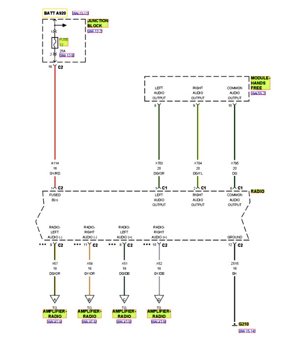

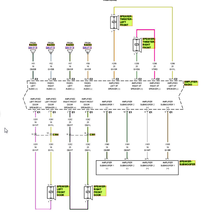

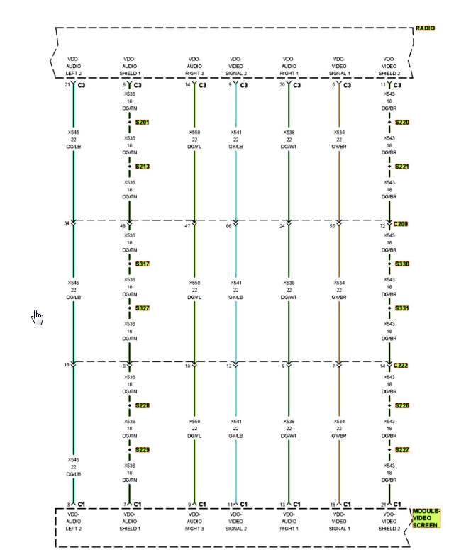

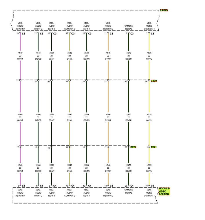

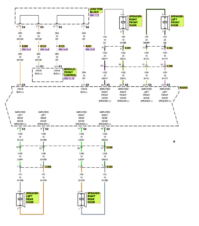

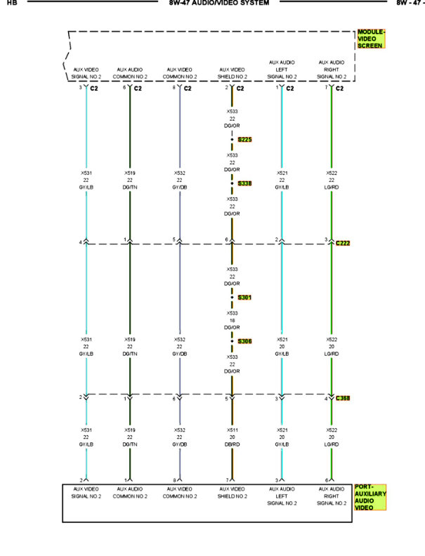

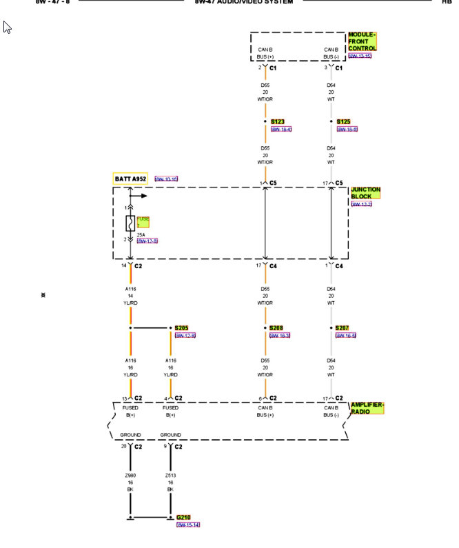

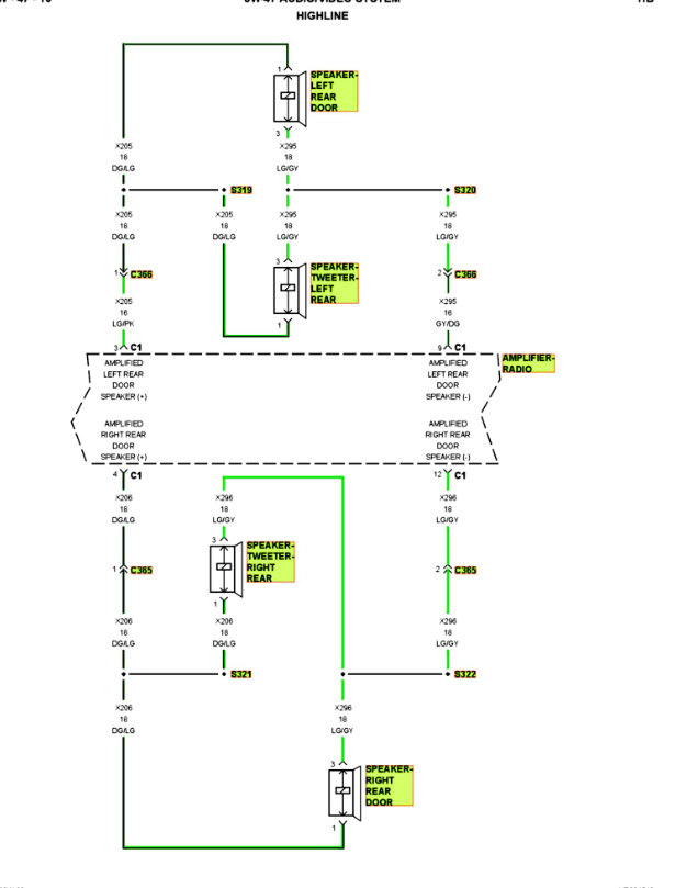

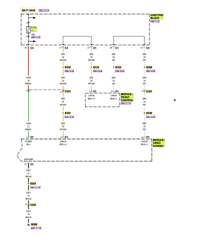

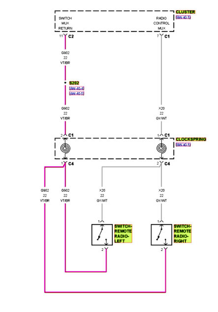

Trying to find wiring diagram for radio to install a voice box.

I am not sure what portions of the system you may need so I just included all the diagrams for the radio and related systems. Check out the diagrams (Below). Please let us know if you need anything else to get the problem fixed.
