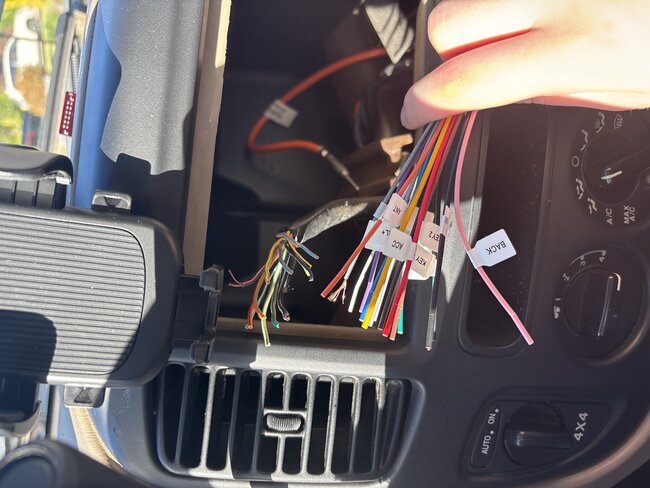

What do each of the wires do on the car? I am adding a new radio and the wires I have don't match the color

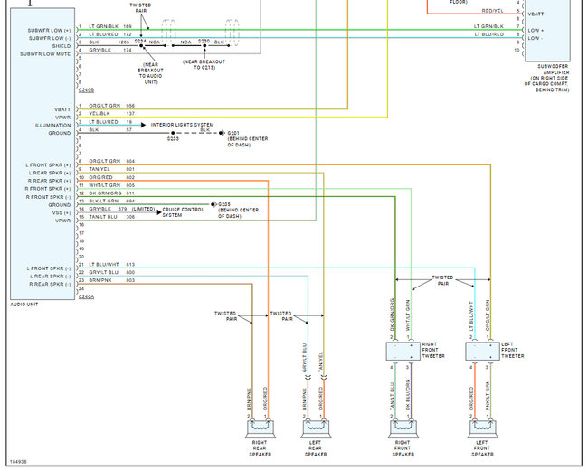

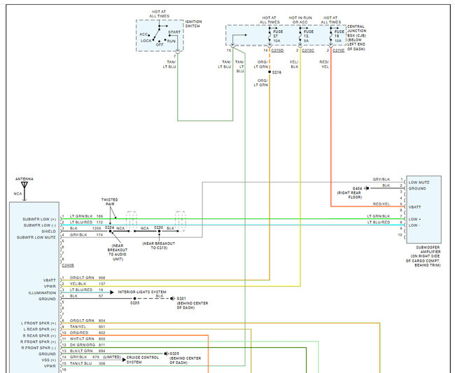

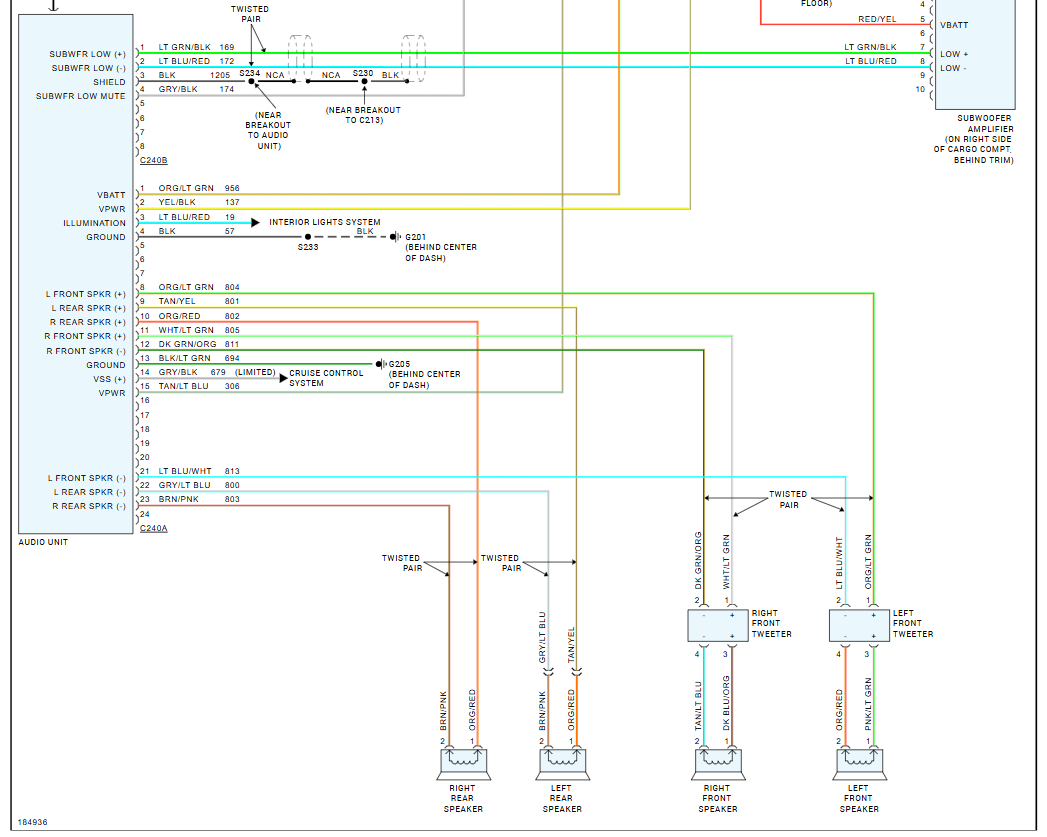

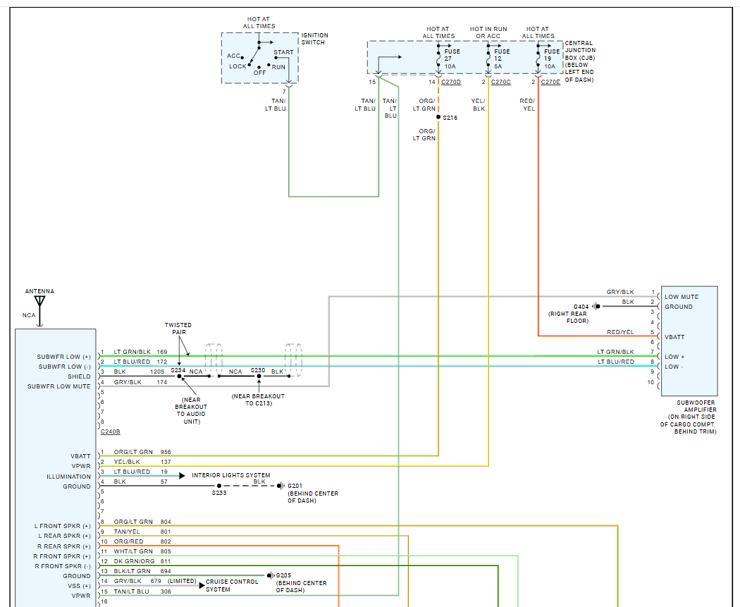

They make a wiring harness adapter for the radio for you car if you search amazon with the make of your radio. But if you want to match up the wiring hear are the wiring diagrams for the radio so you can do so. Check out the images (below). Please let us know what happens.
