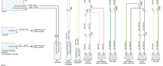

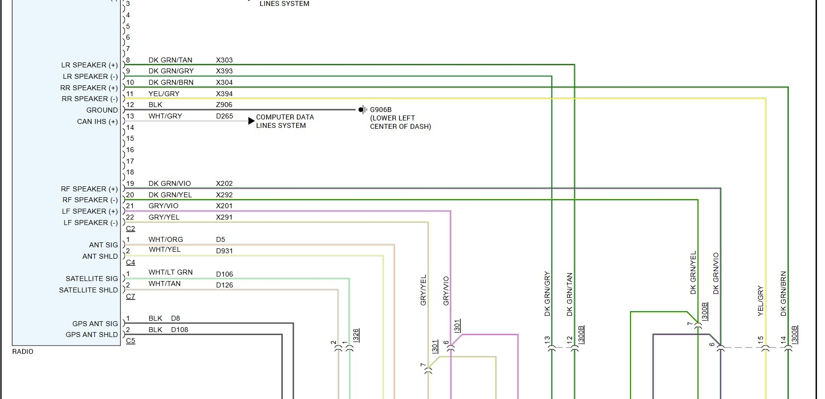

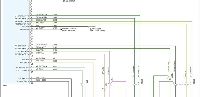

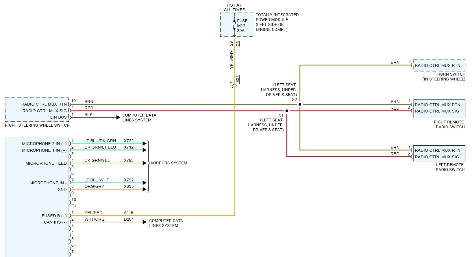

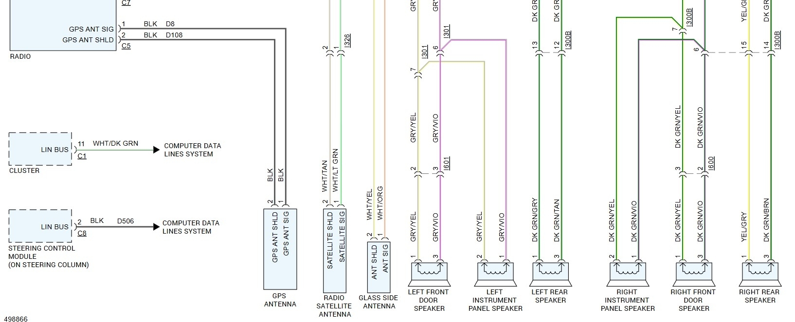

I’m looking for the diagram of the wiring for the radio of my vehicle listed above, it has the 6-speaker system with no sub.
Jul 26, 2025 at 10:15 AM
STEVE W.
Experienced Mechanic
15,399 POSTS
This is the diagram for the base 6 speaker system. The images overlap to make them legible.
