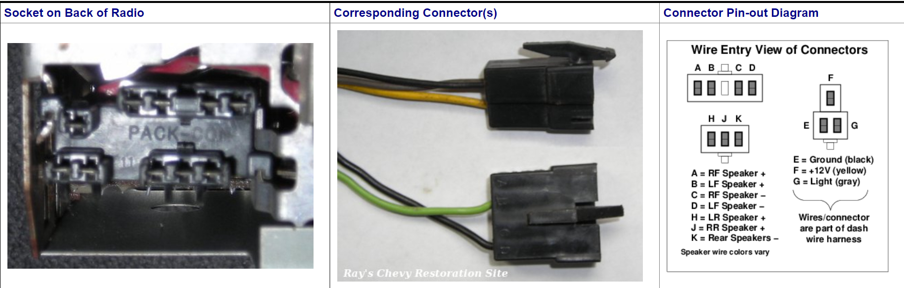

Do you by any chance have a color coded factory wiring diagram for my year truck?

Hello, we can look, but it might be tough with that year. Plus, we need a lot more information on the vehicle. It's a Chevrolet, but what model, what size engine, what sub-model, or if you can give us the VIN number, we can try to look it up from that. But definitely need to know more about the truck.
I see by your previous post it's a 2500, but can you give the engine size and if it's a K10, K20 series, or C10, C20, C30? As much extra info will help the search, and VIN if you don't mind giving us that.

It's a c20 with a 454.

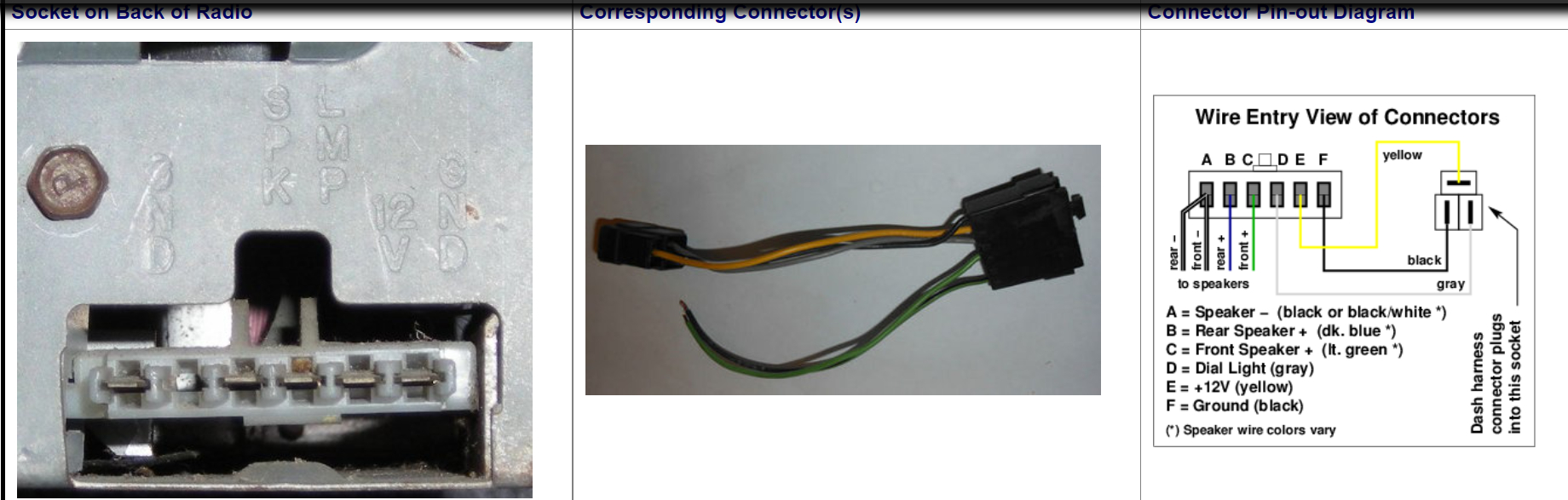

These were the only two diagrams I could find from that far back. Hopefully one of these looks like the wiring you have in your truck. I'm sorry I couldn't be more helpful, It's really tough to find diagrams going back so far.

Thank you. I spent hours trying to find this.
