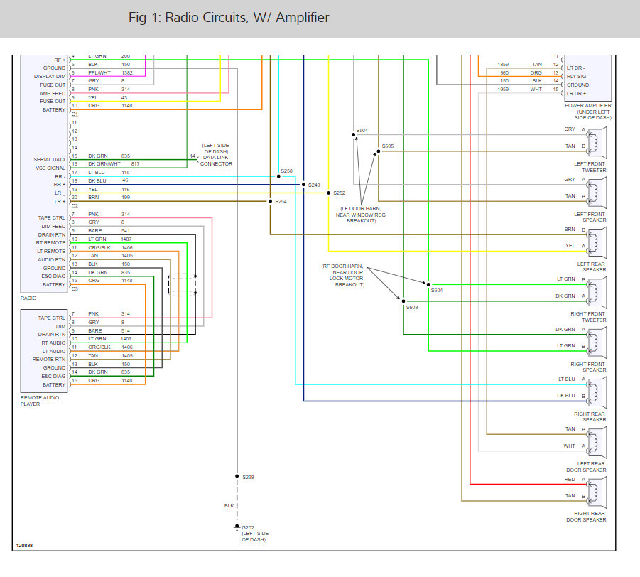

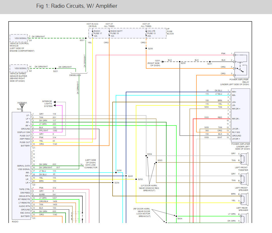

I took my factory radio out and i wanted to put it back in and when i tried it wouldn't turn back on and half of my lights on the dashboard wouldn't work i need a wiring diagram for it.

The picture. You can see some of the voltage circuits with this guide. (diagrams below)
