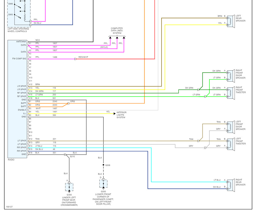

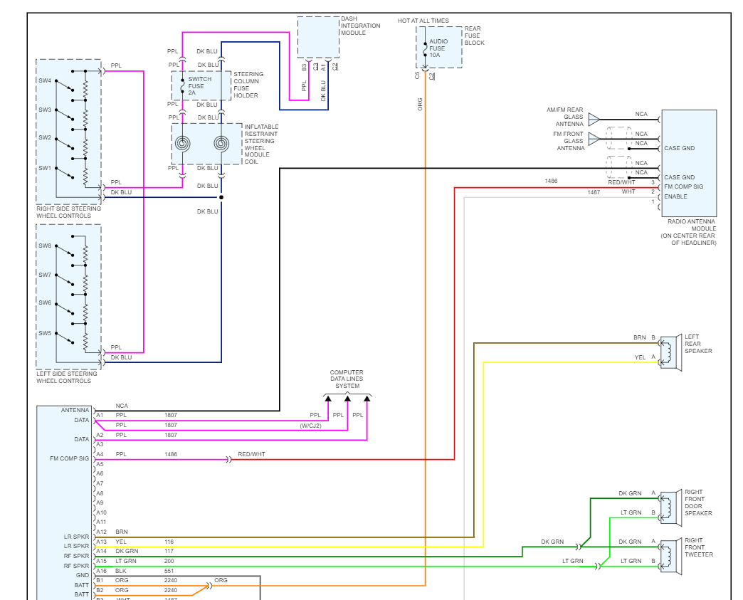

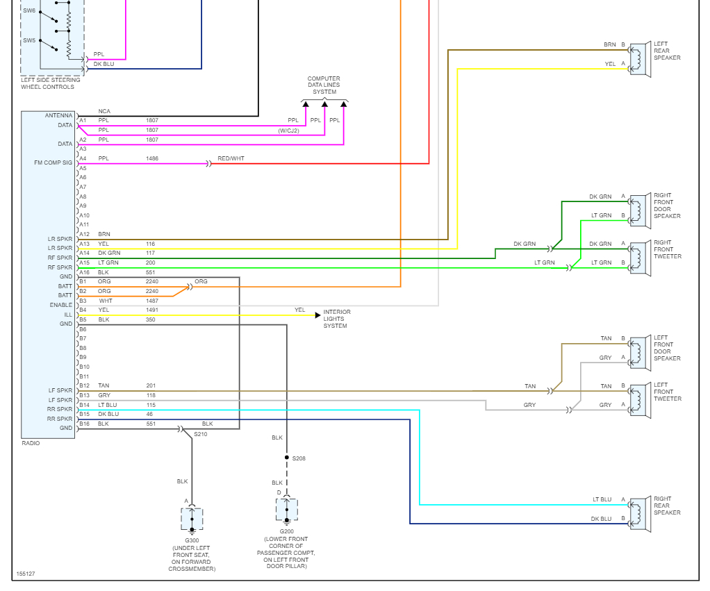

Need the color codes to the radio wiring.

Sure, here are the radio wiring diagrams and a guide to help you check the connections:
Check out the images (below). Please let us know if you need anything else to get the problem fixed.
