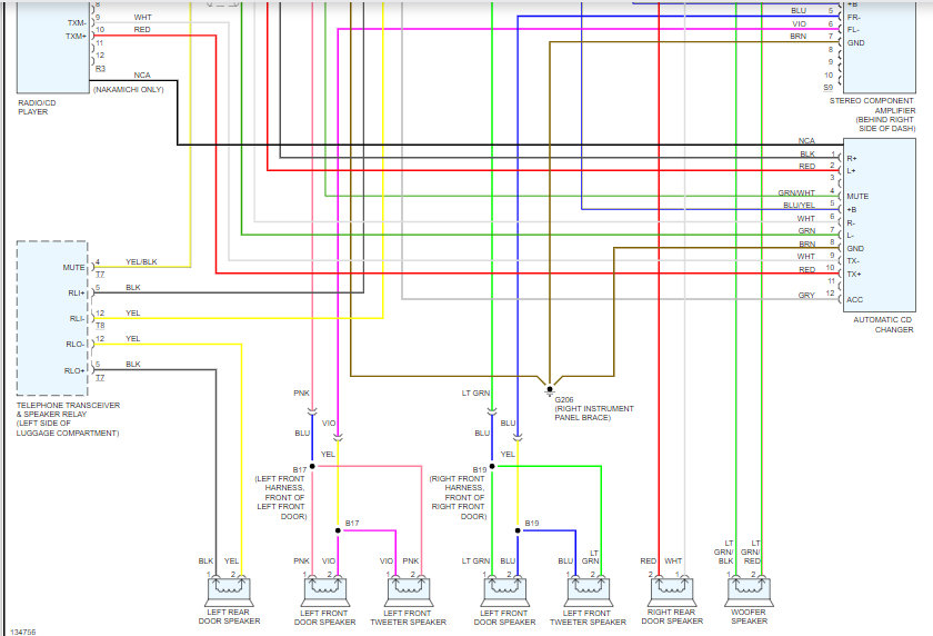

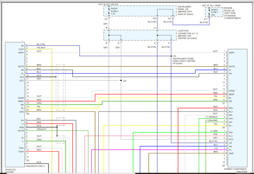

Car keeps popping a fuse to the radio. Want to follow the wire and check for any grounding issues.
Jan 7, 2021 at 5:14 AM
DANNY L
Experienced Mechanic
5,648 POSTS
Hello, I'm Danny.
Here is the information you requested. Here is a tutorial for you to view on how to test electrical wiring:
I've attached the radio wiring diagram below for your car. I've cut the picture in half so you can view larger. Hope this helps and thanks for using 2CarPros.
