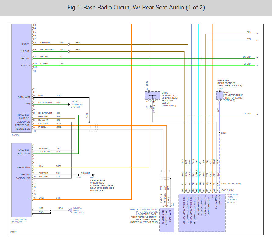

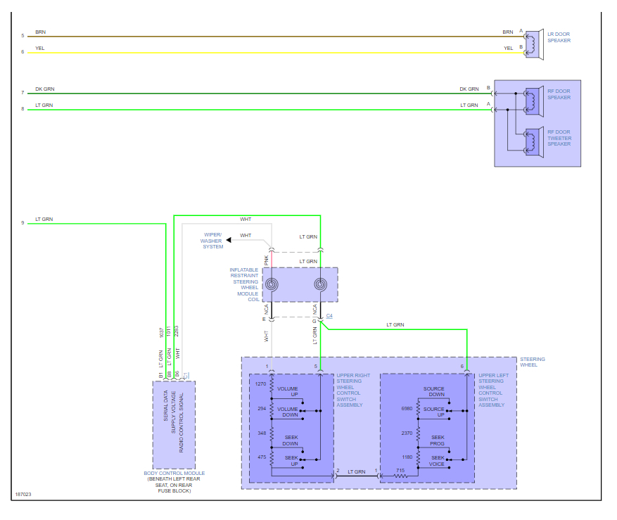

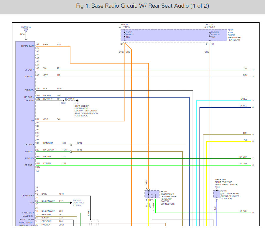

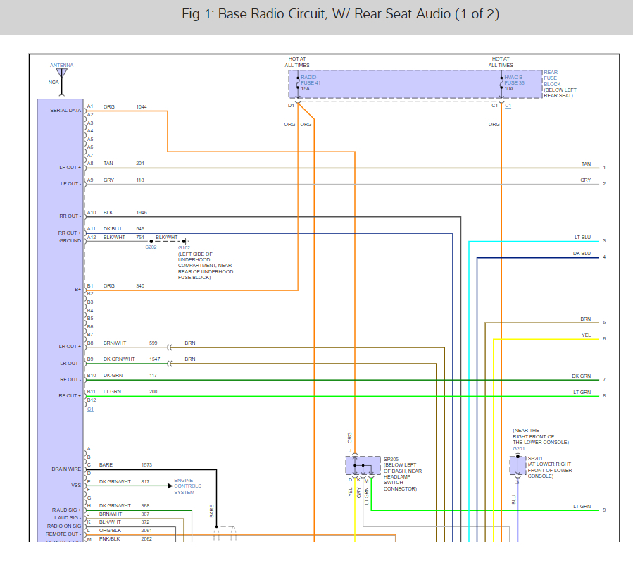

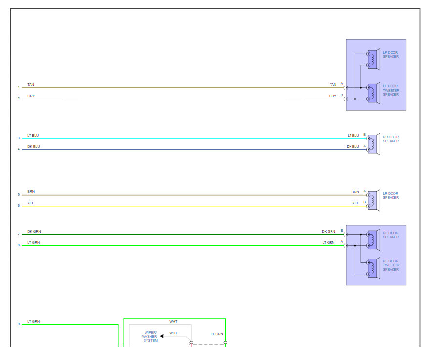

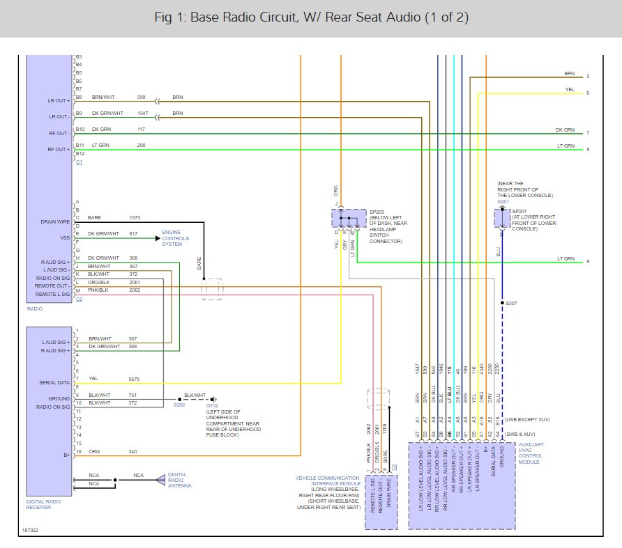

Stereo diagram color codes for the vehicle listed above LS model.

Sure, here are the radio wiring diagram and a guide to help check the connections:
Check out the images (below). Please let us know if you need anything else to get the problem fixed.
