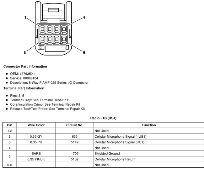

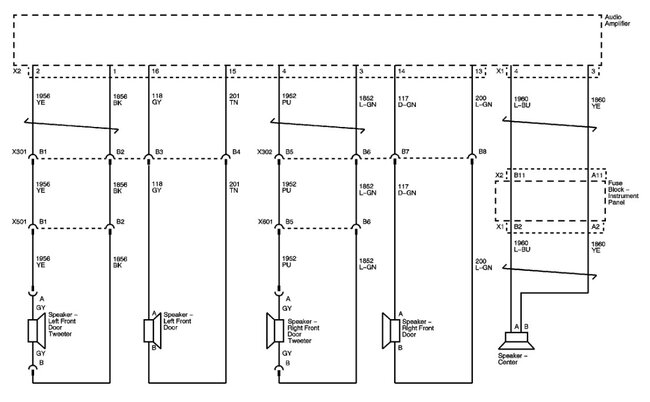

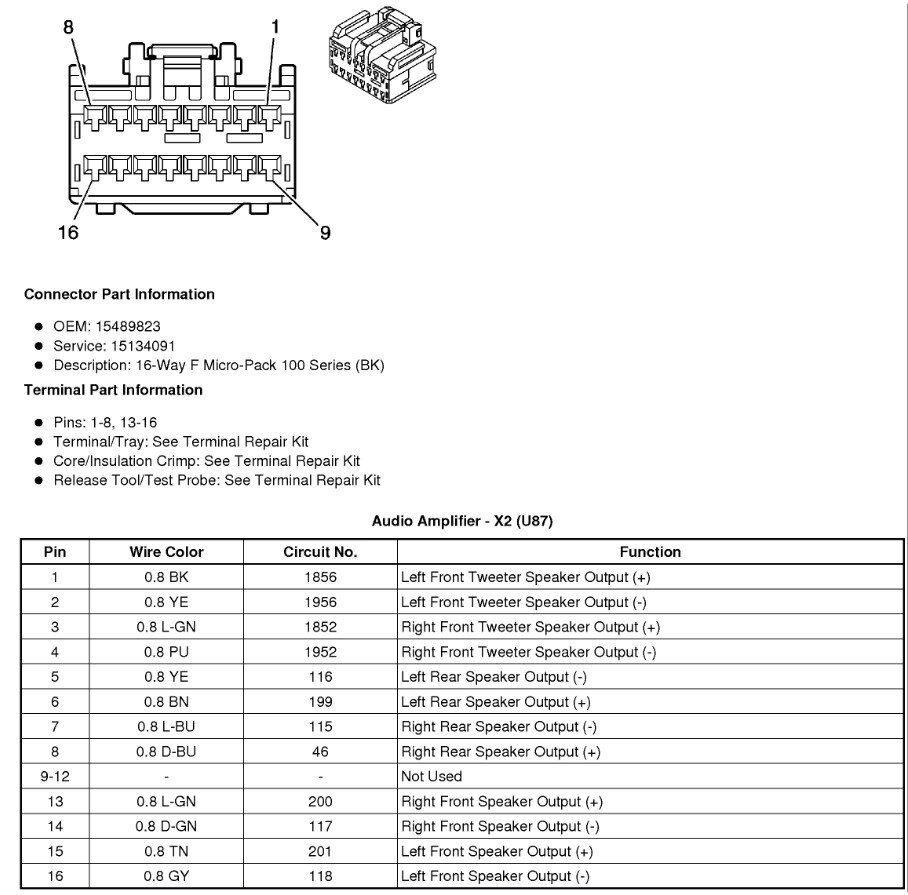

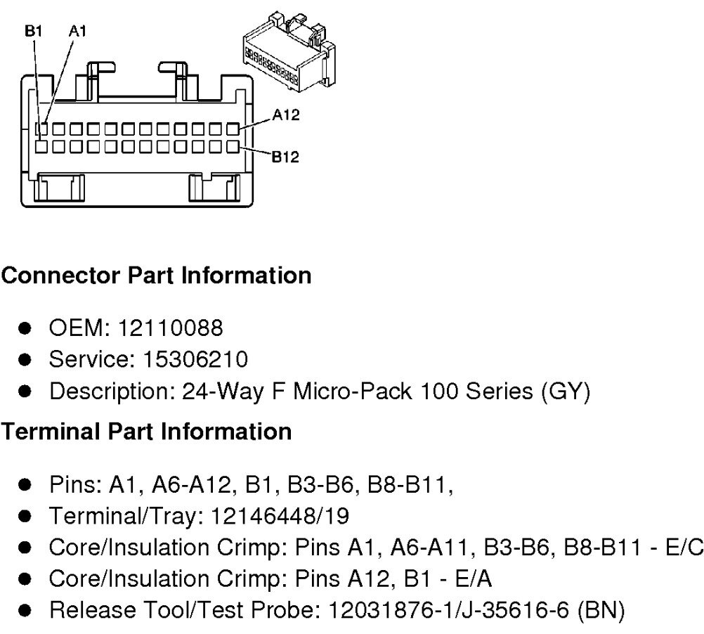

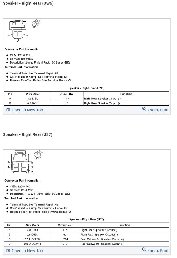

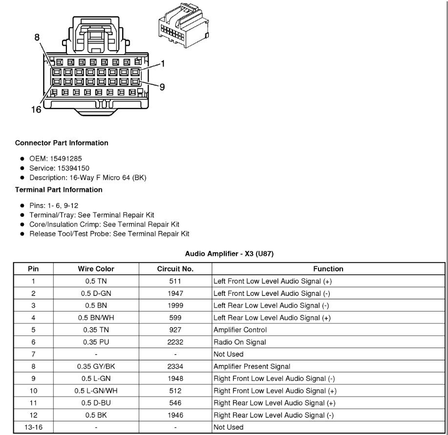

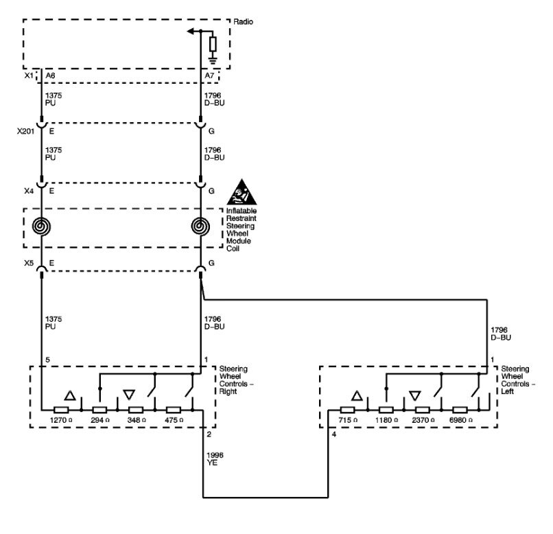

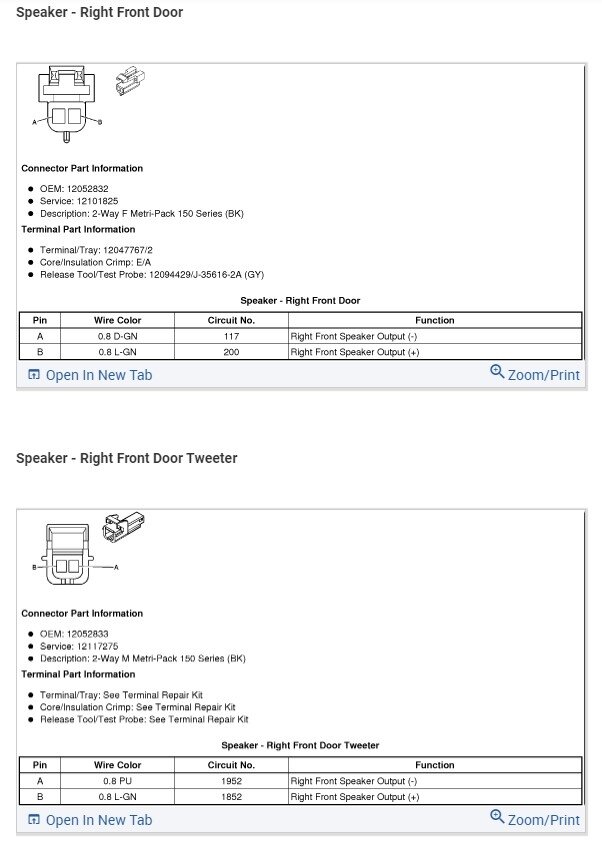

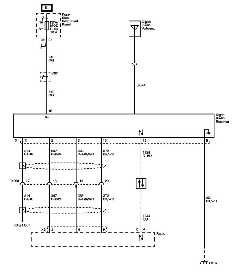

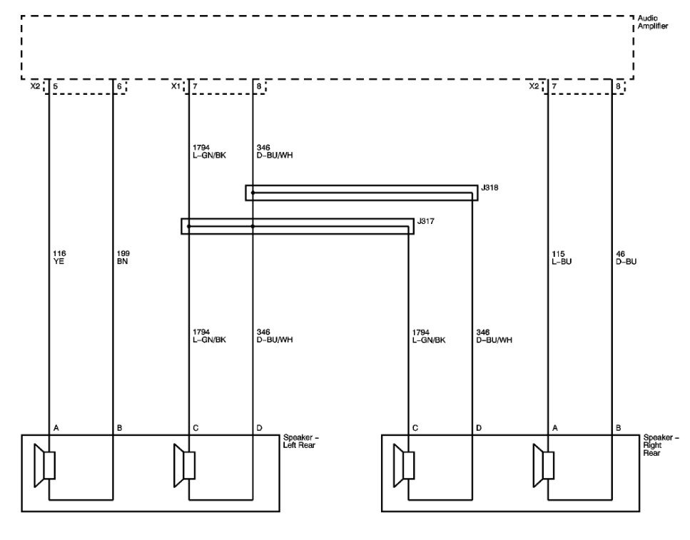

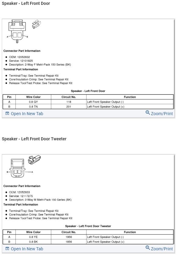

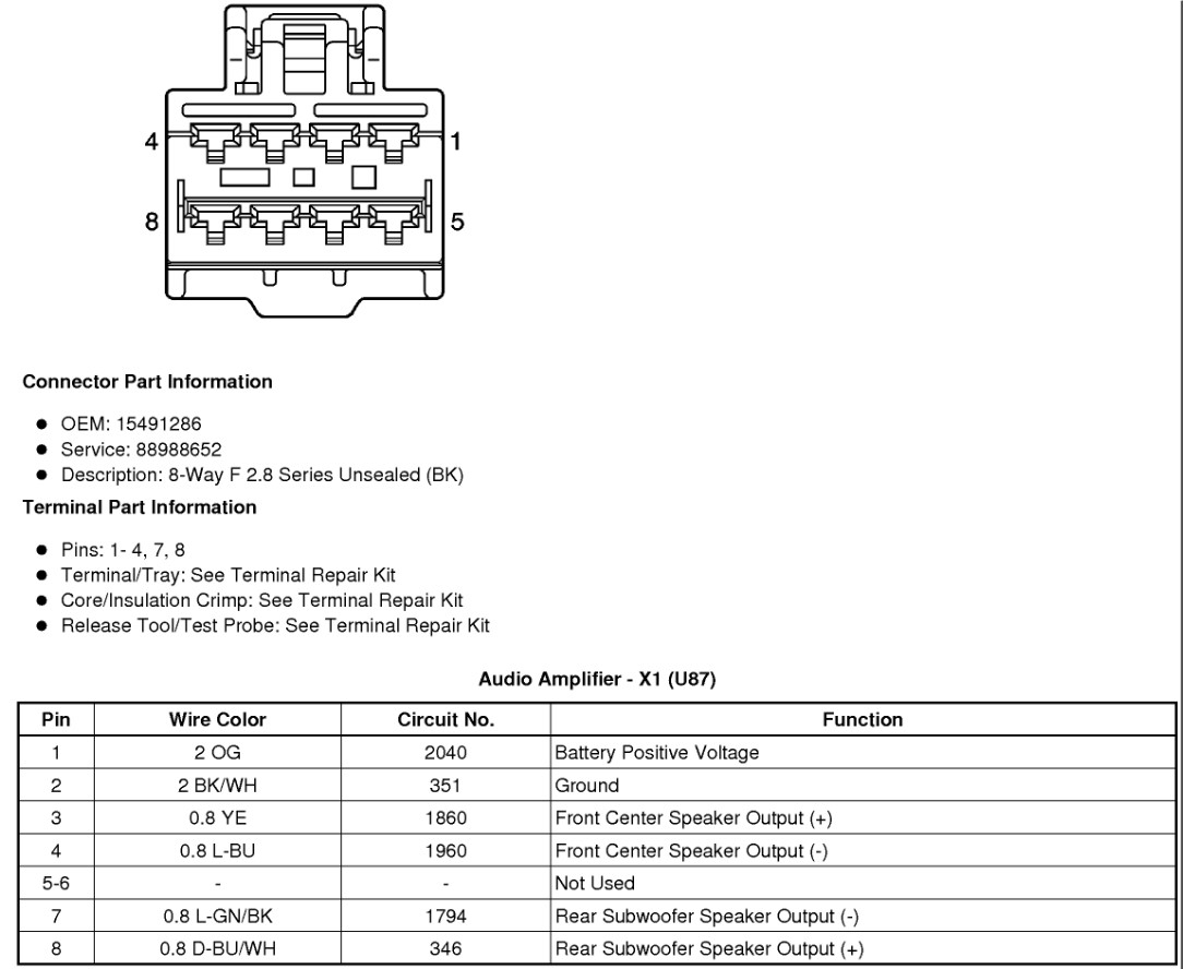

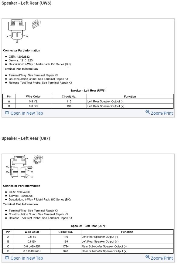

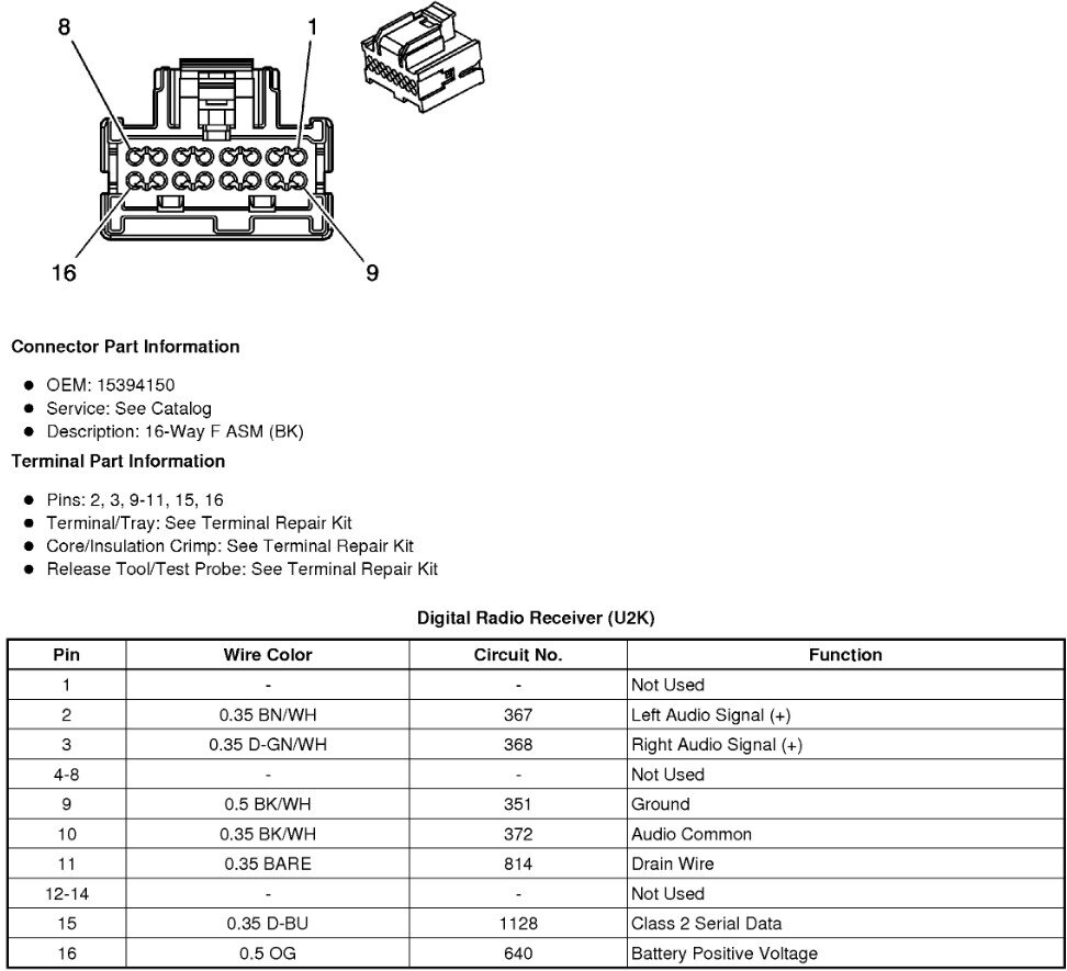

I need a wire diagram for my car stereo (stock). I have the car listed above with the Denso DNNS008 (GM 15263106) Stereo CD DVD Navigation radio. My search online for a schematic has been unsuccessful so far. Hoping you might be able to help.

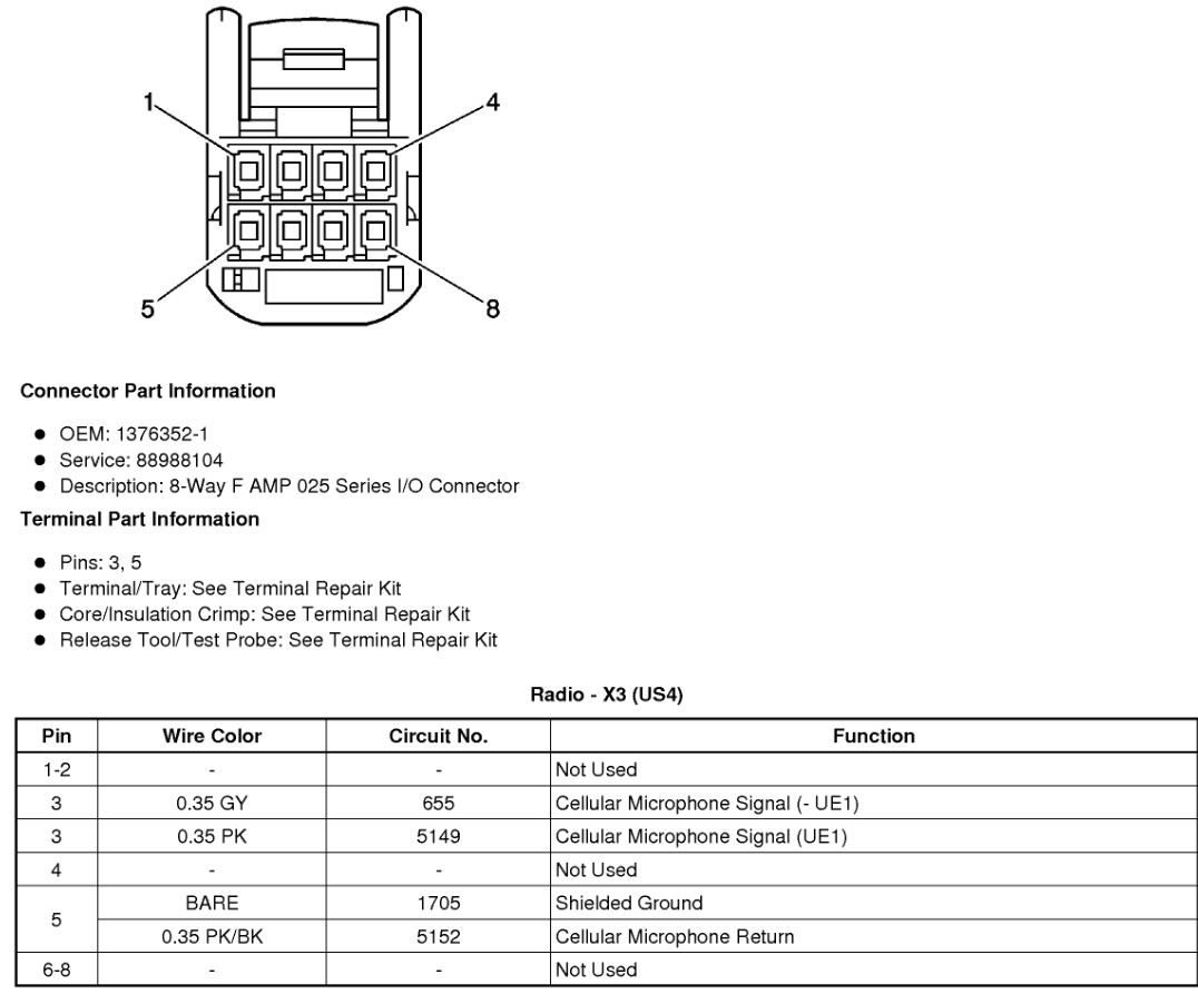

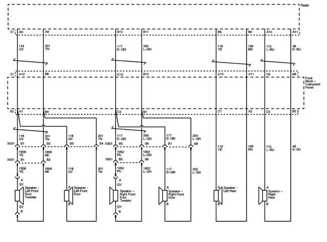

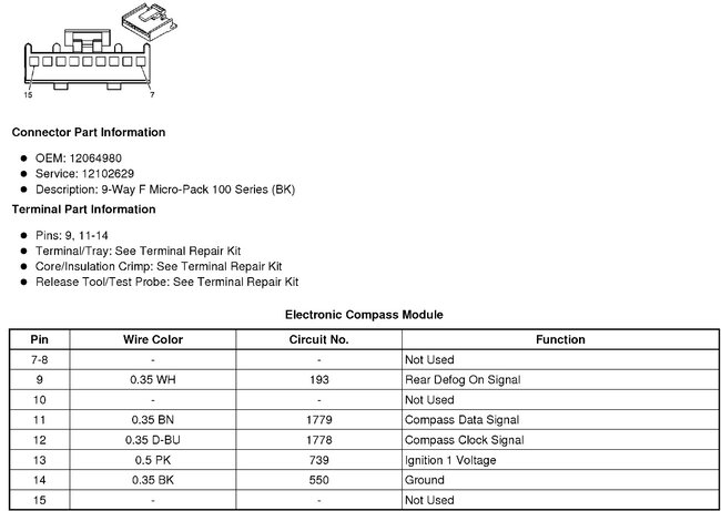

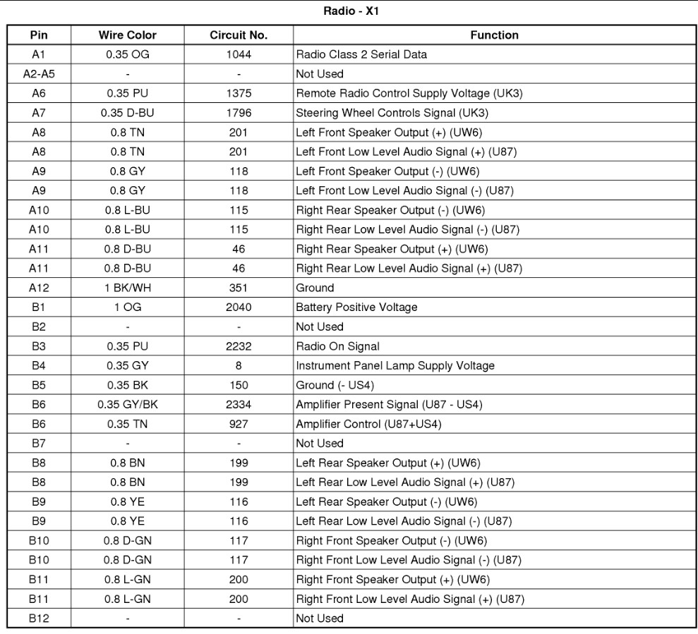

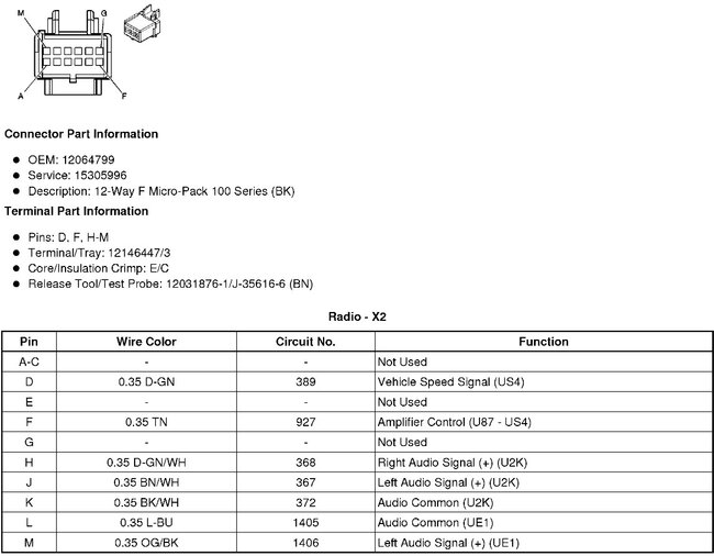

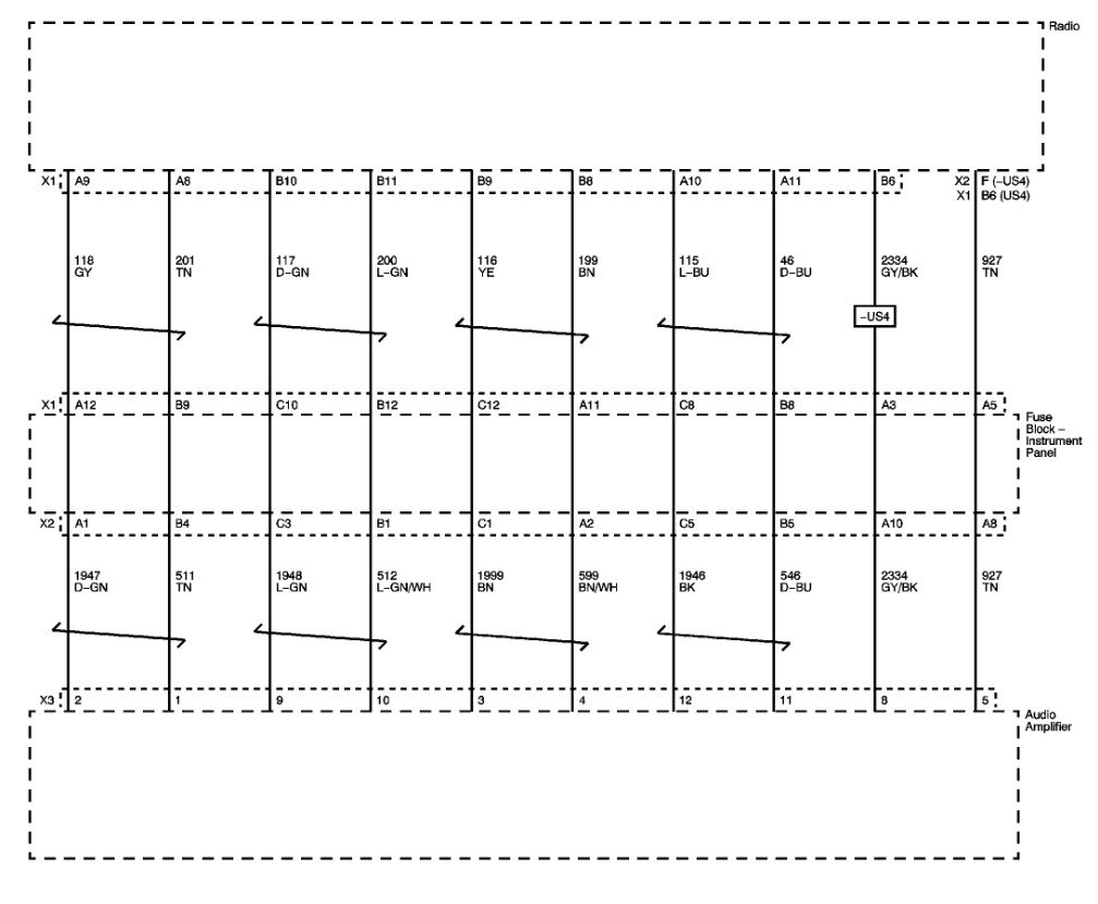

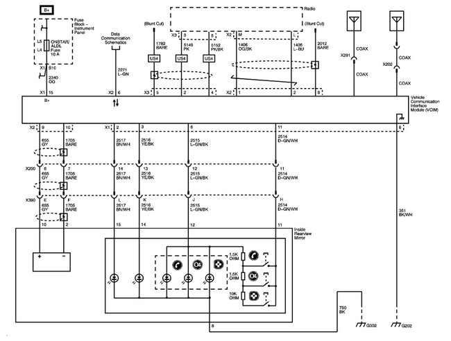

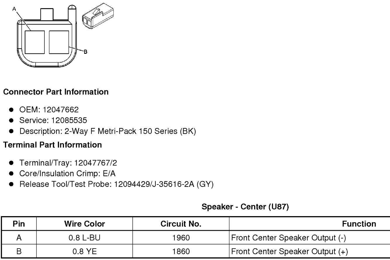

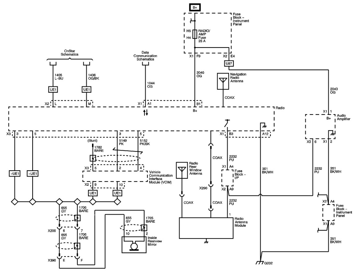

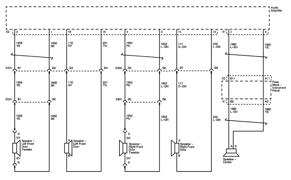

Here are the OE diagrams for the radios, on star, amp, and controls. The other images are the connectors and pin outs for them. These should cover the vehicles' sound system and nav system connections. If you have other questions about the system just ask.

Awesome! Thank you so much. These are just what I needed to sort out my wiring. 2CarPros save the day again. Thank you, it is much appreciated.
BTW - You wouldn't happen to have the radio wiring schematics for a 1997 Toyota 4Runner Limited V6 Automatic 4WD by any chance? I am actually trying to install the Denso system into the Toyota.

You must like challenges. One thing you are going to encounter is that the system uses serial data from the vehicle to stay unlocked and operational. Without that signal it will likely lock up and stop working because of the radio's internal anti-theft system. That is why they pop up for sale now and then but never seem to sell, they are VIN locked. I would test the entire unit on the bench before you install it. Good luck. As for the other schematic, we likely do but you would need to ask it as a new question as we try to keep topics separate.
