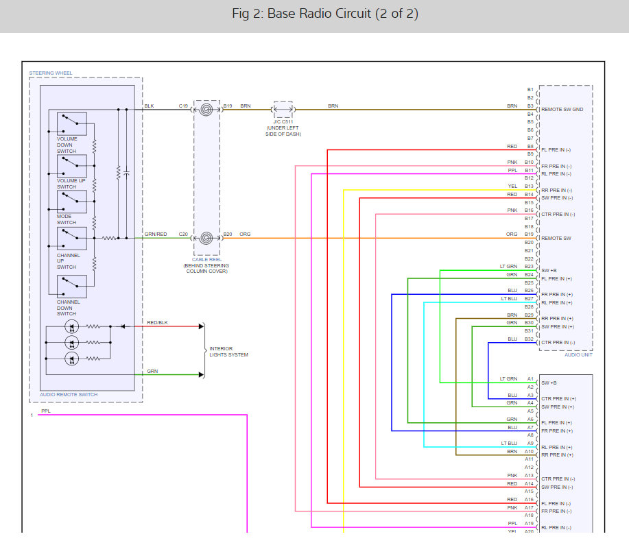

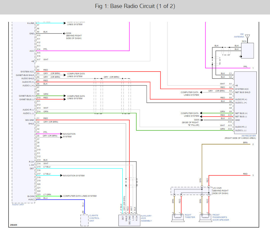

Usually when a specific component doesn't work there is a circuit issue or the component itself.
Has the battery been jumped or any accessories been added? Replacing the battery will put the radio into a security mode requesting a code to regain any functionality. Any aftermarket components installed like a dvd player, blue tooth, radio, etc....?
If the fuses are good (there is more than one) and the circuits to the radio and time good then its the radio and compass/time units that are bad.
This guide will help you check for power at the fuses and the grounds for the system. The wiring diagrams below will show you how the system works.
and
If everything check out the head unit is bad. Check out the diagrams (Below). Please run this test and get back to us.

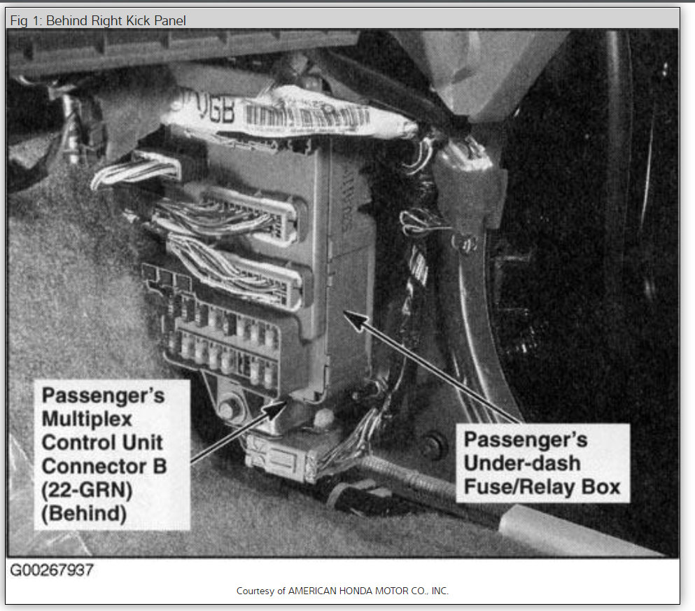

When wires are left hanging afte being cut, they would cause shorting when the bare ends of powered wires contacts with any body parts or grounds. Use wire tapes to cover them up individually to prevent shorting.

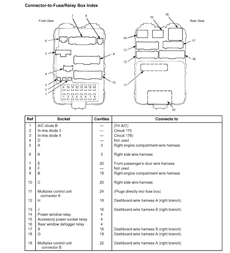

Check fuse # 9 ( 15 A ) in passenger underdash fuse box. It is for the accessory power socket relay.

There is an accessory relay that is out and not working but to be sure here is a guide and the location of the relay to help you get the problem fixed.

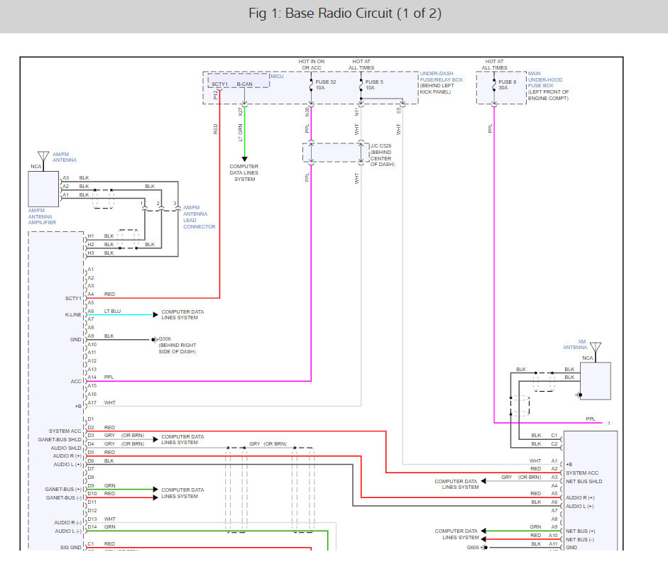

Check the following fuses. Did you use a test lamp to test the fuses?
Underhood fuse is # 47 and # 48.
Driver's underdash fuses are # 6, # 8 and # 9.
Passenger fuse # 9.

Did you check Fuse number 9 in passenger under-dash fuse box?
An accessory power relay in the same fuse-box provides power to the radio and navigation system.

Really appreciate this thread and the experts! My 2003 MDX had radio out and center dash screen completely out. Everything else worked. Eventually I found cigarette lighter socket also didn’t work. Started methodically checking fuses and read this thread. My culprit was fuse #9 on passenger side under glove compartment. Thank you all for contributing and allowing for folks to fix things themselves!
