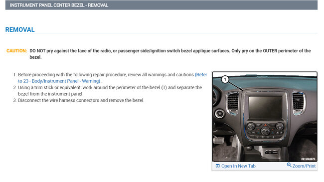

Can I replace just the radio volume control knob?
2018 DODGE DURANGO
60,000 MILES • 3.6L • V6 • 4WD • AUTOMATIC
RPC101
Without replacing the whole panel?
Sep 12, 2023 at 4:31 AM
  • 55,402 POSTS

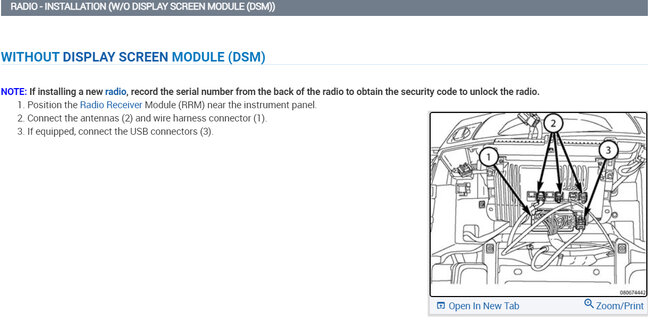

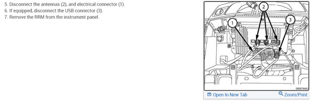

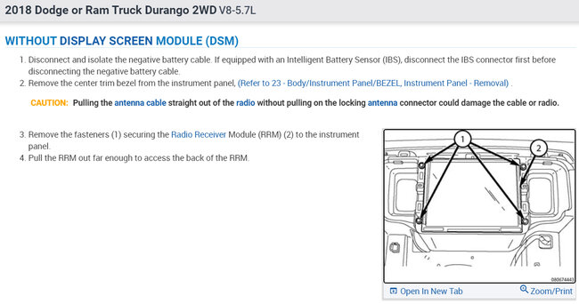

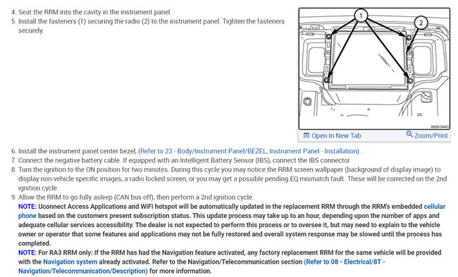

Not really, you can if you remove the radio and send it in for repair or look on eBay they have them for about $50.00. Here is how to remove the radio. Check out the images (below). Please let us know if you need anything else to get the problem fixed.
