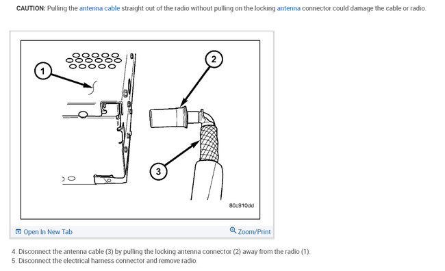

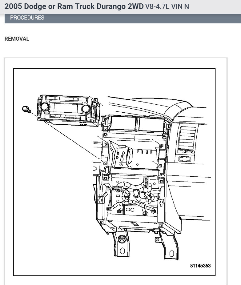

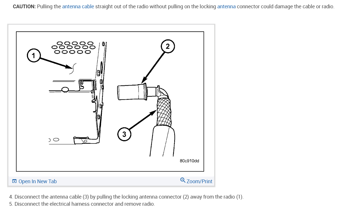

Have a durango, with infinity stereo and need to pull the radio not sure if it can be taken from the front by pulling off the front panel or from the bottom could u please advise how to remove or get to the radio, thank you very much
Mar 3, 2009 at 12:08 AM
JDL
  • 16,098 POSTS
Here is the instructions on how to remove the radio int he diagrams below but I did include a video of the job being done in a similar car which the process is the same.
https://youtu.be/p_13d9FzsF0

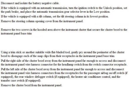

how does dash disassemble for access to radio?
Jul 31, 2019 at 6:02 PM (Merged)
BLUELIGHTNIN6
  • 16,542 POSTS
https://images.2carpros.com/forum/automotive_pictures/261618_Noname_1723.jpg
