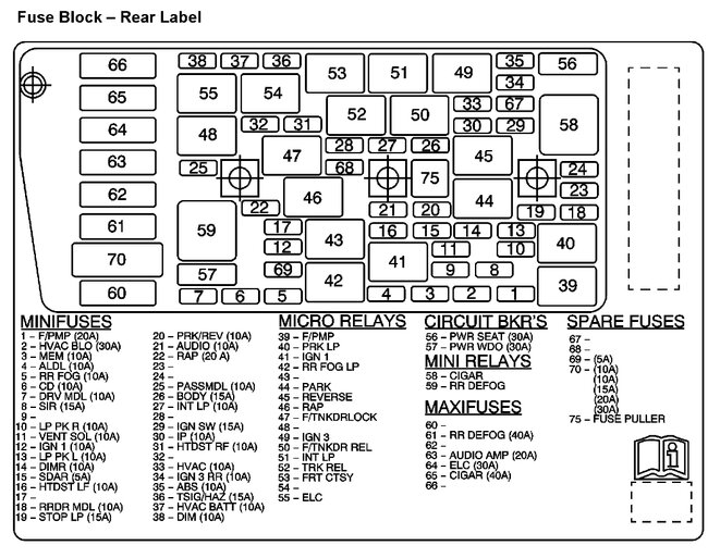

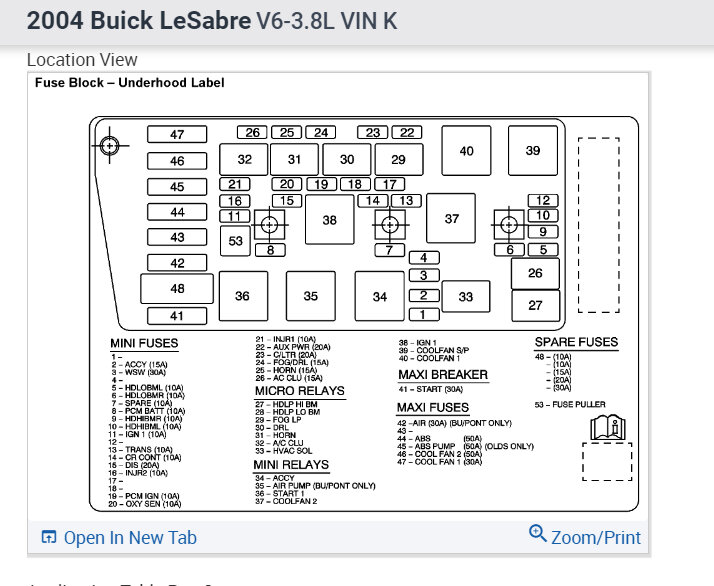

We should check the fuses first here is a guide to help and the fuse locations are in the diagrams below. Please check the fuses with the key on.

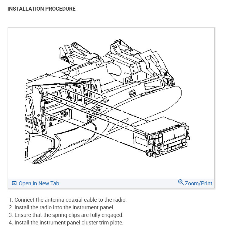

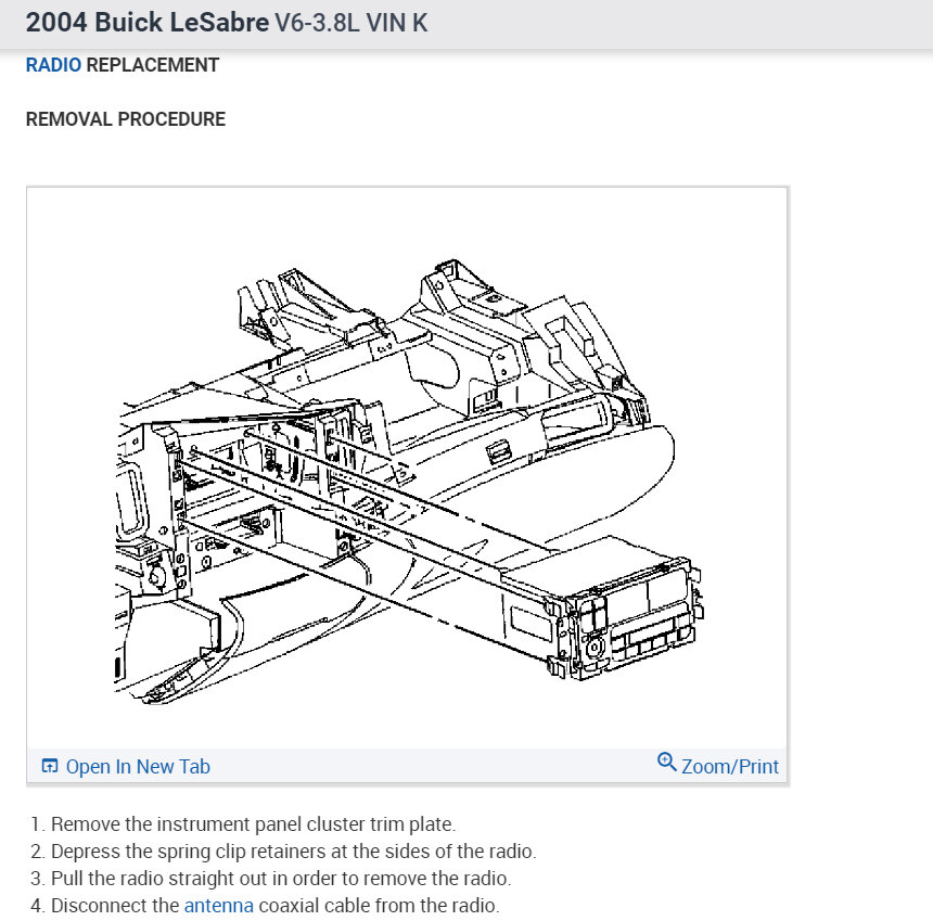

This happens when the amplifier inside the radio goes out here is how to remove it so you can send it in for repair. You can find a service that does this by searching google or eBay.
