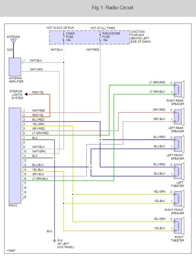

Volume not working with radio, works with C D player.
Jul 12, 2017 at 2:45 AM
  • 55,402 POSTS
It sounds like one of the data buses inside the radio has gone out but to be sure here is a wiring diagram (below) so you can the power and grounds. Here is a guide to help you get the job done:

Thanks I will give it a try on my next day off, maybe time for a new one.
