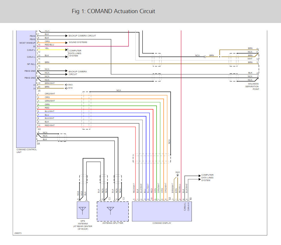

Hello, I have a 2008 S550, here is the problem. my sound system has a constant clicking noise or popping when using the Radio, When using the phone I can hear the caller, they can not hear me. and my Sirius/XM will not pick up or go to preview channels. My embrace cannot locate the car and when I press the (i) button nothing happens. when I try to go to the audio menu it will not stay on what I select it jumps in and out of that screen.

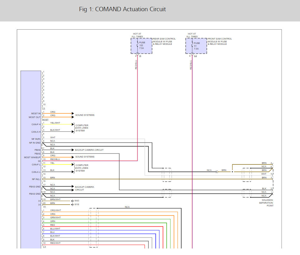

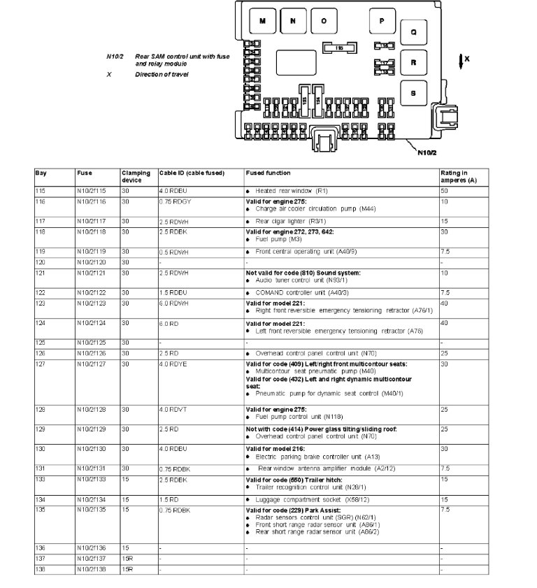

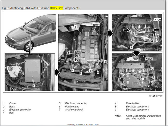

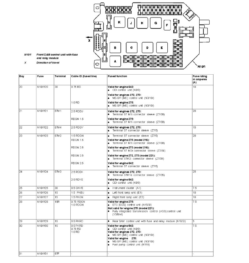

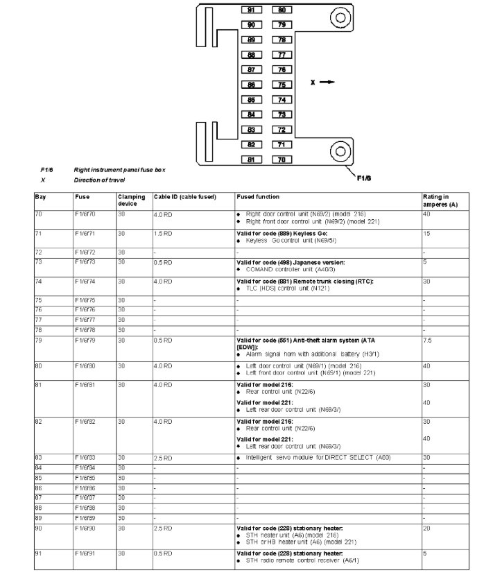

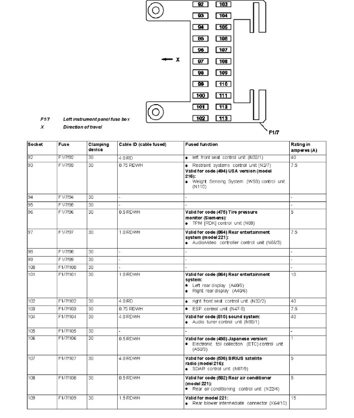

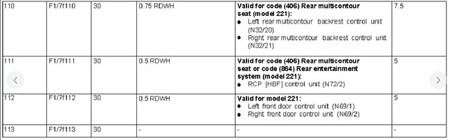

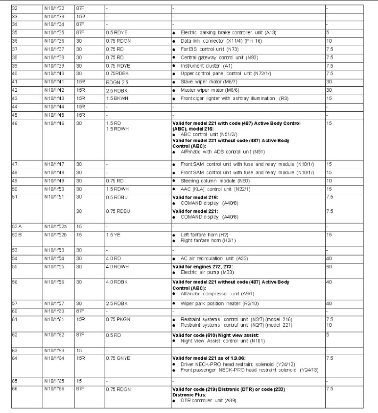

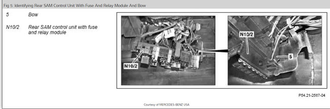

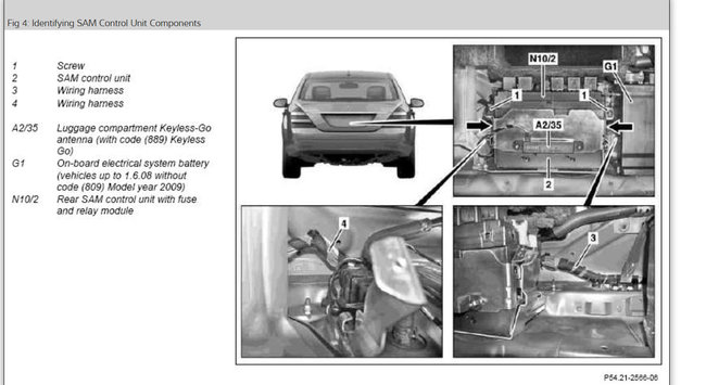

It sounds like you have a command controller that is out or fuse # 122 in the rear SAM or #51 in the front SAM. Here is a guide to help you check and the fuse box locations as well as the wiring diagrams so you can see how the command system works:
