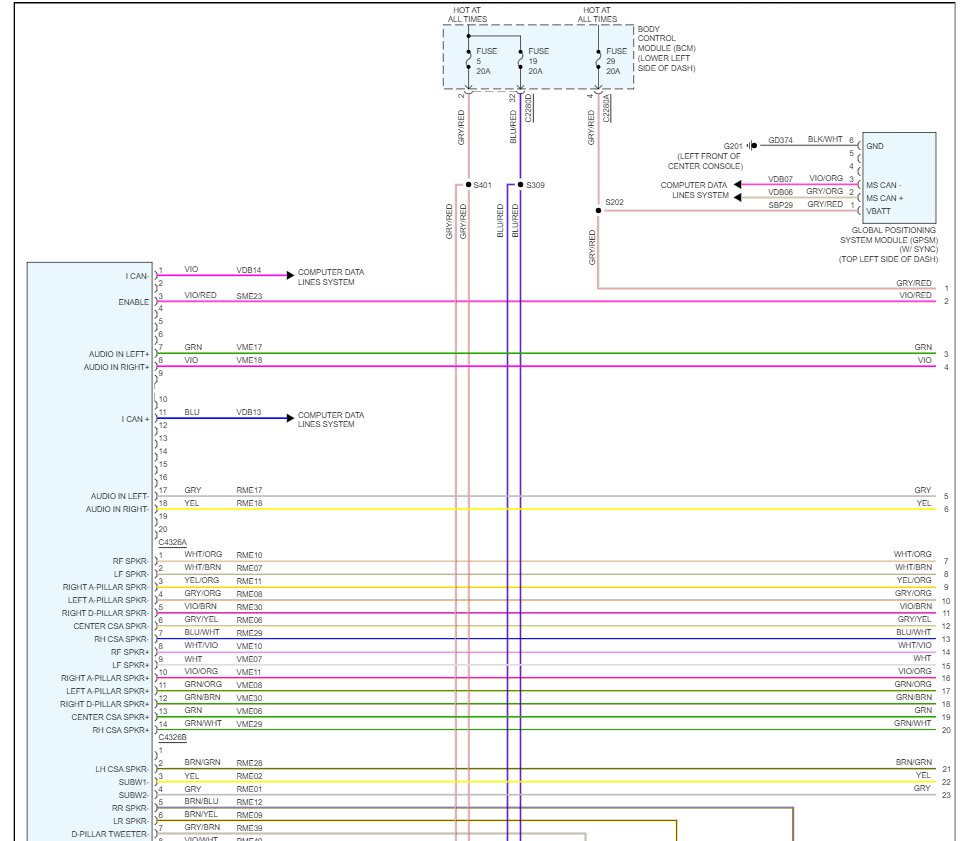

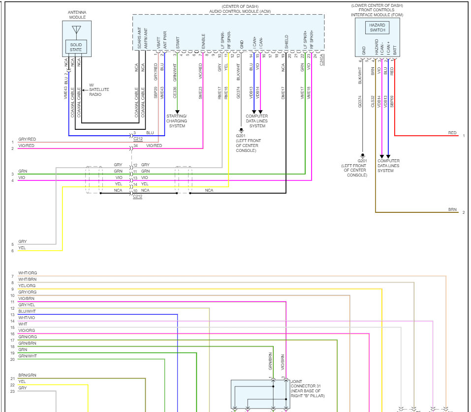

The radio/CD player turns on and off randomly as you drive down the road. Sometimes it happens more frequently than other times. Recently the radio has been turning on after shutting off and sitting in parking lot or garage.
Nov 5, 2023 at 2:34 AM
  • 55,797 POSTS

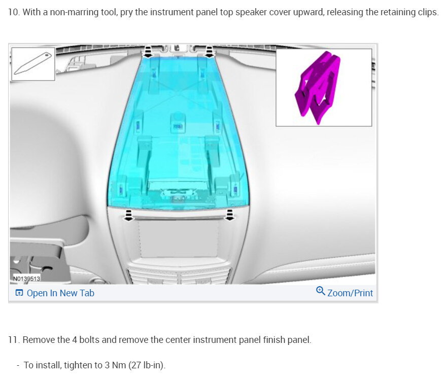

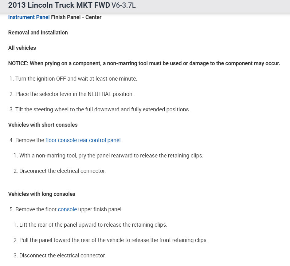

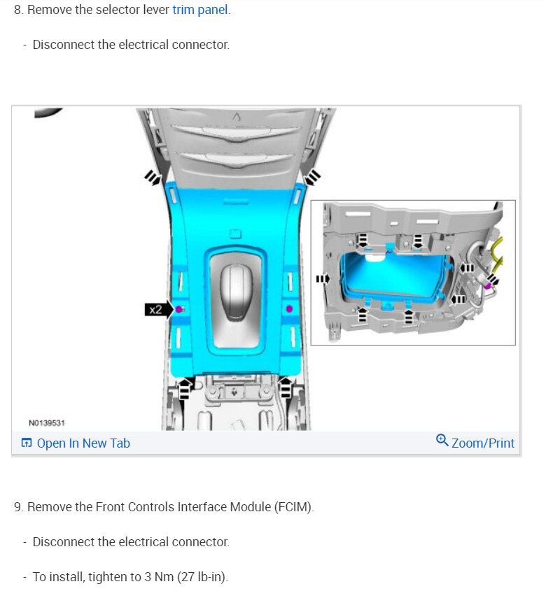

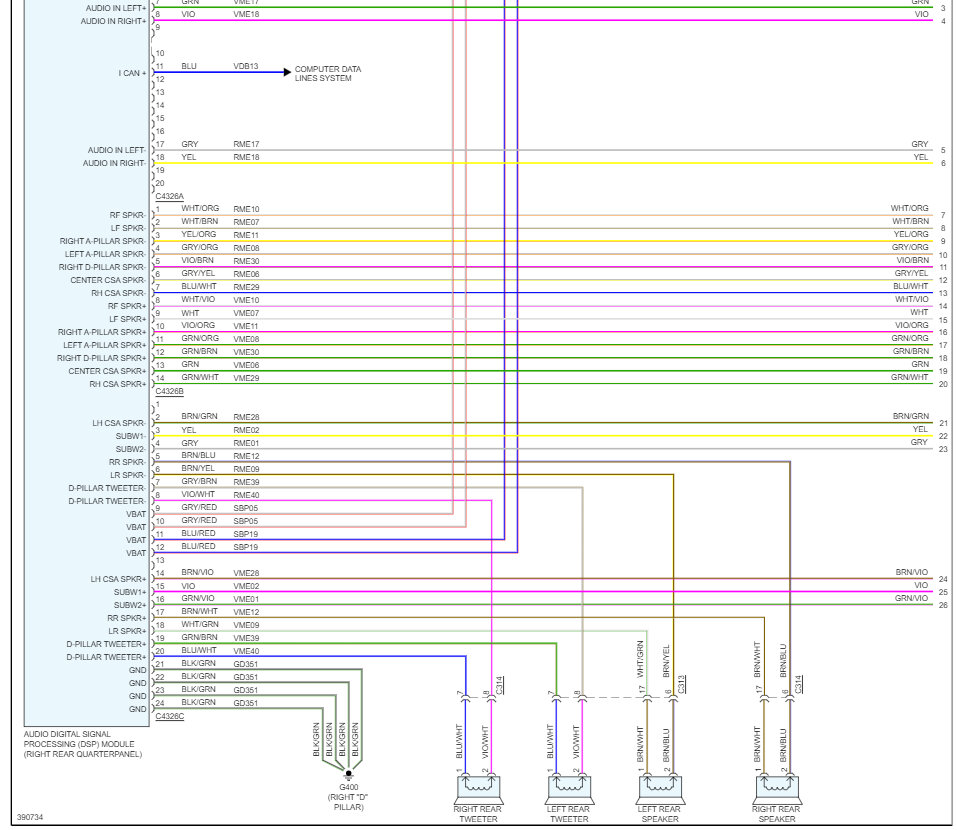

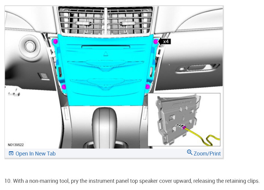

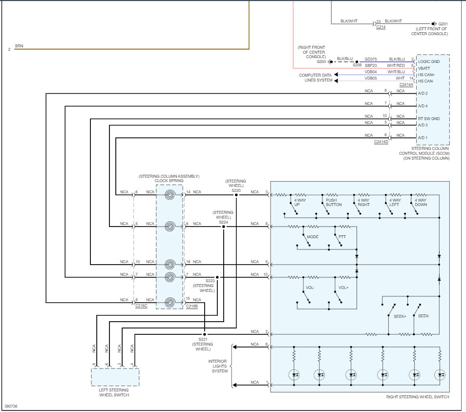

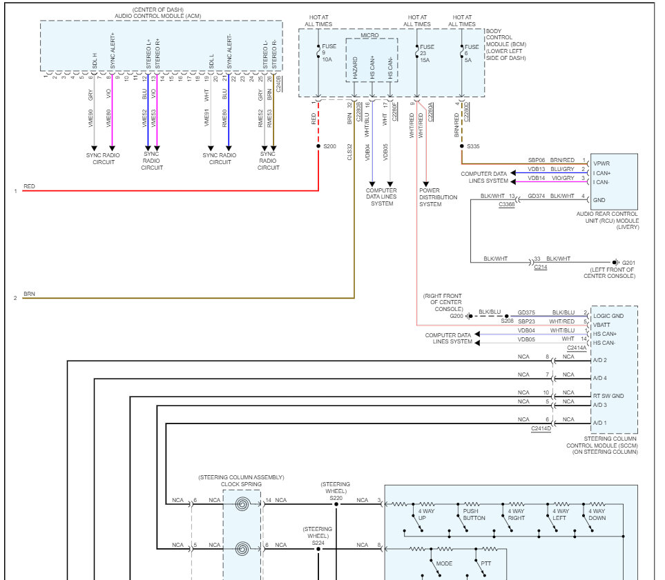

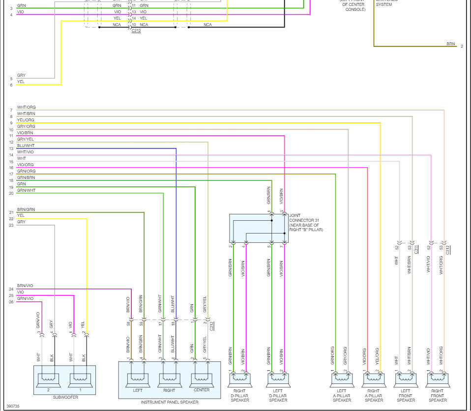

The radio power is supplied by the BCM which could be going out but if the fuses at the BCM have power while the radio is not working the radio is bad. Here is a guide to help you check for power and the radio wiring diagrams so you can see how the system works and which fuses to check for power when the radio is not working.

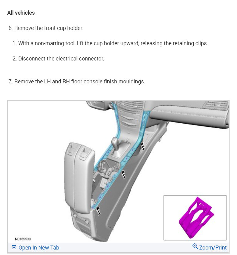

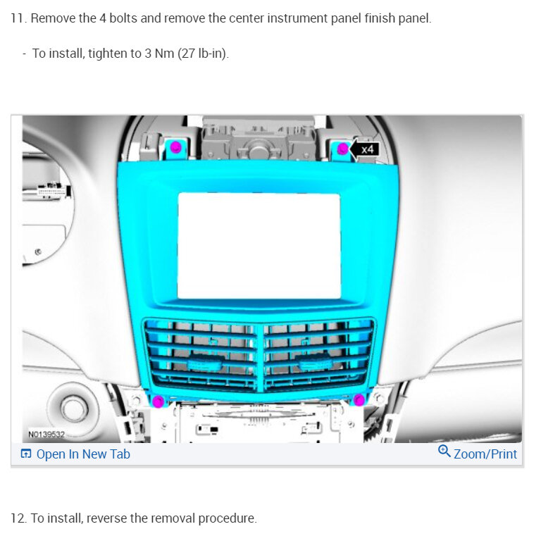

Here is how to change the radio out as well. Check out the images (below). Please let us know how it goes.
