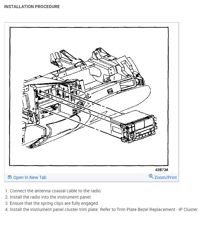

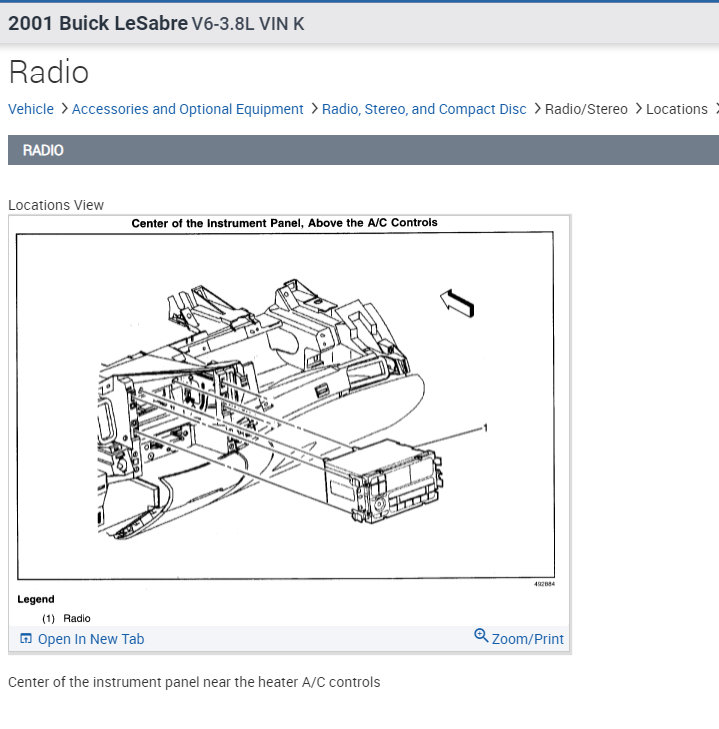

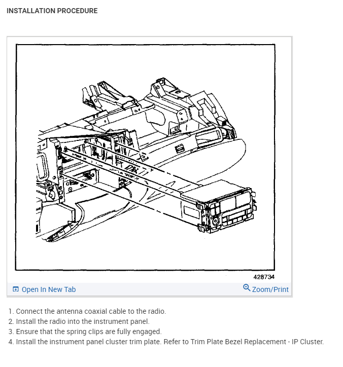

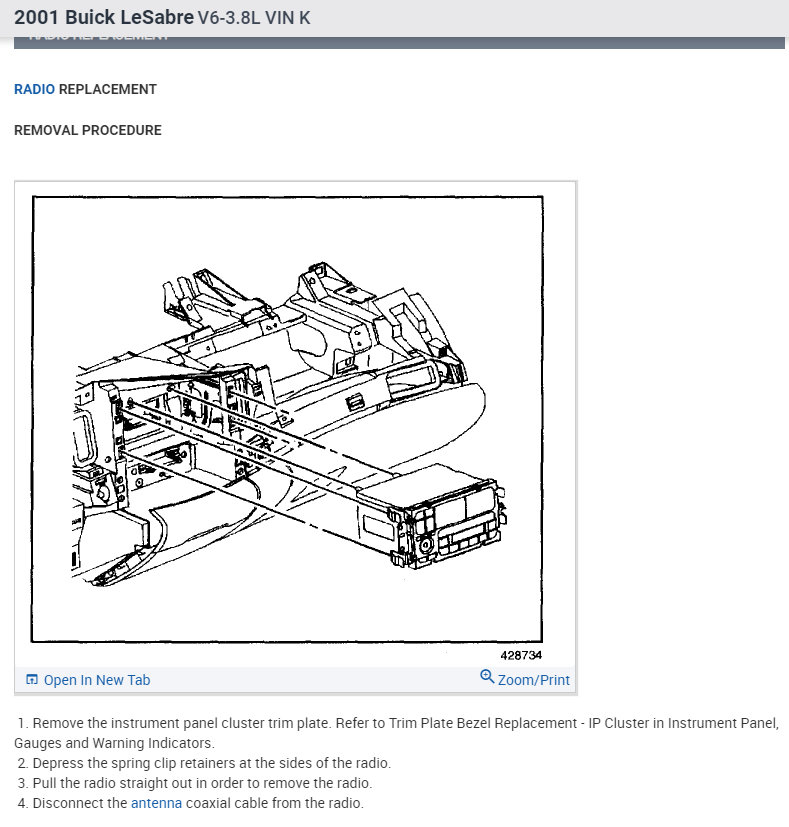

Depending on the trim level or option packages, those both had used the same radio head unit.
Do both of them visually look the same?
I have attached replacement diagram below.
