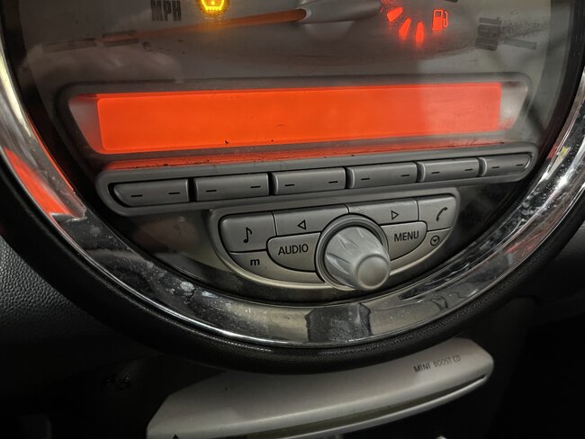

Radio stopped working?
2009 MINI CABRIOLET
104,000 MILES • 4 CYL • TURBO • 2WD • MANUAL
BHAMDOC1973
  • 2,007 POSTS
Checked fuses on passenger side and they are okay.
The back light is still there and the radio and sound work but you can't see a thing on the display.
Oct 21, 2022 at 3:13 AM
MIKE H R
  • 3,094 POSTS
Does the radio work at all? Check the wires going into the radio to make sure they are tightly connected. I have had it where a wire was loose one time and after I got it to make a god connection the radio worked well
If you need more help we are here.
Mike
Oct 21, 2022 at 6:57 AM
BHAMDOC1973
  • 2,007 POSTS
Yes, radio and sound work, but nothing shows on the display, am going to assume removing the radio is pain, but can you share some instructions?
Oct 21, 2022 at 7:11 AM
MIKE H R
  • 3,094 POSTS
You need to remove the dash cover to get to the radio, but first check all the fuse to see if one is loose, When you get the dash cover off {usually just held on with clips} check the ground wire.
Oct 21, 2022 at 7:46 AM
BHAMDOC1973
  • 2,007 POSTS
I checked and all fuses i see are on passenger side. All were good
Oct 21, 2022 at 7:48 AM
MIKE H R
  • 3,094 POSTS
Remove the screws on the side. Pull the center console and side trim loose, then pull gently trim. Remove the two screws on the sides of the head unit, then pull the head unit out. Disconnect the wiring harness and pull out the fuse. Some models have a fuse behind the radio. If all the fuses are good, you might have a defective radio. Stereo problems are difficult to diagnose, especially on the Mini Cooper where the stereo system is so heavily integrated into the computer.
