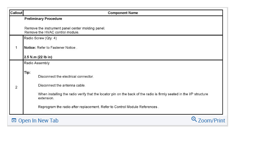

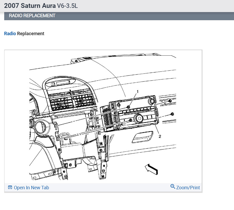

The radio won't turn on. There are no blinker sounds either. But every once in a while the radio will just come on out of nowhere. Seems like some kind of short. Could it be a bad radio maybe? The fuse is fine.
Sep 16, 2022 at 6:47 AM
  • 55,433 POSTS
Yep, what happens is the amplifier inside the radio startts to go out this is why it pops on all of the sudden, you can get a used radio from a used parts house or check ebay, they have a bunch of used ones. here is how you can remove the radio in the images below. Please let us know if you need anything else to get the problem fixed.
