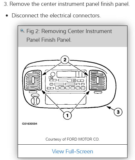

My radio in my truck stopped working and I'm looking for a replacement. What type of radios are compatible with the make and year for example sometimes an Explorer radio is compatible with a different make of Ford. Also, I'd like to go Bluetooth if possible, what do i need for that as well?

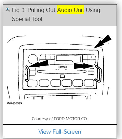

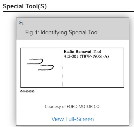

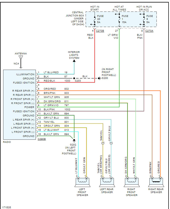

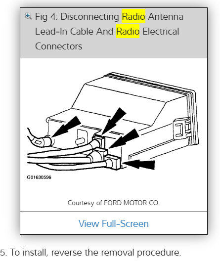

Here is how to remove and replace the radio in case you need it. You will need the special wire tools to remove the radio which I have shown in the images below. Also, I have included the radio wiring diagrams as well so you can see how the system works. Check out the images (below). Let us know if you need anything else.
