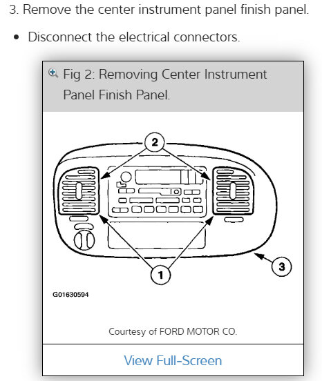

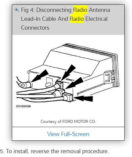

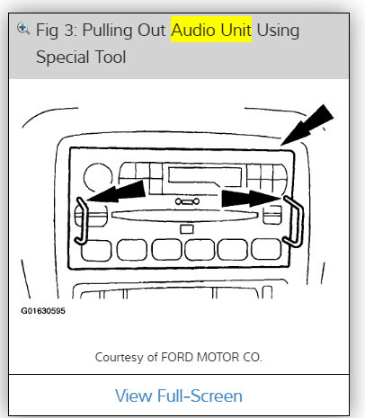

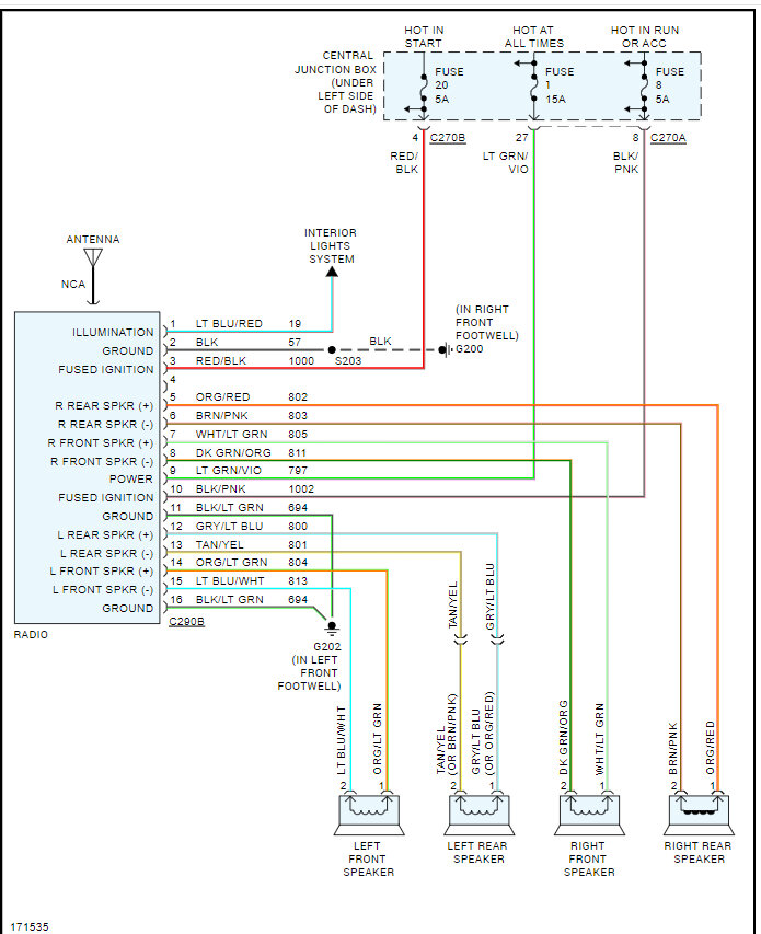

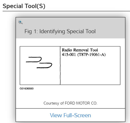

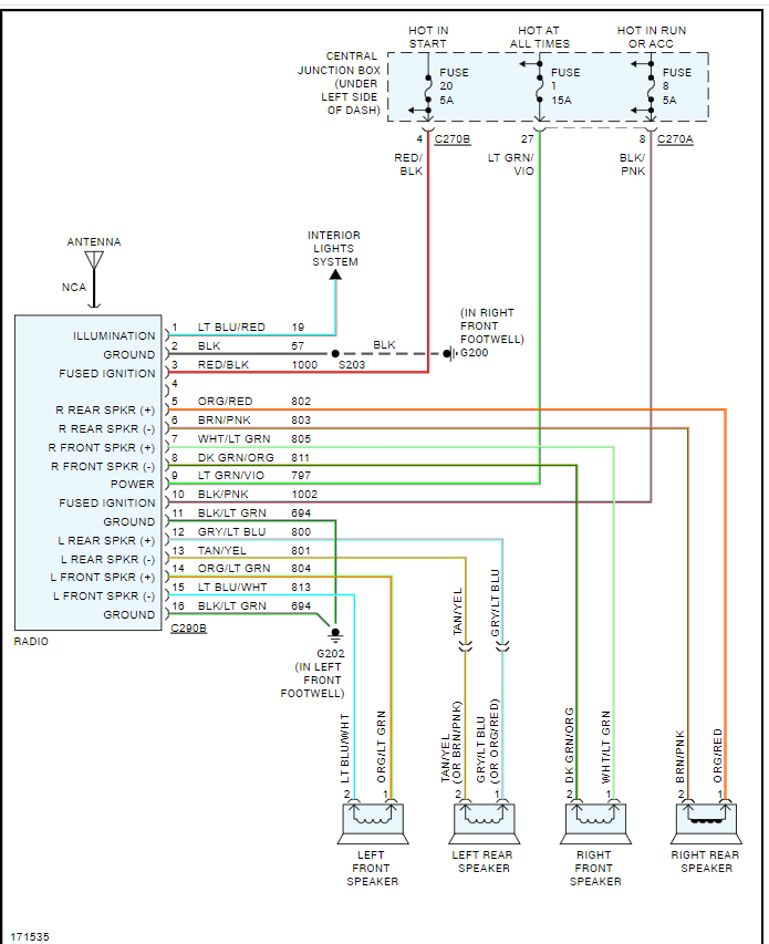

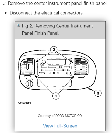

Here is how to remove and replace the radio in case you need it. You will need the special wire tools to remove the radio which I have shown in the images below. Also, I have included the radio wiring diagrams as well so you can see how the system works. Check out the images (below). Let us know if you need anything else.

Which radios can i use? like which ones are compatible and have the same plug in and can i just get anyone at Walmart or something?

Dash Kits for Installation: You can find dash kits that are compatible with 2003 Ford F-150, allowing for the installation of either single-DIN or double-DIN after-market radios.
