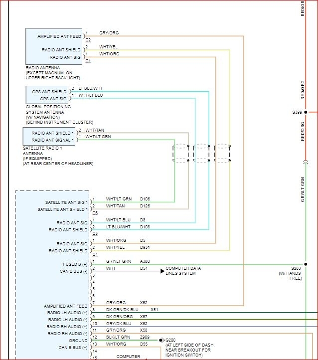

There are three inputs on the back of the radio; yellow, white and blue.
Which color is the radio antenna, Sirius etc.
May 11, 2019 at 3:16 AM
Hi Jim,
Looks like the yellow is your Radio Antenna, Blue is the GPS, and White is the SAT radio.
Here is this portion of the wiring diagram. Please let me know if you need more info or I can help in another way. Thanks
