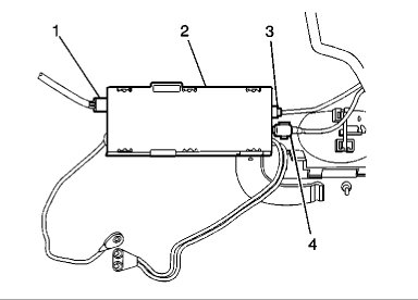

Where does the windshield antenna connect? I see it plugged in the back of the radio but I don't know where and how it connects to the windshield.
Jun 20, 2017 at 9:41 AM
STEVE W.
  • 15,295 POSTS
It runs up the a pillar to an antenna module behind the headliner near the rear window. That module connects the front and rear antennas and amplifies the signal.
The module is powered through the trunk release fuse.

I'm back working on the radio. I removed the front dash grill and to my surprise there are no Center or side speakers and they were never there. The only speakers in front are in the side window columns and they are tweeters but there is no sound coming out of them. MY Cadillac CTS, 2003 is the base model. Could it be that the other models only have the front speakers and working side tweeters?
Also I cannot find the module that connects the front and rear antennas.
Jul 19, 2017 at 1:14 AM
STEVE W.
  • 15,295 POSTS
The antenna module is behind the headliner at the rear.
