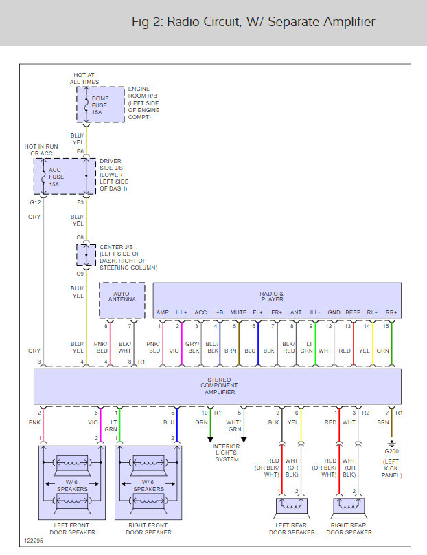

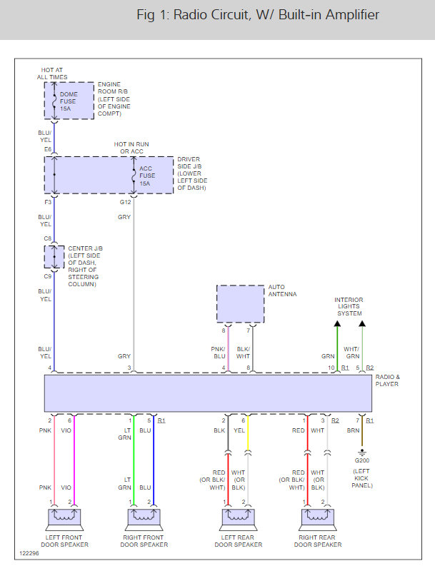

The radio does not come on at all. I checked both fuse boxes and all look good. I read on here that there is suppose to be a 10 amp fuse on back of radio, next to power plug, so I pulled the radio only to find no fuse anywhere. Please help. Thank you.
Oct 17, 2018 at 6:08 AM
  • 55,423 POSTS
It sounds like the head unit is no good, but to be sure let's check for power and the unit grounds. Here is a guide and the wiring diagrams so you can see how the system works:
Jun 2, 2020 at 5:25 AM
JROBERT13
Thank you very much for taking the time to help me. Yes, the head unit was bad. I ended up finding another 1999 4-runner radio at nearby salvage yard, replaced mine and everything is working great again.
