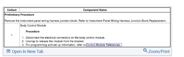

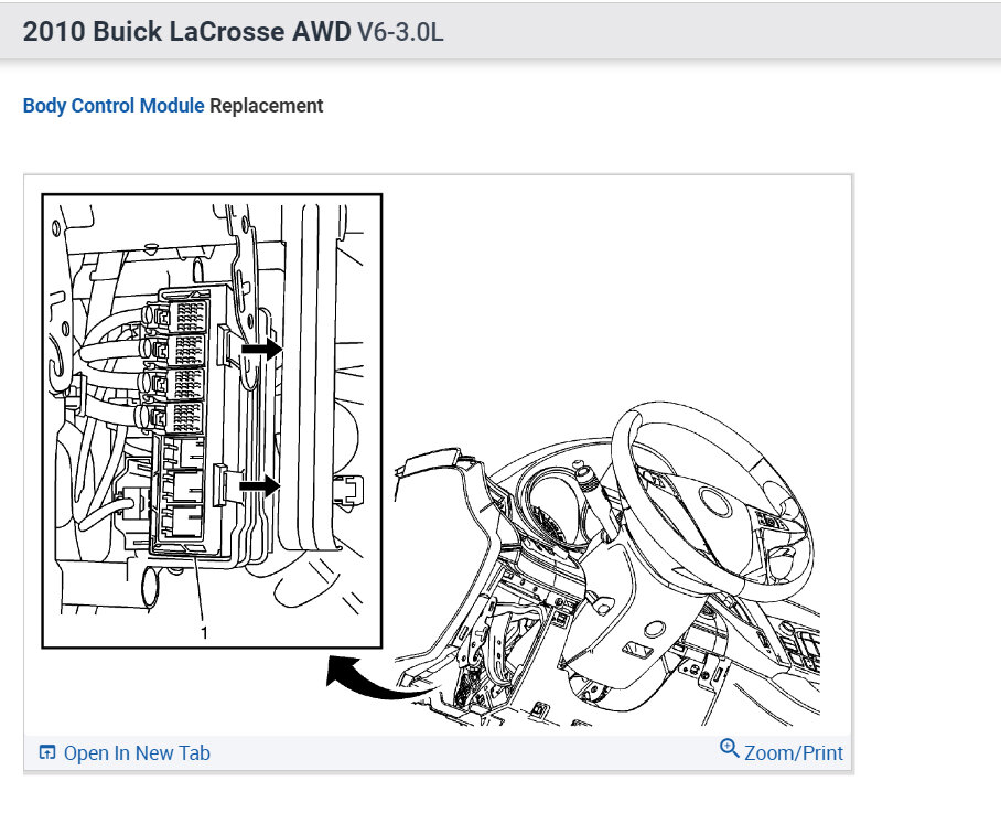

Yes, the BCM is responsible for the operation of the radio, but to be sure the BCM is bad we should do a CAN scan. You can get a CAN scanner (Controller Area Network) which will work on most cars from Amazon.
https://youtu.be/u-4syLc-ifQ
and
Here is the location of the BCM and how to replace it in the images below. You can get a preprogrammed unit by searching Google or Ebay. Check out the images (below). Please let us know if you need anything else to get the problem fixed.
