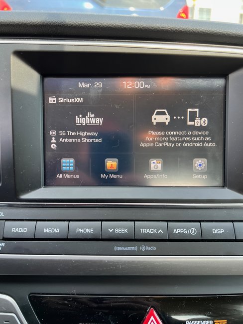

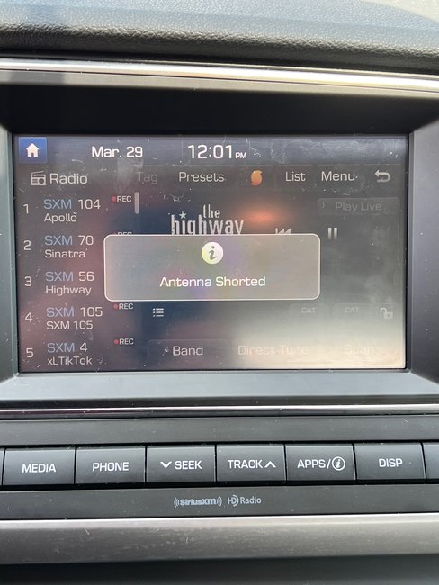

I have the car listed above SE and the battery completely drained. So replaced the battery and now it says that the antenna is disconnected to the XM radio. Called XM radio and tried to trouble shoot, rebooting the radio which didn't work and sending a refresh with no luck. They said I might have to take it to the dealer which to me is my last resort. I tried to do a little research to find some info and came up with disconnecting both battery cables and holding them together for 30 seconds that didn't work. Then turn the radio on and gently tap the sharks fin antenna also no luck. So don't know what else to try and would greatly appreciate any ideas.

If all that happened was the battery drained and it was replaced, now you have no sat radio then we may have a radio issue as it is clearly trying to connect to the XM sat but it can't due to not seeing the antenna. So, it doesn't sound like it is a configuration issue and it doesn't know that it has XM service. Can you get a picture of what the screen looks like? That will help confirm that it does have a service.
Also, when you were talking with XM, they should have tried to ping the radio. Were they successful in doing that? Did their system return a good signal or was it not able to find it?

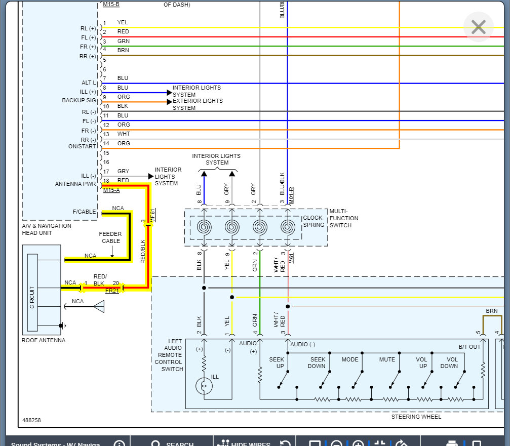

So, to eliminate an antenna issue let's check and make sure you have power going to it and that we didn't pop a fuse.
I attached the wiring diagram below, as I assume you have navigation. I don't think it matters for the antenna but let me know if you don't. Also, I don't see a fuse specifically for the antenna so if this is the only thing not working then it should have power coming from the radio on the red wire.
Please run through this and let me know what you find.

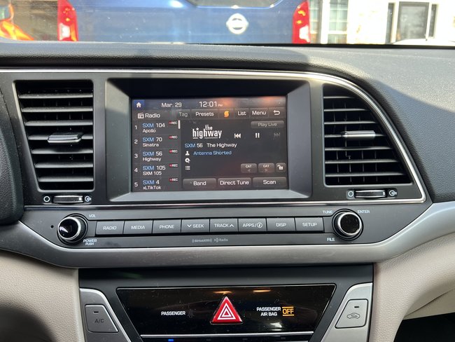

Hello Kenny and thanks for helping. I'm going to send a couple of pics to see if they will
help out. I'll see if I can determine if there's power going to the antenna. I'll let you know what I find.

This could be a coincidence, but this message of the antenna is shorted is pretty clear.
The easiest way to test this is to use a "test" antenna. Most OEMs supply these the dealers where they can just plug a known good external antenna into the radio. If the radio works, then you know the antenna or cable are the issue.

alright thanks. There's one more question, I would like to ask and might sound like a stupid one but no telling with the new cars now a days, so there are no wires or anything that is related to the antenna or antenna wire coming from the battery? Antenna and cable is just from the back of the radio.

No problem.
That is correct. There are no other power wires going to the antenna other than that from the radio.
Basically, the radio supplies the power and gets the signal back from the antenna.
