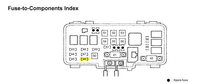

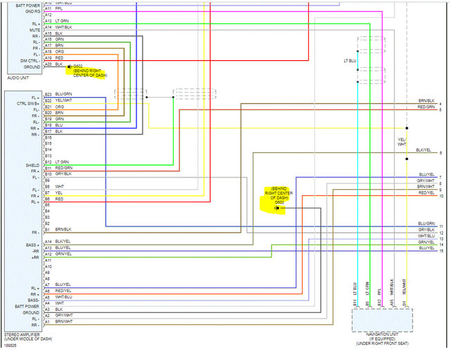

I have the vehicle listed above with a DVD player in it, it's well condition. I have check all fuses and wires that run into the radio. I've also purchase a new manufacturer radio just in case. Everything seems to have power. The jack for the auction and USB in the third row all have l power as well. My display where my mileage and time are displays is work. Along with the hazard and venting system. Some body please help!
Mar 12, 2021 at 9:51 AM
  • 110,251 POSTS

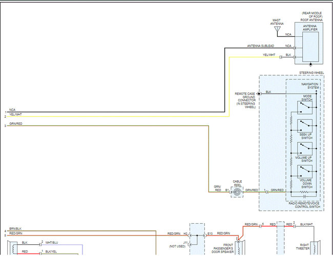

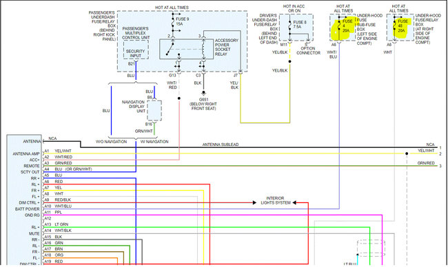

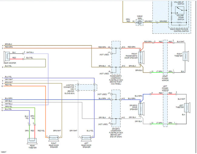

I attached the entire wiring schematic for the Bose system. First, check the fuses I highlighted. Next, make sure the grounds are good for both the receiver and the amp. They are both located in the same place, center under the dash. I highlighted them as well.
The schematics below were cut in half to make them more readable. I did overlap them so you can follow them easier.
Here is a link that you may find helpful:
When checking fuses, confirm there is power to and from the fuse.
