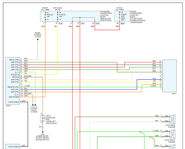

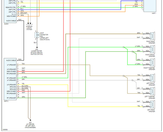

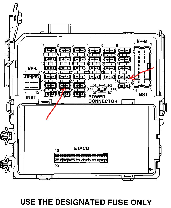

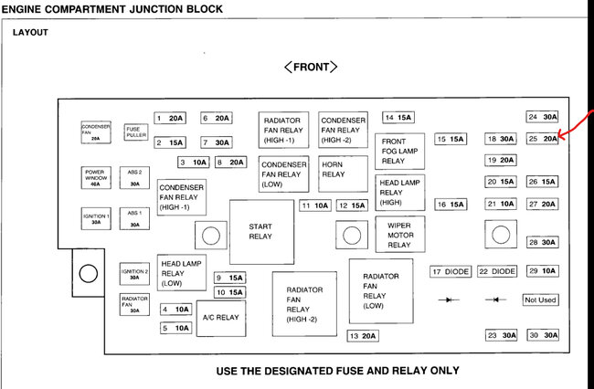

A while back my alternator went out and I replaced it but when this happened my radio turns on, but no sound comes out. I checked all fuses, and they are good. Could it be the amp? does it have a fuse to it? Thank you
Dec 11, 2023 at 1:40 AM
  • 55,694 POSTS
Yes, there are three fuses that run the system which need to be checked.
Here is a guide that will help and the fuse locations as well:
The fuses that need to be checked are fuse #24 and #26 in the fuse panel on the inside of the car and the power amp fuse in the fuse panel under the hood. Also, I have included the wiring diagrams so you can see how the system works.
