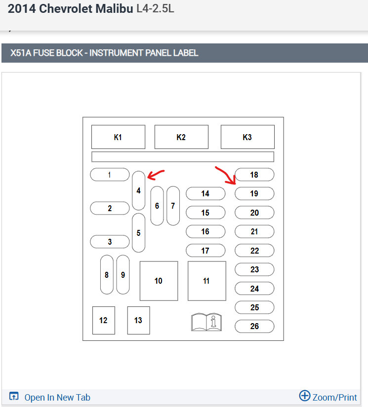

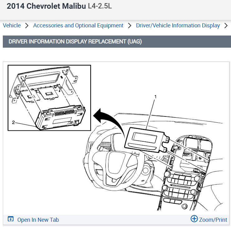

The center Informational screen and backup camera not working.
Apr 1, 2025 at 12:57 PM
  • 55,711 POSTS
It sounds like the info display module has gone out which is in the center of the dash, but we should check the fuses #19 and #4 in the fuse panel on the left side of the dash. Here is a guide to help and the fuse locations in the images below.
Here is the location of the info display module in case the fuses are good so you can swap it out. Check out the images (below). Please let us know what happens.
