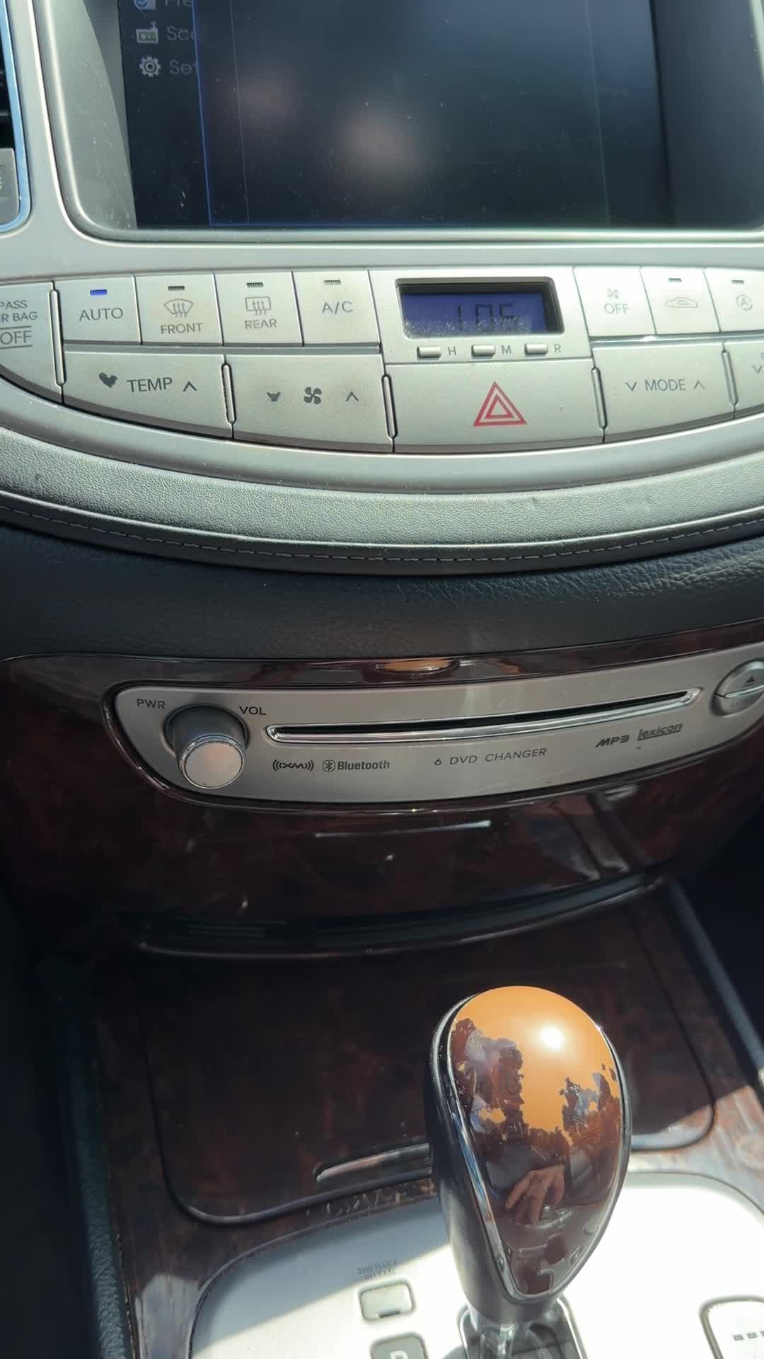

No radio stations or xm or any sound?
2010 HYUNDAI GENESIS
130,000 MILES • 4.6L • AUTOMATIC
BHAMDOC1
  • 364 POSTS
It had a bad battery installed a new one same issue, no radio stations or xm or any sound
Sep 8, 2026 at 12:51 PM
  • 55,433 POSTS
A bad battery or voltage spike can cause the audio system to lock up, but we need to determine whether the radio itself is operating.
Does the radio display turn on and respond normally? Also, do you have sound from any source—CD, AUX, Bluetooth, navigation prompts, or warning chimes?

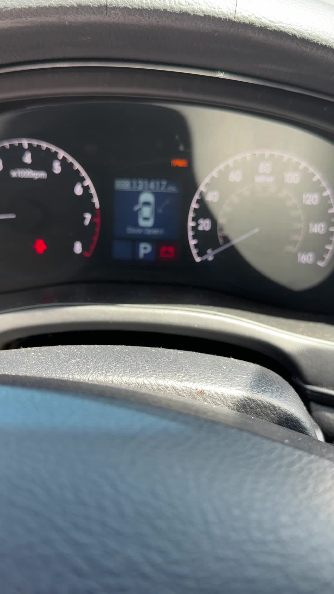

Only thing i hear is the chime when u turn if ition on. No nav sound or any radio sound at all. Just saw that the battery light is on now i know why it was dead. Checked at battery with a voltmeter and its battery voltage

REPLACED ALTERNATOR AND BATTERY LIGHT IS OFF, BUT STILL NO SOUND. I WILL DO MORE CHECKING

Other than this sound nothing. What are the chances the amp went out at same time the alternator did. Where is the amp on this one?

There are two kinds of radios, one has an amp one does not. If it has an amp I would check the AMP fuse in the fuse panel inside the car. The clock spring may be bad as well. I have seen this cause the radio not to work. Here is the location of the AMP if it has one. Double check these fuses as well.

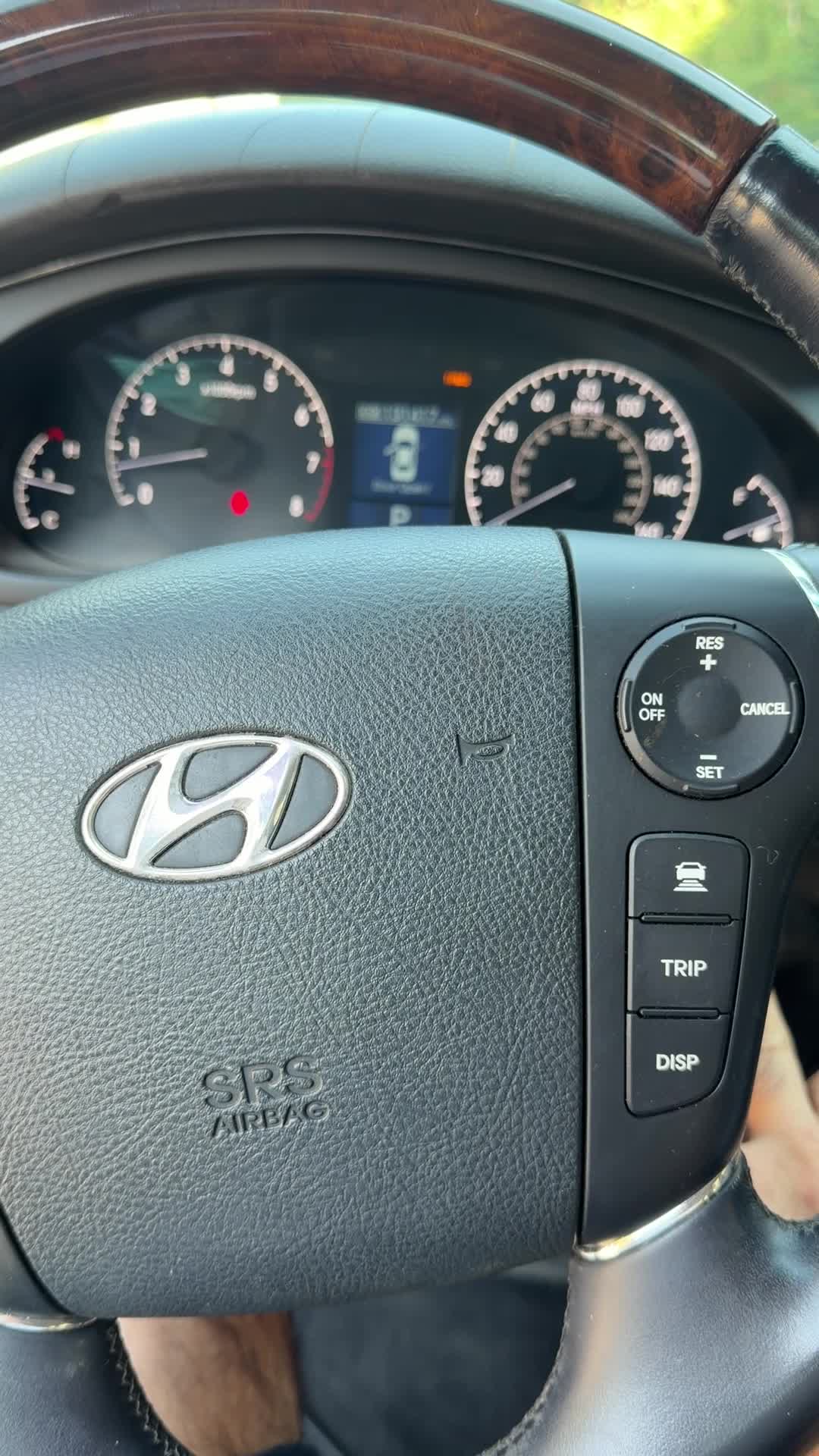

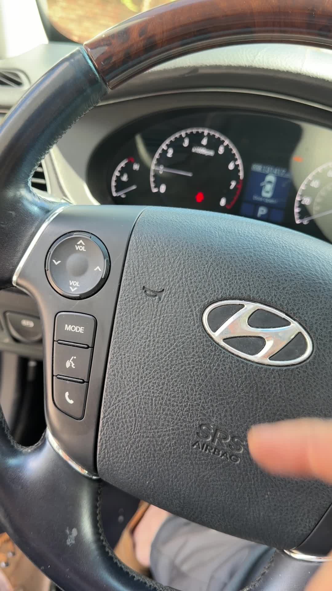

Also cruise does not whork when i set it. Ill do a full scan
Sep 22, 2026 at 9:25 AM
  • 55,433 POSTS
Yep, lets see if any codes are in the system, it can be the clock spring that has gone bad.
