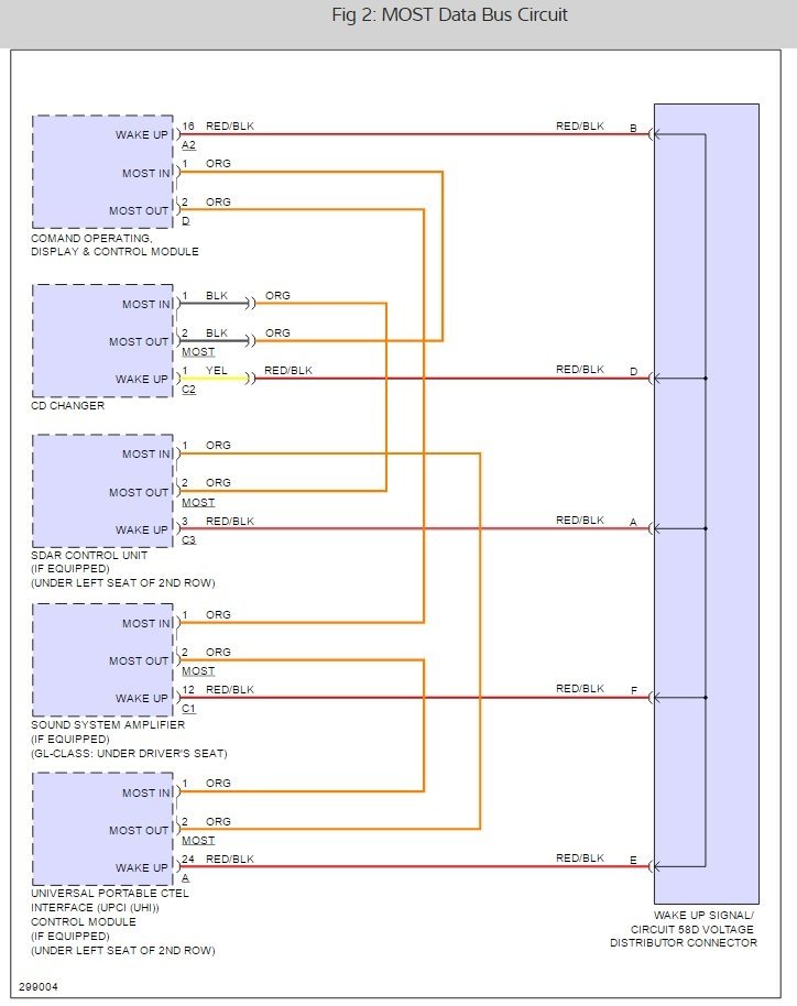

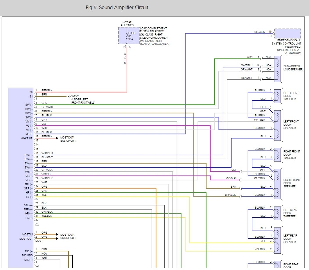

my sound system has a constant clicking noise or popping when using the Radio, When using the phone I can hear the caller, they can not hear me. my Sirius/XM will not pick up or go to preview channels. My embrace can not locate the car and when I press the (i) button nothing happens. when I try to go to the audio menu it won't stay on what I select it jumps in and out of that screen.
Mar 24, 2017 at 4:09 PM
  • 55,224 POSTS

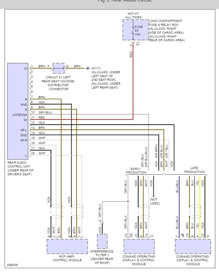

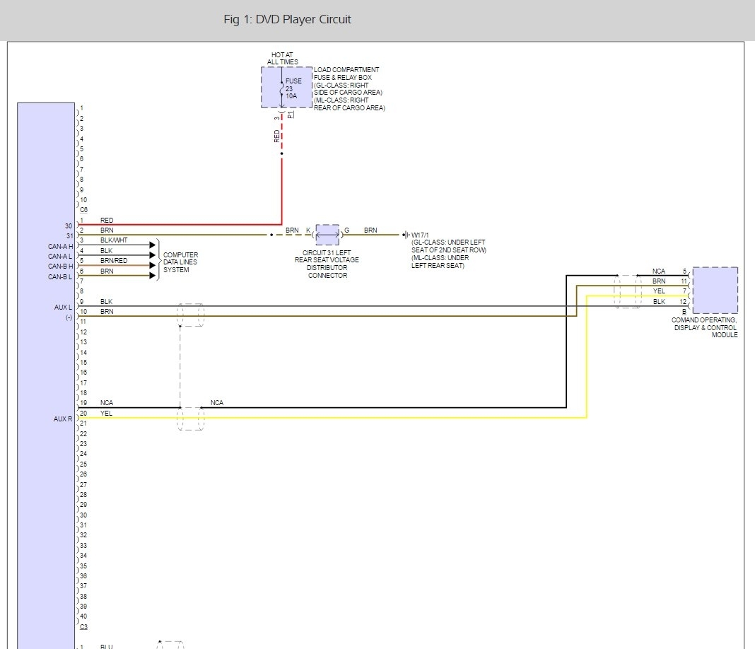

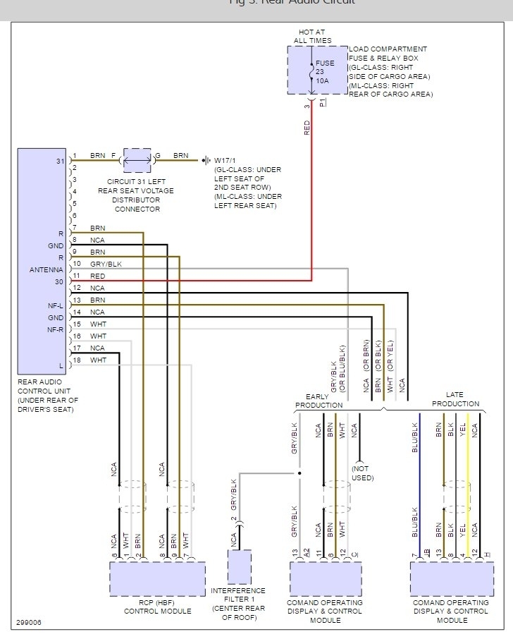

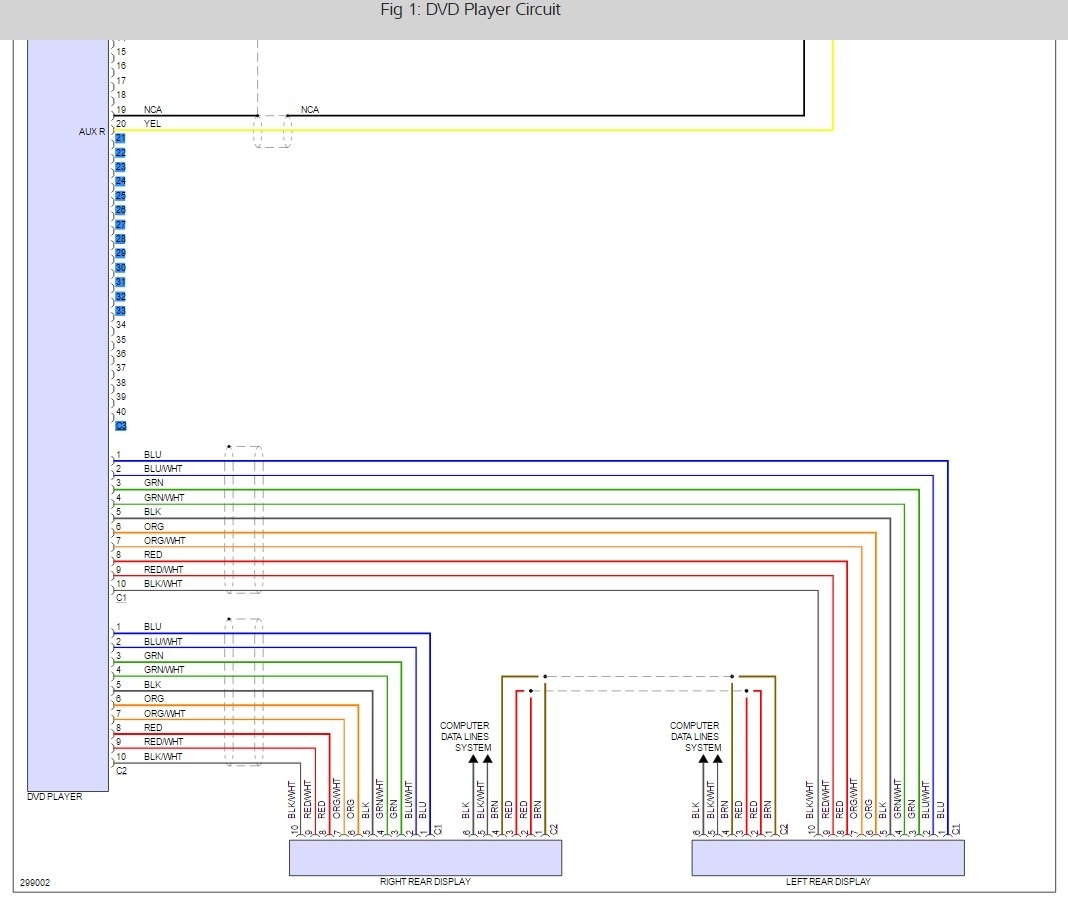

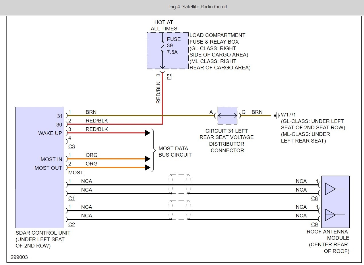

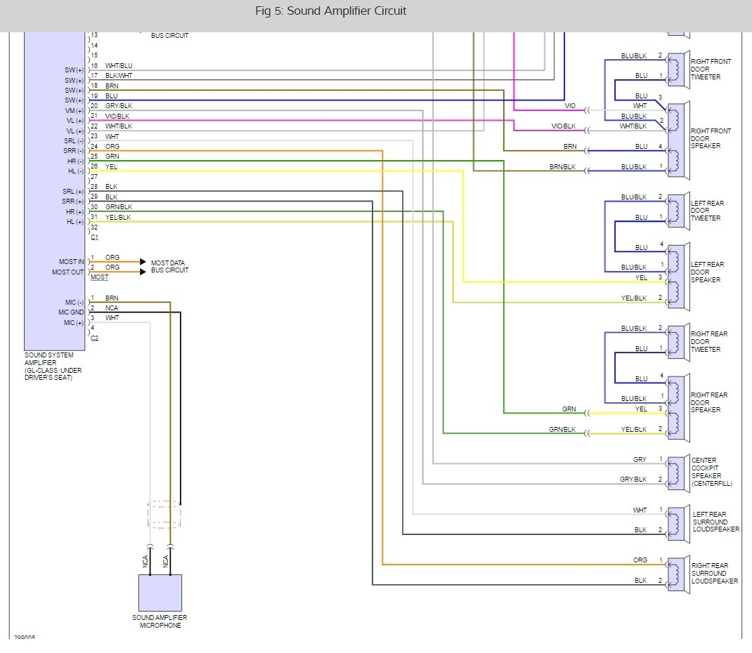

It sounds like you have an amplifier going out. The microphone goes through it as well. Here is the radio wiring diagrams so you can see for yourself.
Best, Ken
