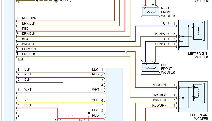

I need help figuring out what cords go to which exactly because I'm confused. I'm trying to install a pioneer DEH-150.

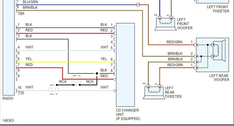

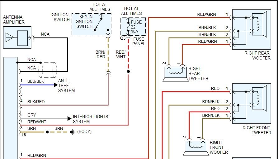

I attached the entire schematic for this vehicle. I had to break it into 3 parts so you could read it. I overlapped them so you could follow them.
Let me know if this helps.

If you let me know specifically what you need, I will try to break it down. The pictures I attached show all the wiring for this vehicle's radio/stereo system. If you look closely, it identifies speaker wiring, power supplies, and so on.
