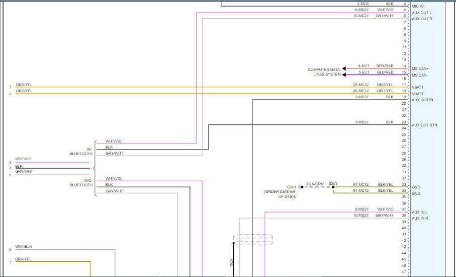

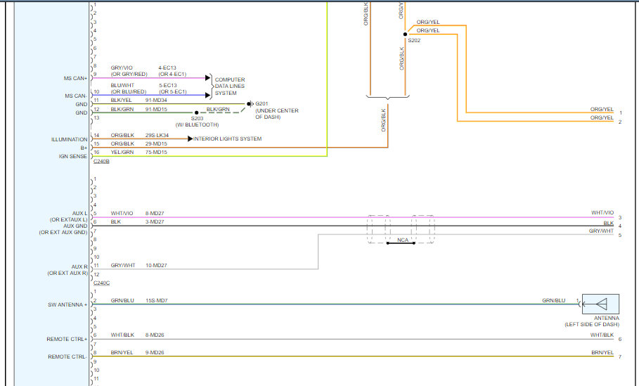

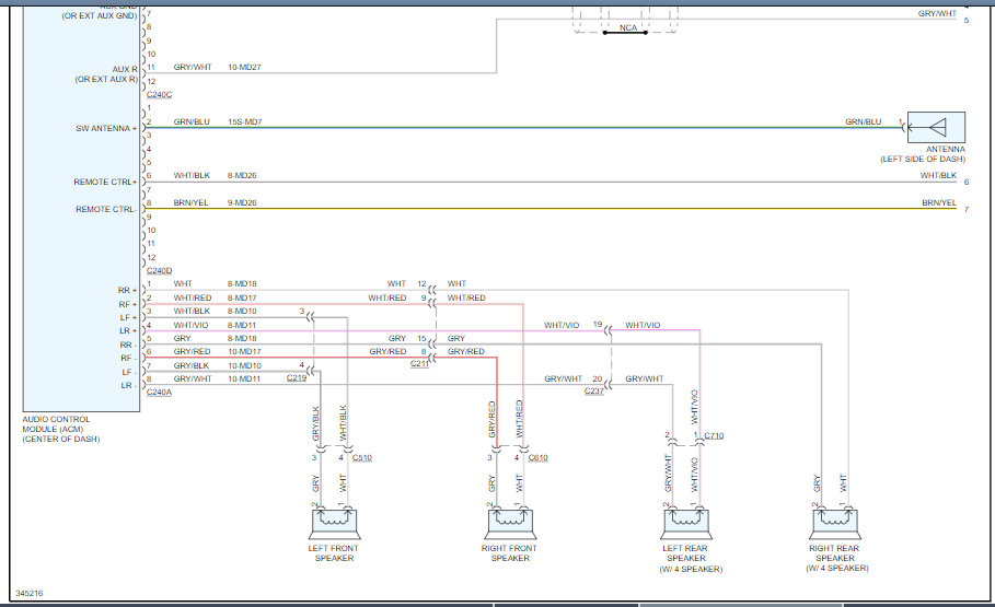

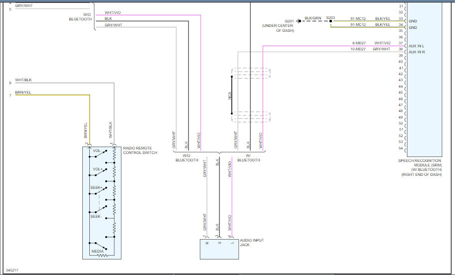

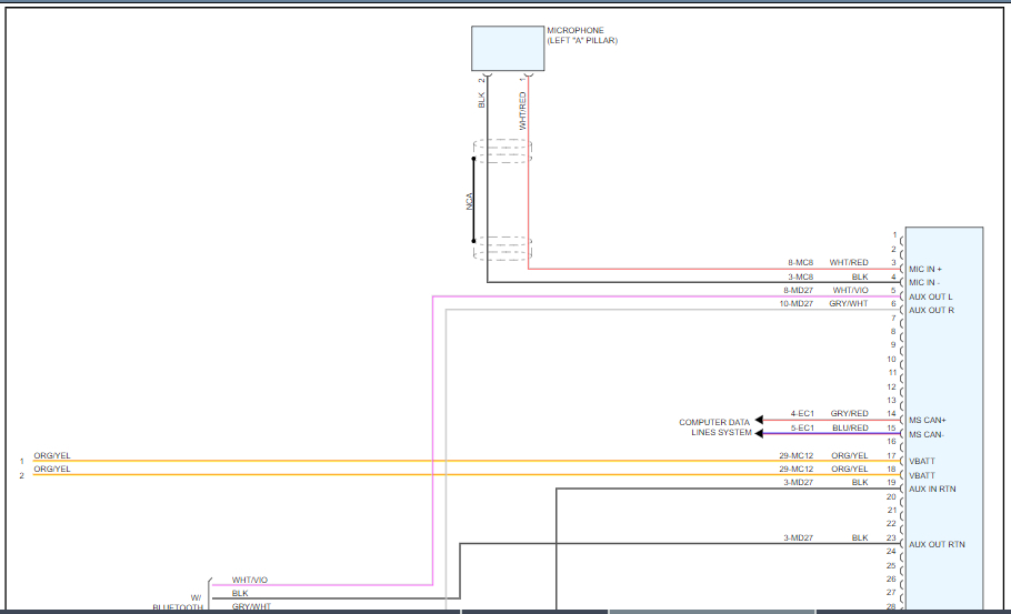

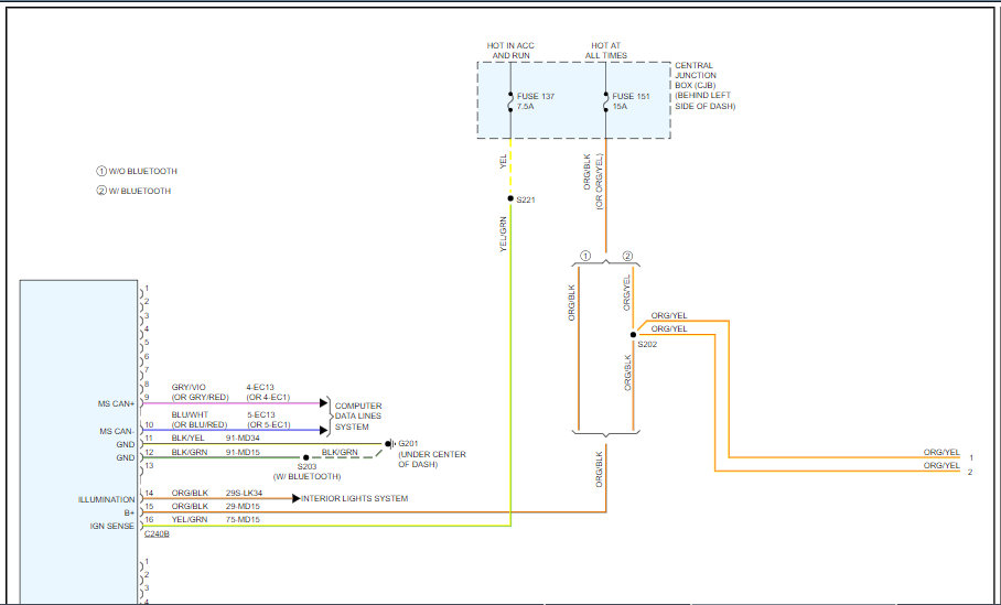

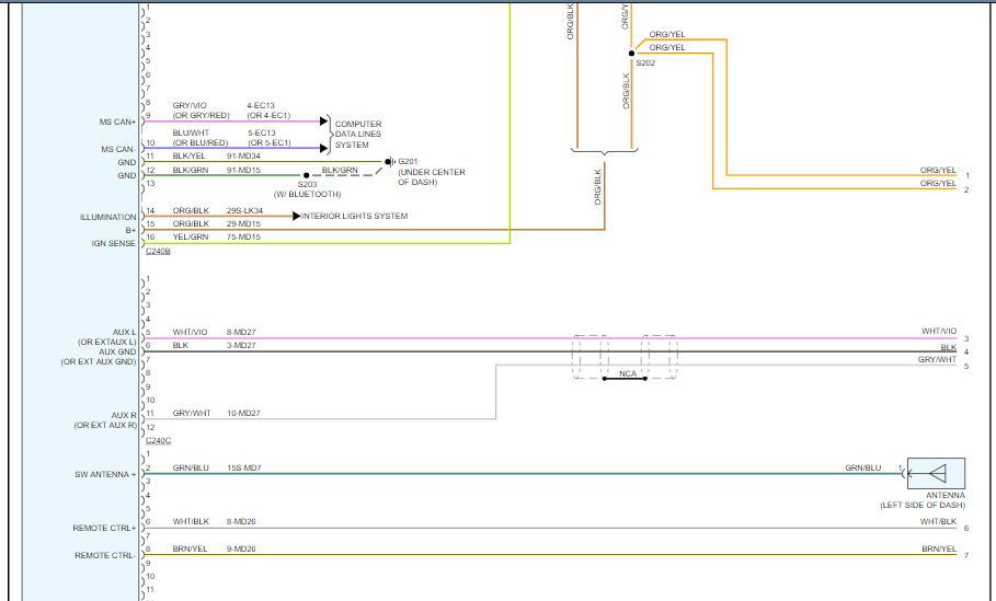

What do the colors correspond to? Can you provide wiring diagrams and tips on testing voltage?
Monday, August 14th, 2017 AT 2:53 PM
DANNY L
MECHANIC
5,648 POSTS
Hello, I'm Danny.
Here is the information you requested. This is a tutorial for you on how to test wiring:
I've attached the radio wiring diagram below for your Transit. I've cut the picture into 3 pieces each so you can view larger. Hope this helps and thanks for using 2CarPros.
