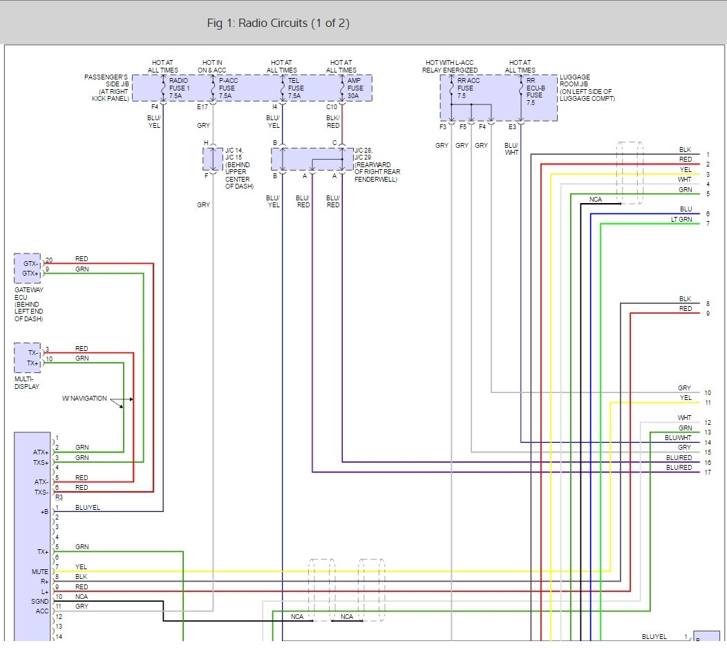

Key out door open radio has sound. no controls operate on radio. If you turn key in ignition back/forth a few times it will stop playing. ignition switch has been replaced. Same results. Drains the battery as well. Alternator is charging. Could the ignition cylinder be the issue since back/forth stops the sounds?

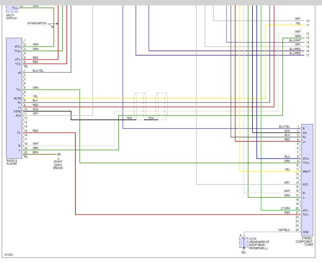

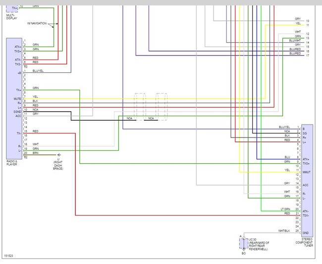

Hey,
This sounds like it is going to be a problem with the gateway ECU which controls the power to the radio.
Here is a wiring diagram so you can remove the radio and do some testing to see if the power shuts down from the ECU.
Also, check the fuses in the system the wiring diagram shows which ones to check.
and
Please run some tests and get back to us so we can continue helping you.
Best, Ken
