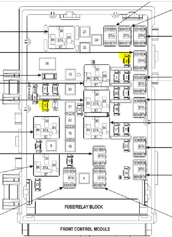

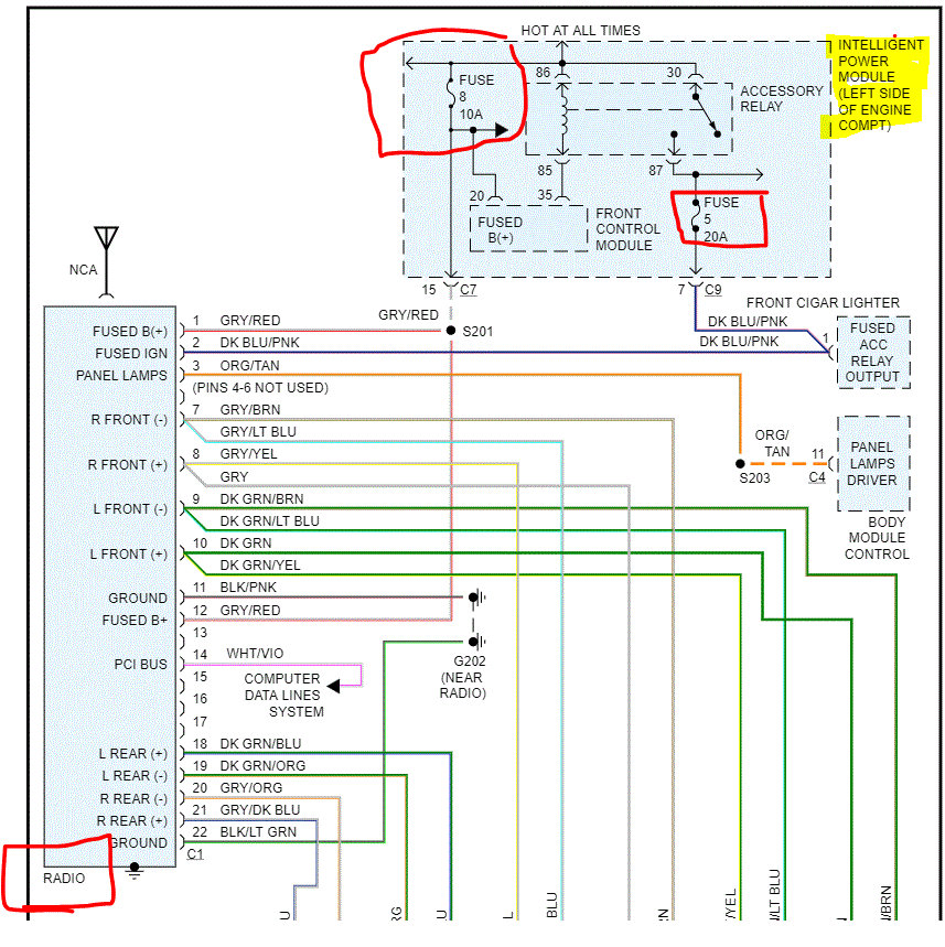

What fuse controls my radio?
Apr 24, 2020 at 9:26 AM
  • 110,248 POSTS

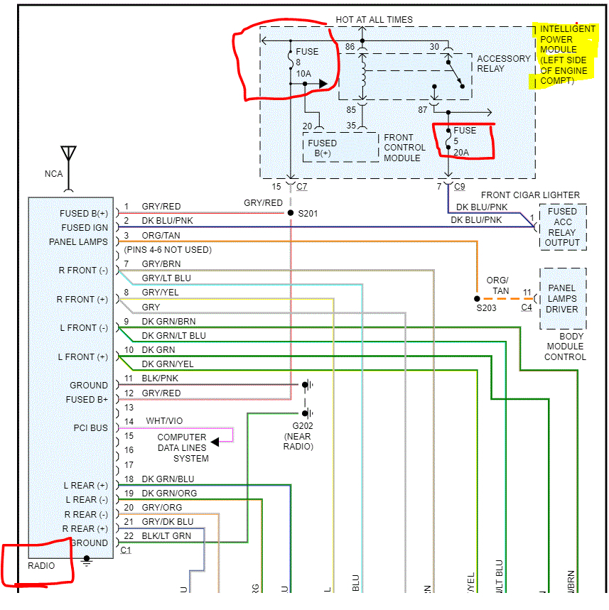

I attached a picture of the wiring schematic for a basic radio on this vehicle. I circled 2 fuses to check.
Let me know if this helps.
Apr 24, 2020 at 10:49 AM
  • 110,248 POSTS

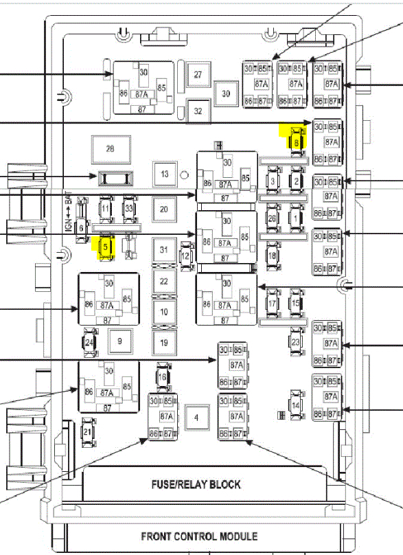

I forgot to add additional info. Sorry about that. If you look at the attached picture, it shows the under hood fuse box. I highlighted the two fuses I mentioned so you can find them easier. Also, here is a link that you may find helpful:
Please feel free to let me know if you have other questions or need help.
