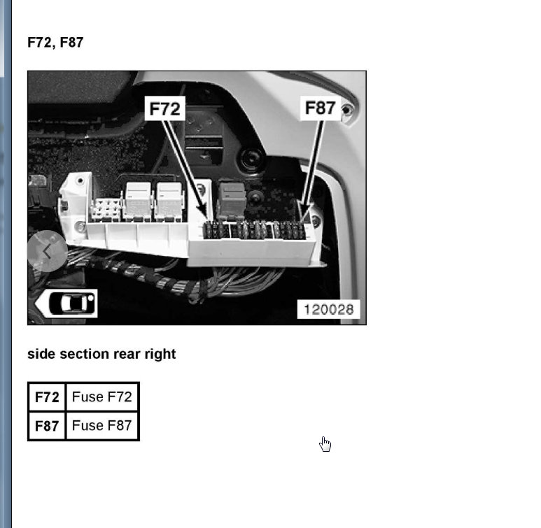

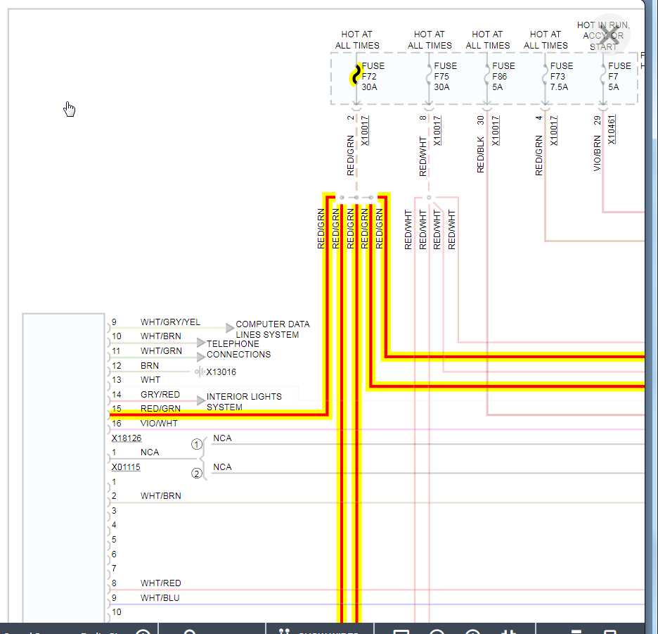

After the battery is dead for a longtime. i replace the battery but the radio never turn on.
May 9, 2020 at 1:19 PM
First does the radio power on at all or is there nothing on when you turn the key on? If nothing happens then we need to check fuse F72 and make sure it is not blown.
If the fuse is okay and the radio has power and ground then I suspect the radio is the issue.
Let us know what you find with this and we can go from there. Thanks
