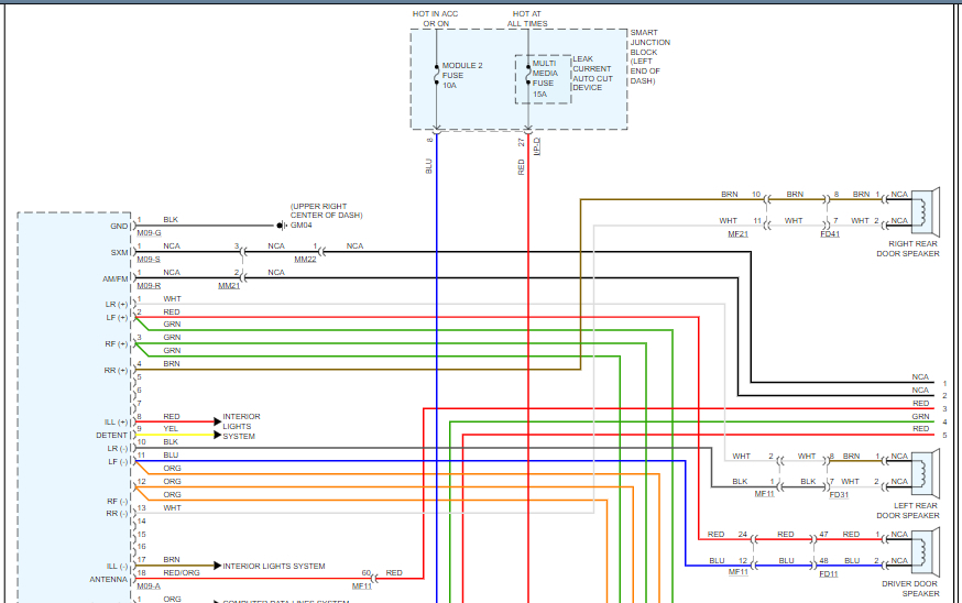

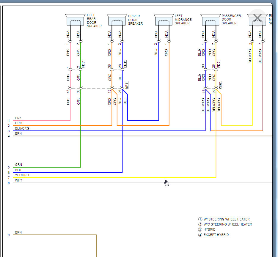

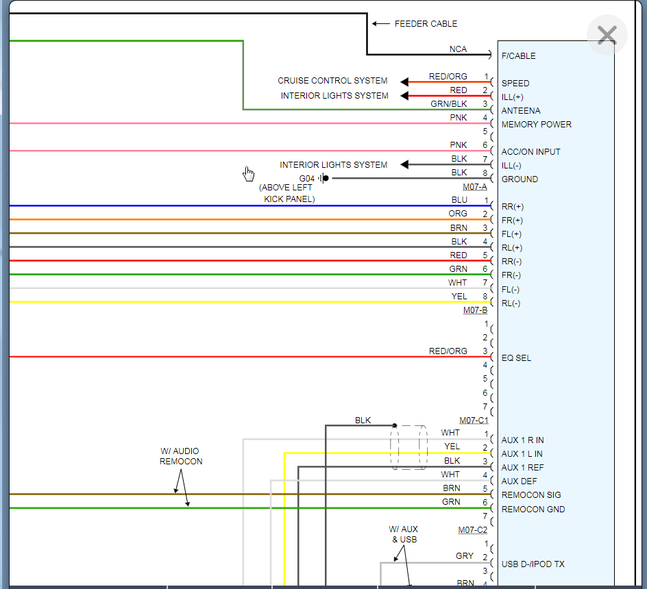

Radio wiring diagrams needed
2016 KIA OPTIMA
37,000 MILES • 2.0L • 4 CYL • TURBO • 2WD • AUTOMATIC

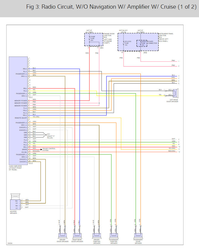

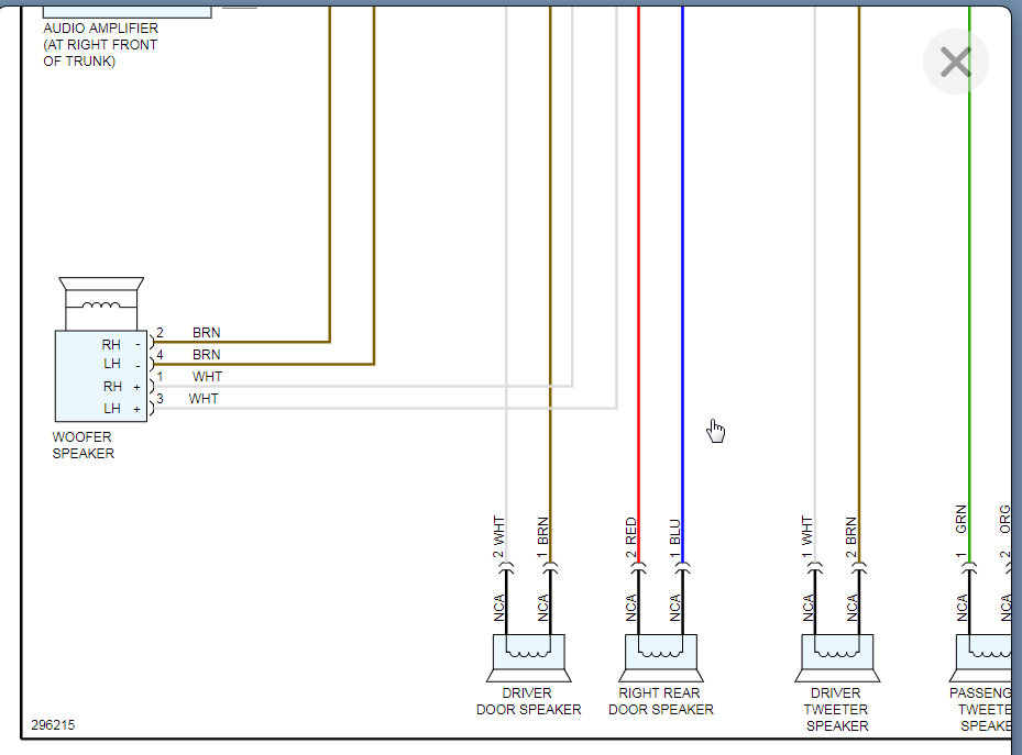

LEARY DLB CURTIS

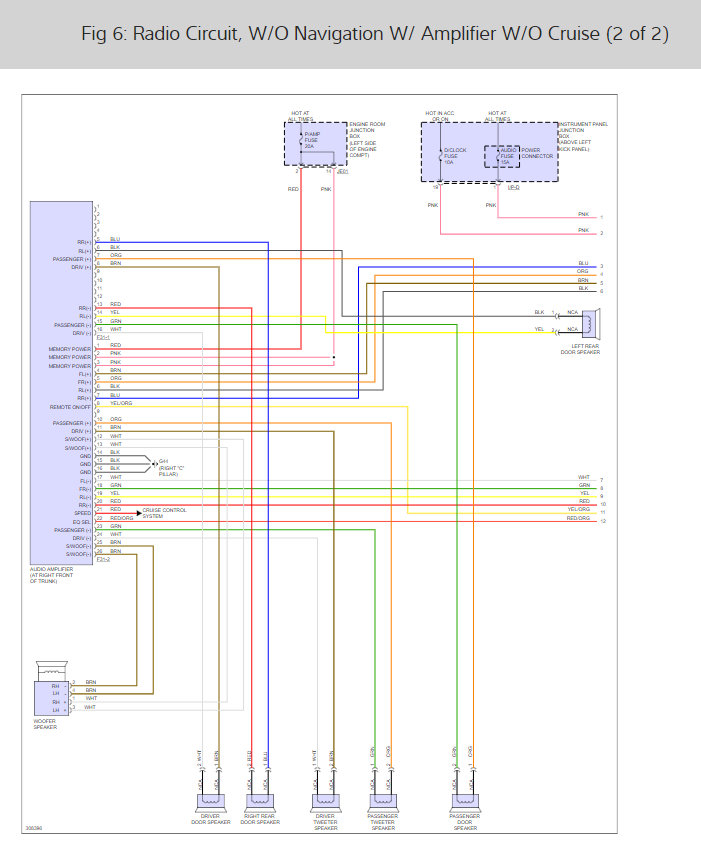

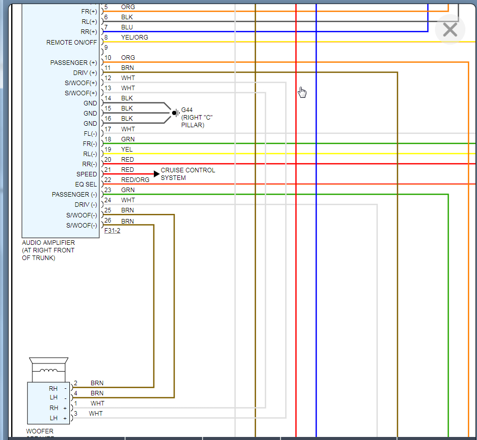

Car listed above is an SX with Harman/Kardon and sub woofer. Just looking to add subwoofers using a full range speaker.. I need the rear speakers wire colors.
Dec 28, 2020 at 5:57 AM
DANNY L
  • 5,648 POSTS
Hello, I'm Danny.

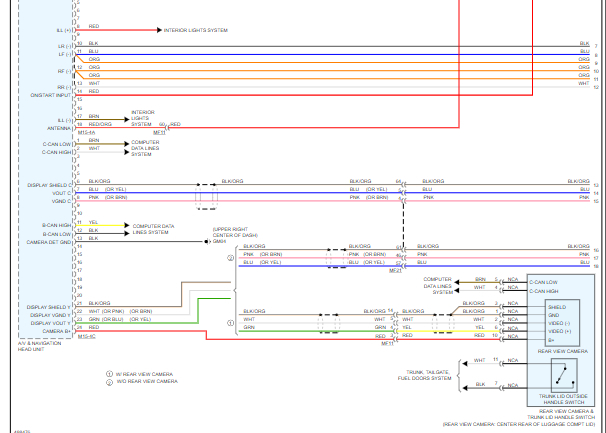

I've attached the radio wiring diagrams you requested for your car below. I'm not sure which audio system your car is equipped with so I included all of them. There are navigation with amplifier, navigation without amplifier, and without navigation. I've cut the pictures in half so you can view larger. Hope this helps and thanks for using 2CarPros.
Mar 10, 2021 at 11:08 AM

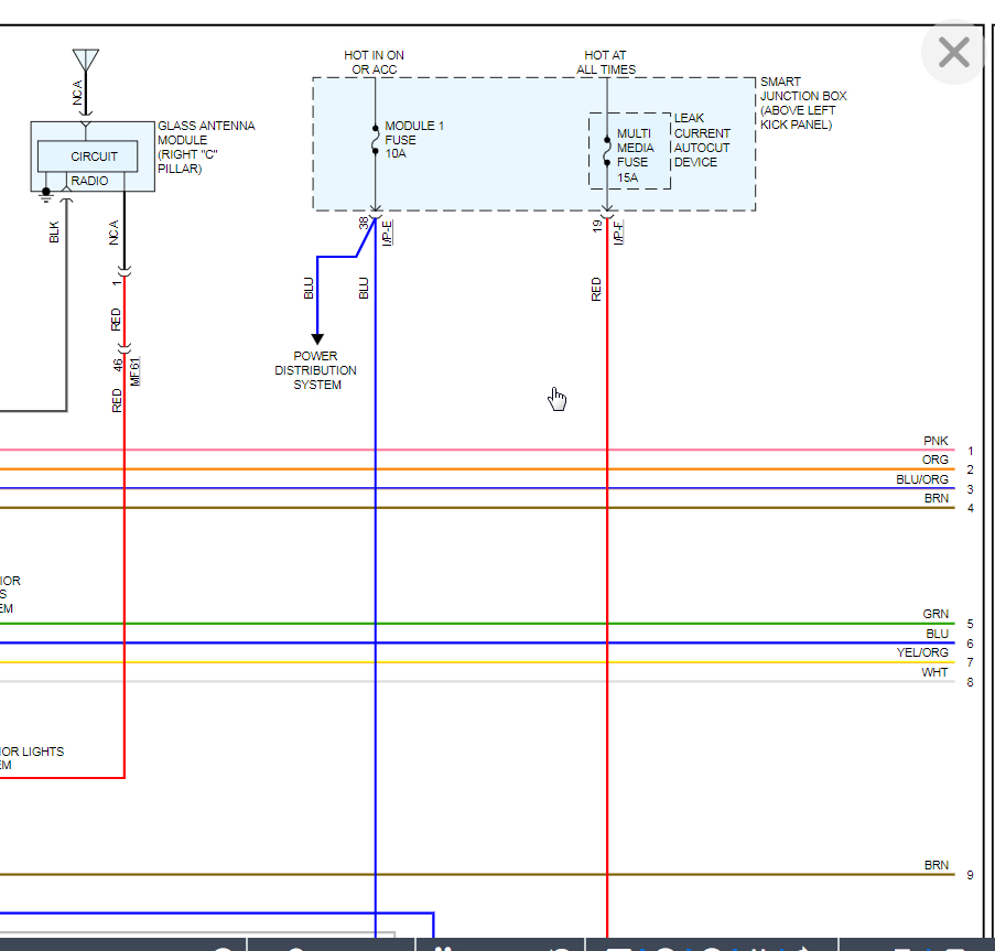

SKUBASTEVE

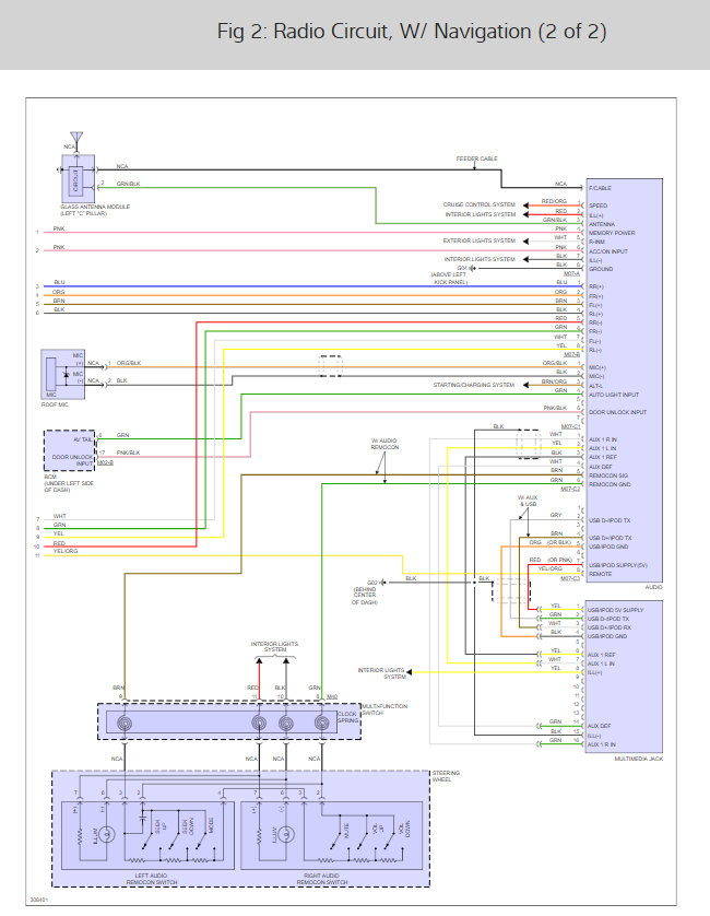

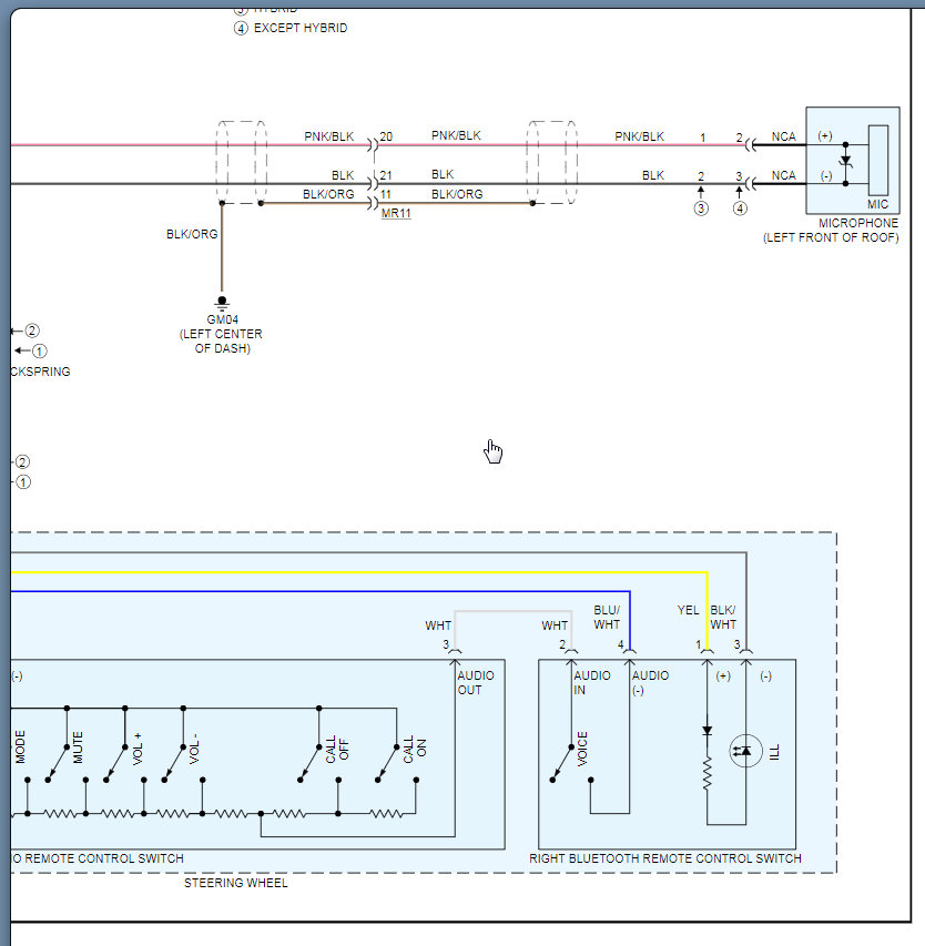

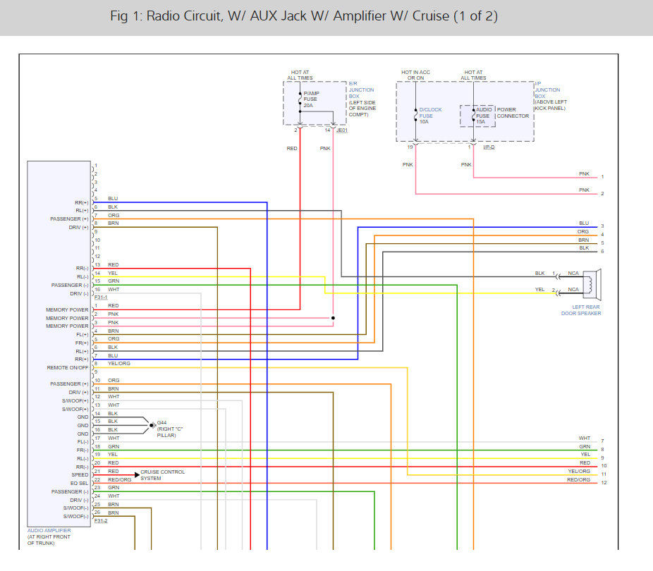

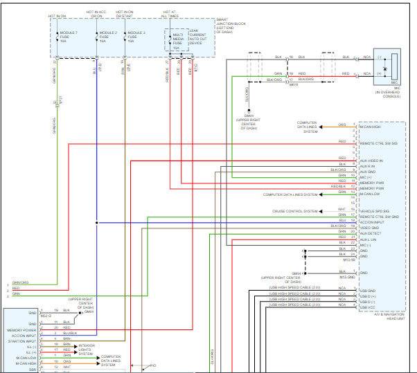

Vehicle listed above is the EX model.I have the touchscreen with backup cam and nav. I've recently ordered a LC2i so I install two amps and a sub while keeping the stock head unit and all it's functionality. I can't seem to find any wiring info at all for this particular year and head unit. Any help anyone could provide would be greatly appreciated.
Mar 10, 2021 at 11:10 AM (Merged)
DANNY L
  • 5,648 POSTS

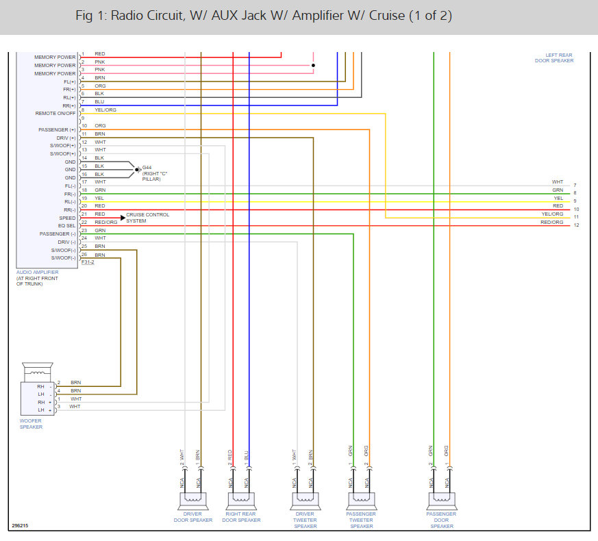

Hello, I'm Danny.

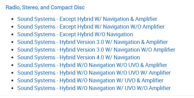

We need a little more info on your car to get you the right diagram.Can you tell us if your car is the hybrid or can you add engine information? Also, I've attached below a picture of the different stereo system systems. Can you tell me which one is yours? Hope this helps and thanks for using 2CarPros.

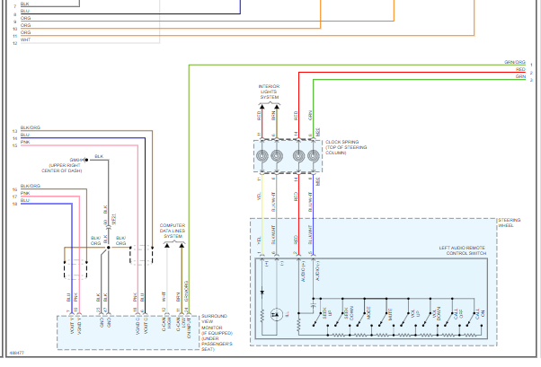

SKUBASTEVE
Hi Danny,
It is not the Hybrid version. I believe the engine is a 2.4L. I'm pretty sure the second stereo listed in your image will probably be the correct one. I do have navigation but not the premium Harman Kardon upgrade that came with an external amplifier so that one seems to be the most accurate description.

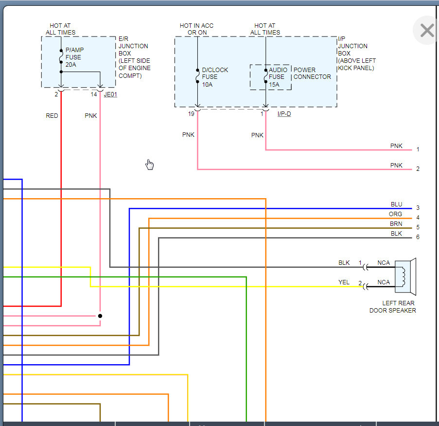

Hello again.

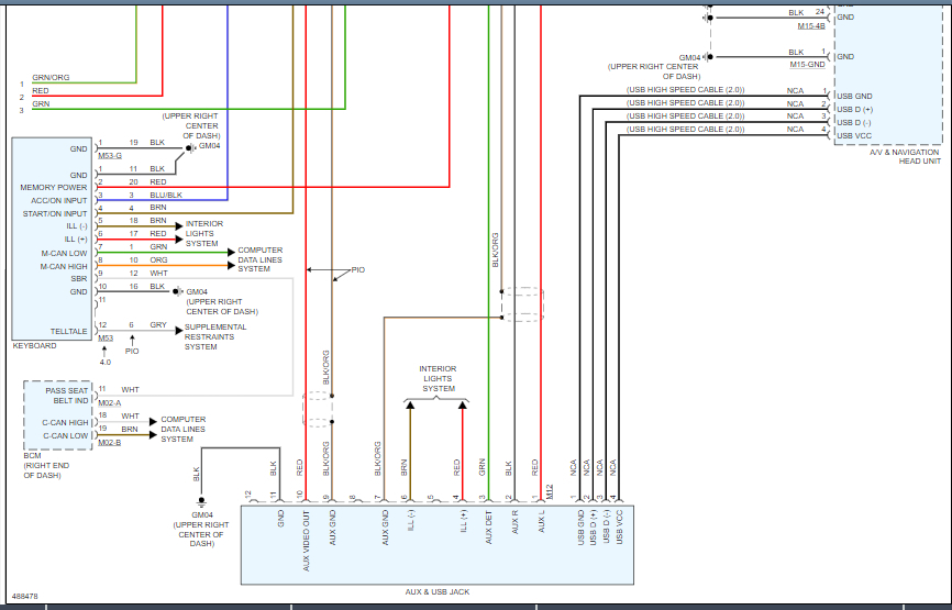

Here are the stereo wiring diagrams you requested. I've cut them in half so you can view larger and attached them below.Hope this helps and thanks again for using 2CarPros.

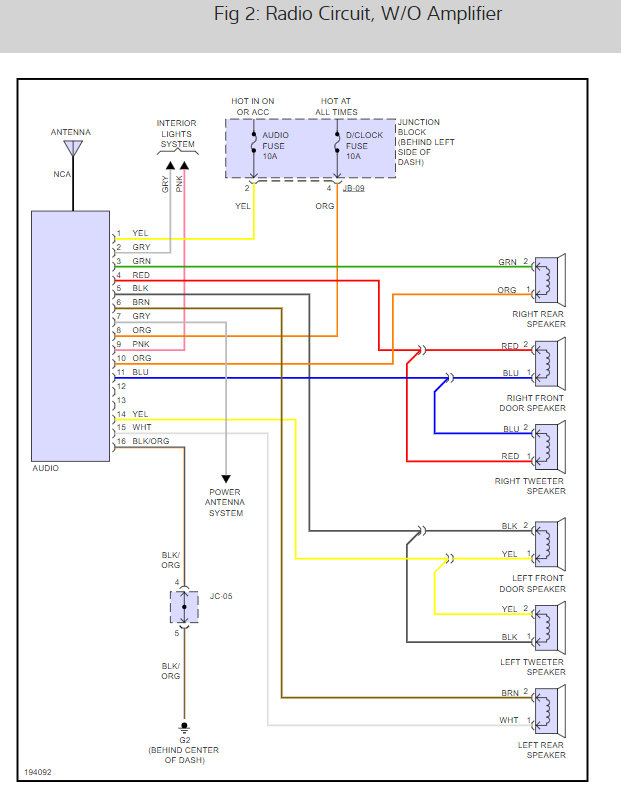

MARIEBOO

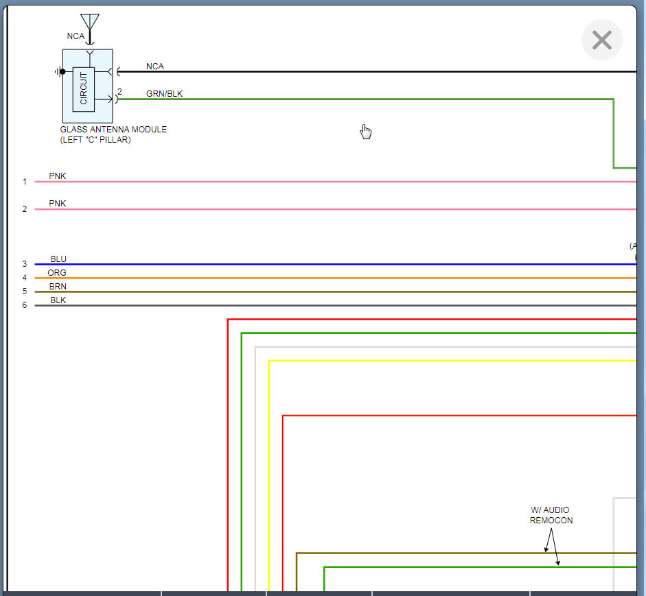

Radio wiring diagram for the car listed above lx model.

MARIEBOO
I have no Navigation. not sure about the other. I have a 4 doors.
Okay. Sounds good. This should be what fits your vehicle. Let us know if you need other info. Thanks

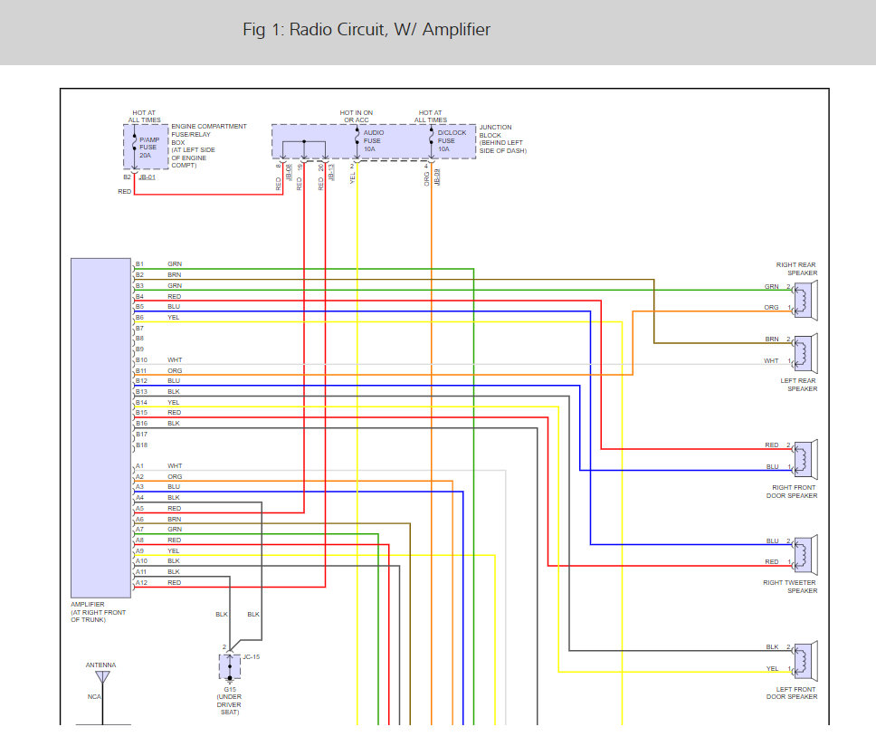

IAN`
I cant find it any where
its a kia optima lx with standard audio

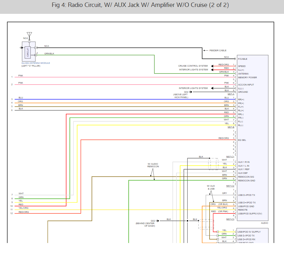

RIVERMIKERAT
  • 6,110 POSTS
Here ya go. I found all wiring diagrams for every kind of radio that came in that car.
Cheers

BEN RODRIGUEZ

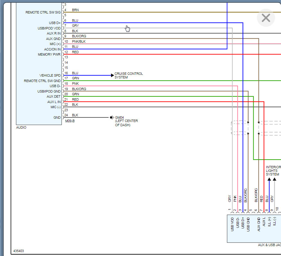

My bro cut the stock harness and have no clue to what wire is which. radio,steering control,aux,with cruise, without navi,with amp. Need help fast.

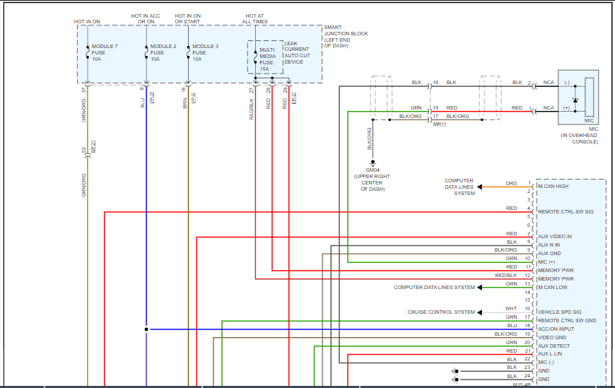

Sorry to hear that. I am attaching the entire radio wiring diagram for the options you specified. Check out the diagrams (below). Please let us know if you need anything else to get the problem fixed. Let us know if you have other questions. Thanks

Here are the wiring diagrams for the radio and a guide to help you test the connections:

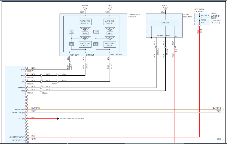

RDMERCER BERNITT
I could use the same help here with putting in a loc, I have a 19 Kia optima SXL 2.0 T. it has navi. I'm pretty sure it's the 10 speaker 600-watt h/k system.as it's called, lol. I have amplifier numbers if those will help, not sure which ones you would need to know, any and all help will be greatly appreciated. thanks, R

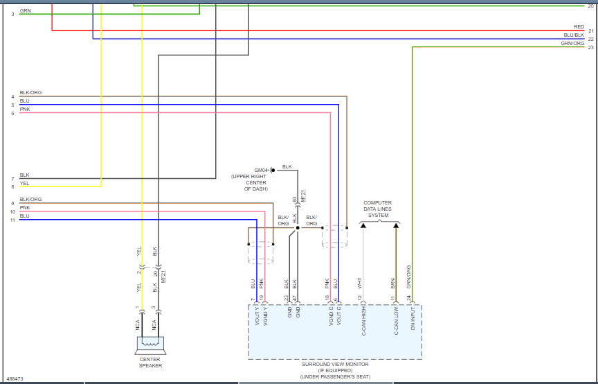

TRAGIC_JEB01
I have a 2016 Kia Optima LX without navigation and it is non turbo. I need the wiring diagram for the rear door speakers
Jul 30, 2026 at 12:10 PM
  • 55,423 POSTS
Did you check out the wiring diagrams above in this post, all of the wiring diagrams are there.
