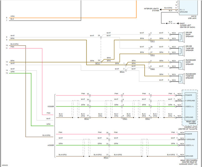

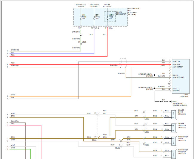

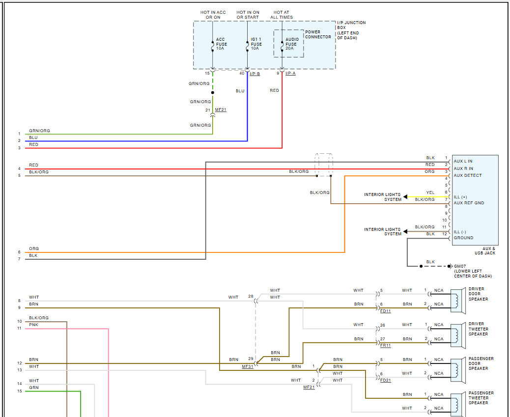

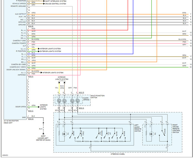

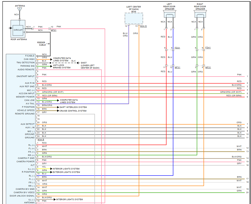

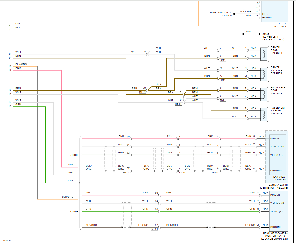

I would love to find a color-coded car stereo wiring diagram for the stock radio. I’m trying to install a new system. Thank you!
Nov 20, 2024 at 3:11 AM
Experienced Mechanic
55,580 POSTS
Yep, here is the radio wiring diagrams with a guide to help you check the connections as well.
Check out the images (below). Let us know if you need anything else.
