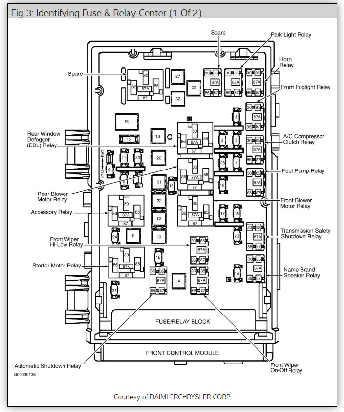

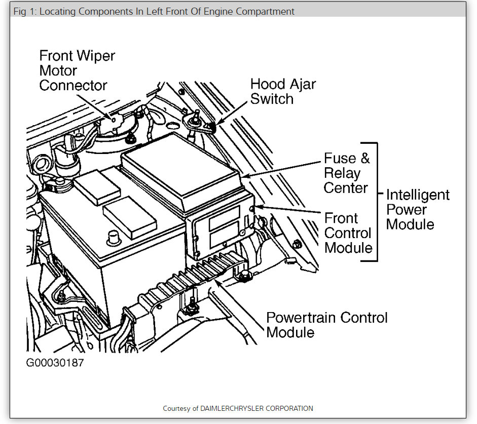

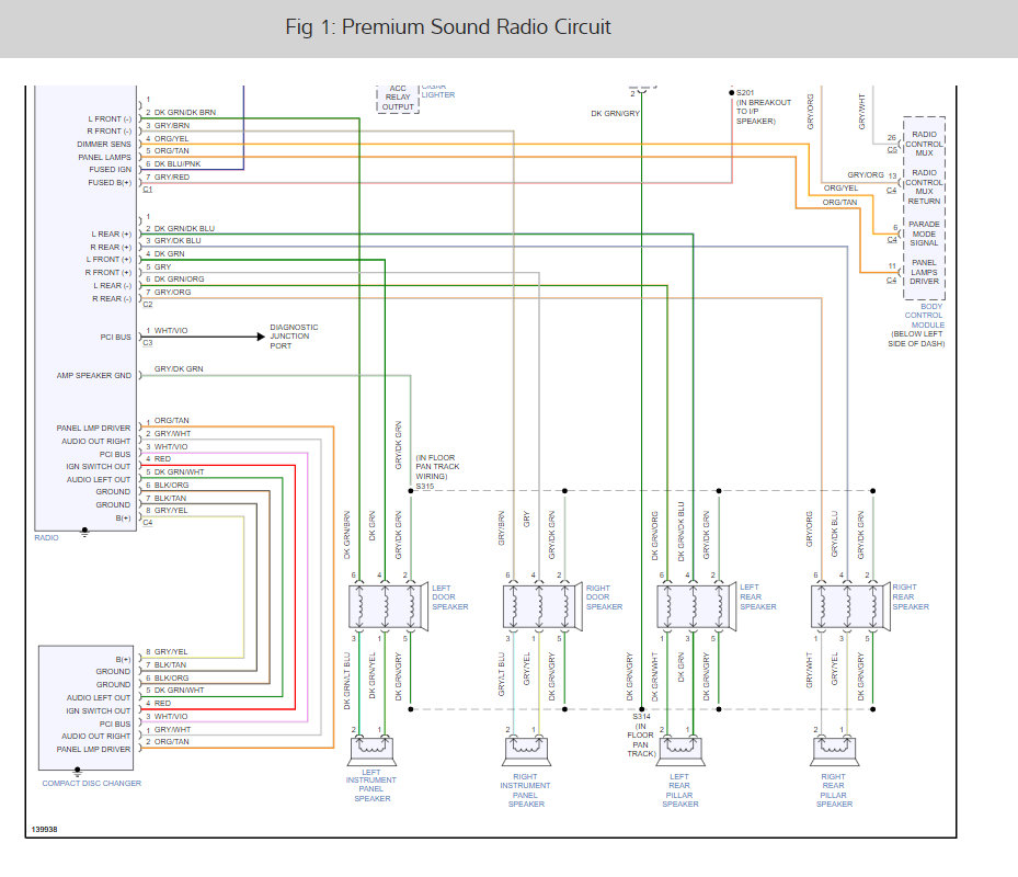

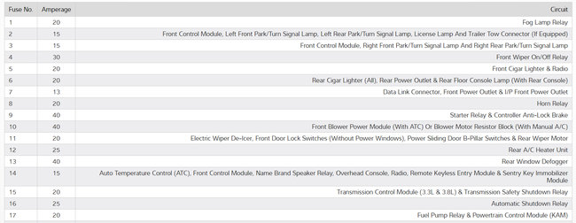

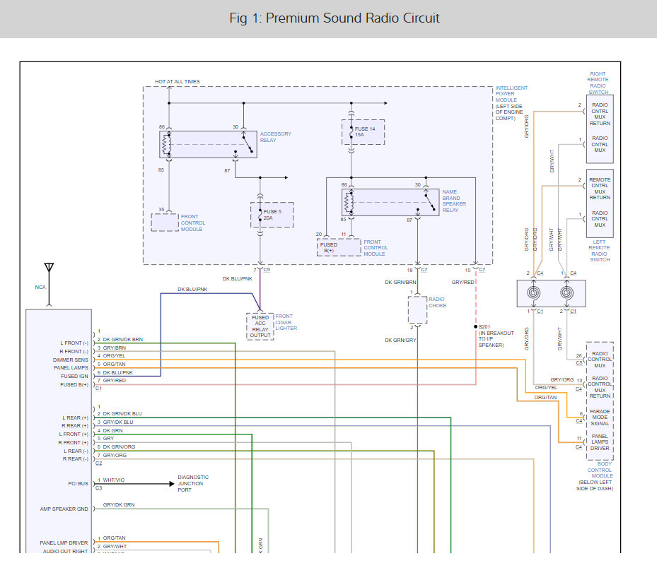

There is a name brand speaker relay we need to make sure is working. here is a guide to help you check it with the radio wiring diagrams so you can see how the system works. Also check fuse 5 and 14.
