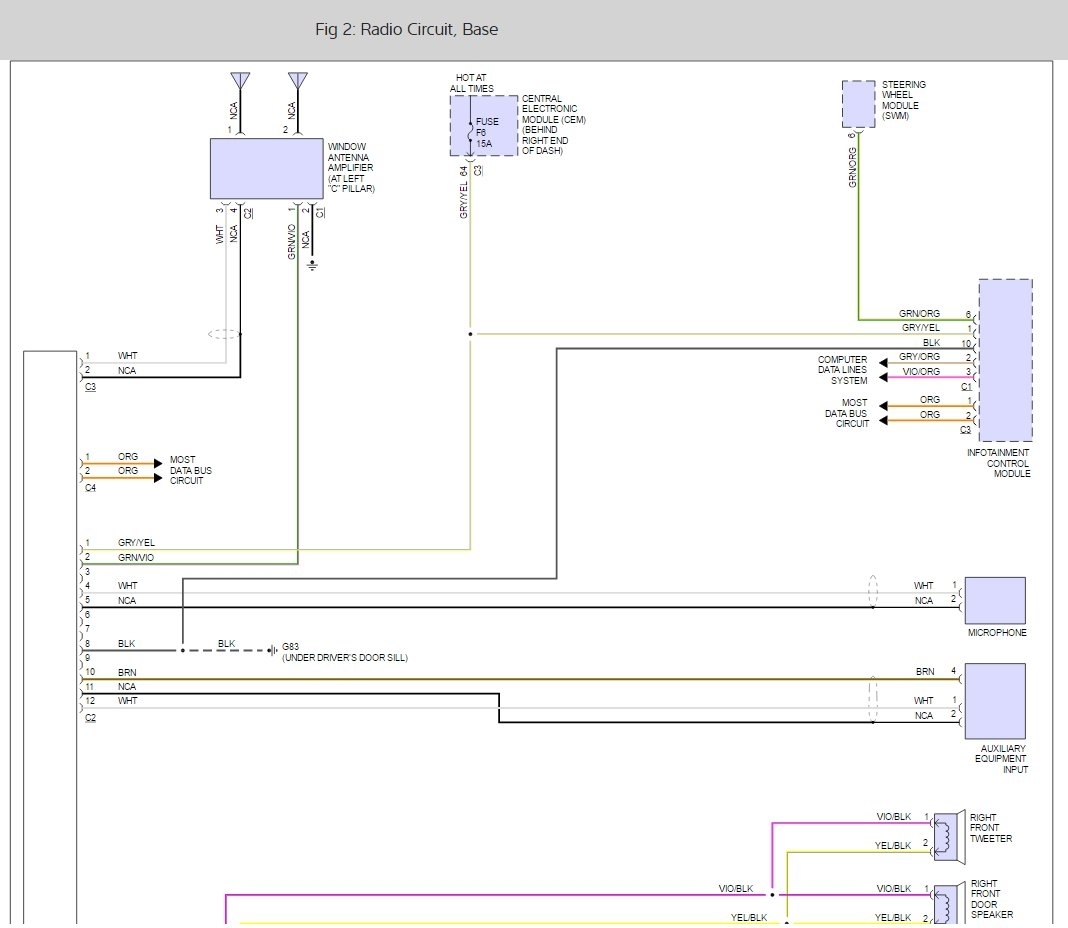

My radio switch off after work for thirty seconds. If I switch off and switch on again the engine the power back and the radio play again. After thirty seconds he switch off again. But he only switch off the radio not the display all. I see the fuses box and are all good. Some help please.
Mar 18, 2017 at 10:15 PM
  • 55,433 POSTS

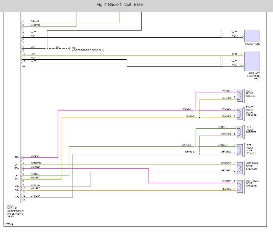

Is sounds like the amplifier is shorting out when it gets hot, but to be sure please check the fuse, here is a wiring diagram to help you do some testing.
