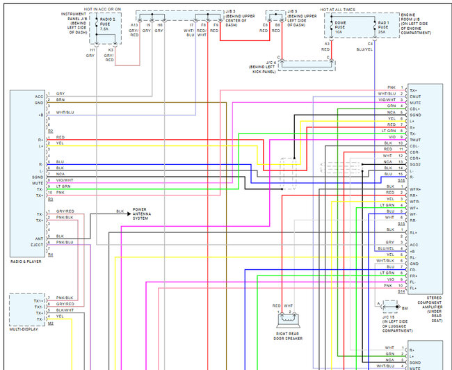

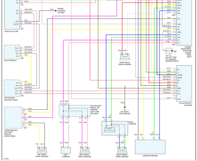

I need the color codes for the factory radio wires, to an aftermarket radio, and speakers. Connection straight to the factory and bypassing the amp.
Jul 11, 2025 at 12:48 PM
  • 55,709 POSTS
Here are the wiring diagrams for the radio and speaker, I noticed there is a telephone ECU inline for the left door speaker which will need to be by passed as well. Check out the images (below). Let us know if you need anything else.
