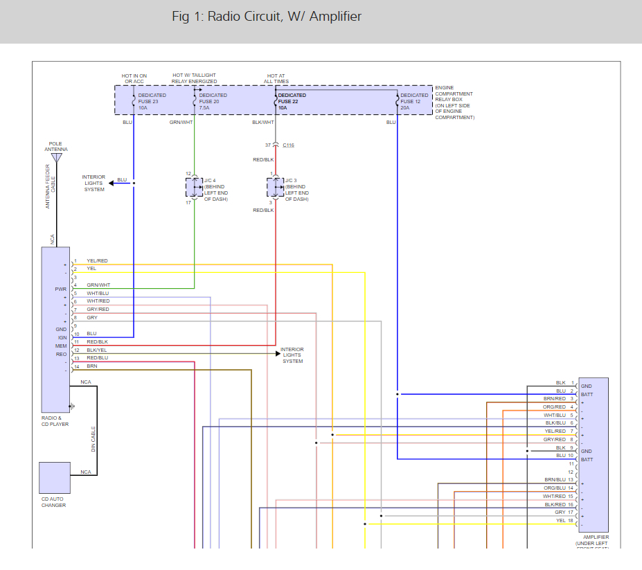

Guys, the OEM radio has been replaced with a pioneer unit. is there any way to contact the assembly facility to acquire the codes necessary too reprogram my anti theft system? i am a victim of criminal intrusion and private property ever since purchasing this vehicle. i am assuming the VIN has all that on identification. may we communicate? also, do you have the email address to the Japan facility of manufacture location of the Outlander model. need to communicate.
Feb 22, 2019 at 12:24 AM
  • 55,433 POSTS

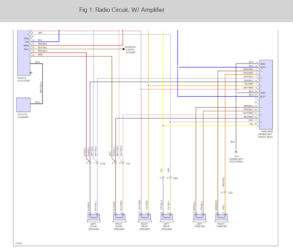

Hmm, I don't think the security runs through the radio. here are the radio wiring diagrams so you can see how the system works. Is the security light flashing? Check out the diagrams (below). Please run this test and get back to us.
