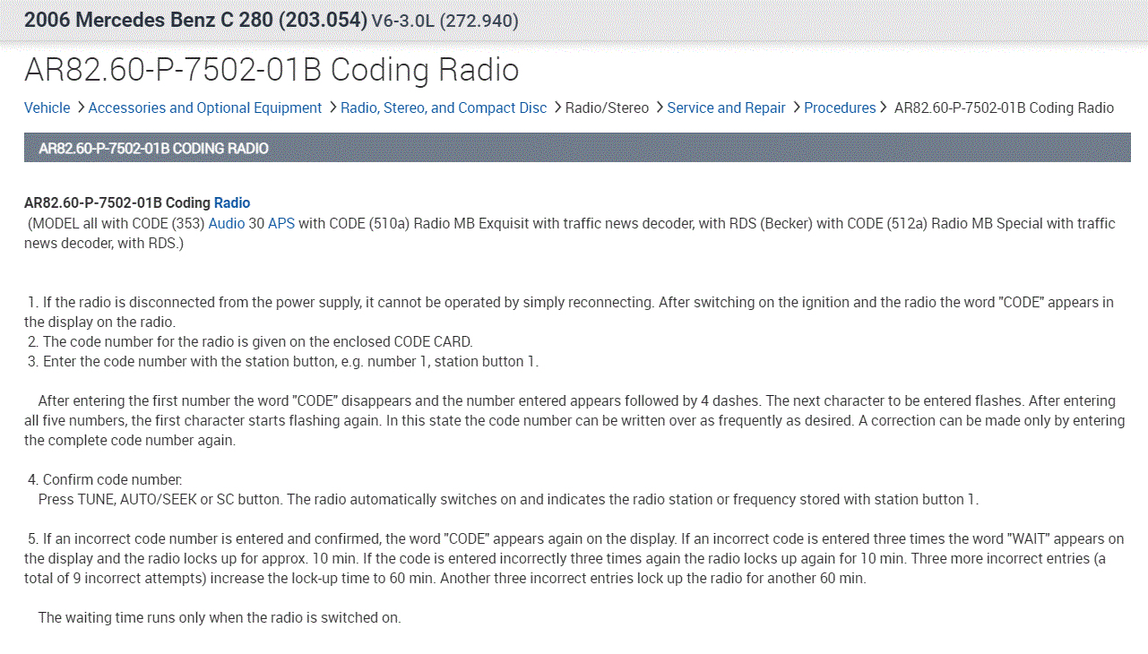

I disconnected the negative cable on the battery to change the crankshaft position sensor, now the radio is on constantly and the radio display reads "diagnosis" and does not function.
Aug 25, 2021 at 1:55 AM
  • 110,244 POSTS
When power is removed from the radio, it needs a specific code to work again. The code will be in the vehicle's owner's manual and is specific to your vehicle. There should be an actual radio code card. It will actually be a small business card size code card.
If you look at the attachment below, it provided the directions for recoding the radio.
Aug 25, 2021 at 12:57 PM

Update: I disconnected the negative cable from the battery for 30 minutes and then reconnected it, the message is gone and the radio works fine. Now I need to know if I can change the runner arms without removing the complete intake manifold. It seems I should be able to remove the components on the front of the engine to get to them and change and update the mechanism. Have any of you done this?
