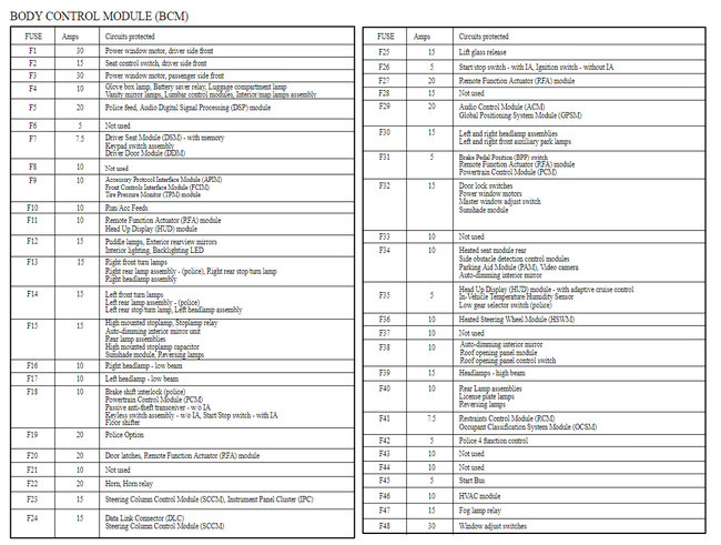

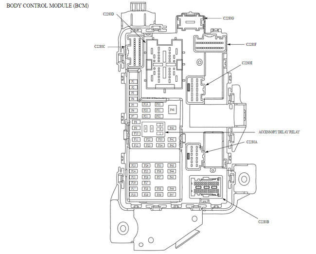

My heated seats don't work and my remote start is not working, but the back up camera sensor still beeps. all other electrical stuff works on the car could these problems be the result of a bad control module? When a diagnostic check was completed it stated no power to the fuses in the center console area.
Jul 2, 2019 at 3:53 AM
  • 55,782 POSTS
The CAN scan did not pick up any codes? Here is a video of the job being done:
https://youtu.be/InIlnsjOVFA

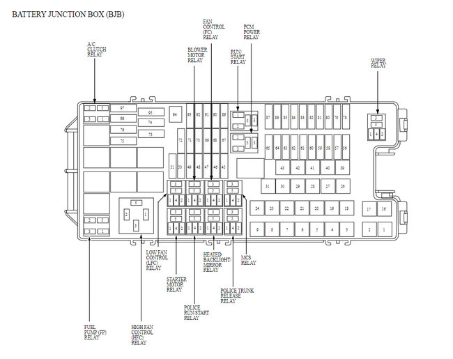

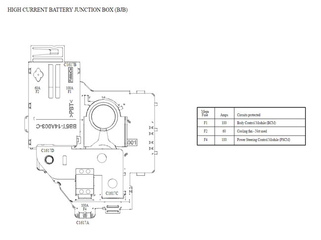

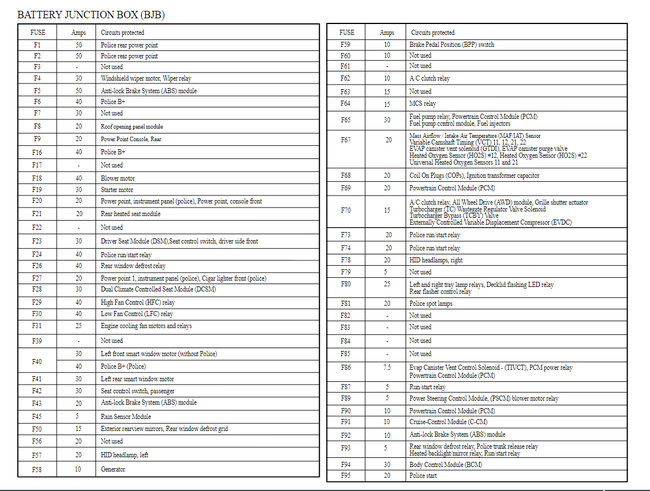

We need to check for fuses and accessory delay relays first which these guides will help with and the fuse diagrams and power relays are below the guides:
and
Jul 3, 2019 at 7:12 AM

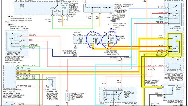

The HVAC system is not turning on?
Jul 28, 2021 at 4:21 AM (Merged)

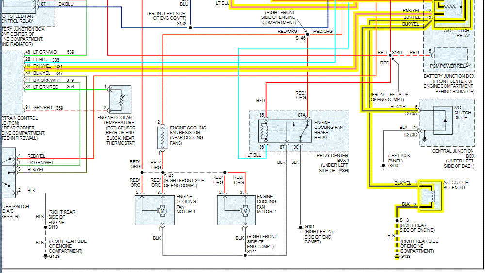

Does the control head light up? I attached the wiring diagram for the clutch. Check the 2 fuses I circled for power on both sides.
and
Check out the diagrams (Below). Let us know what happens and please upload pictures or videos of the problem.

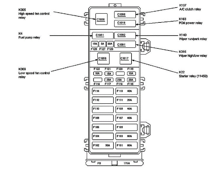

VSOHMEN
Please let me know:
1. The location of fuses for the HVAC system for car listed above SES.
2. The milliamperes for the above fuses.
3. The color code (orange/red/blue?) for the above fuses.
Thank you!
--vsohmen

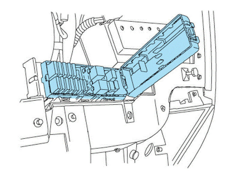

Okay,
1. Under the hood in the fuse block. I attached a picture and the fuse locations by number.
2. The fuses are marked in the diagram I posted previously with the amp. they are both 10 amps. Fuse numbers 122 and 128.
3. Red is the color of 10 amp fuses. You can get them at any parts store.
