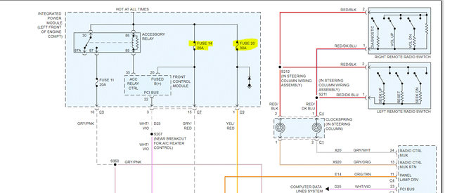

I bought the van listed above and I have zero power to the radio/cassette/CD or DVD system. Dash lights are slow to go out after taking key out . Slow to start often.

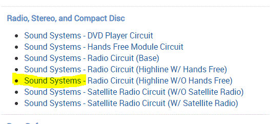

I'm not sure which radio you have. If you look at pic 1 below, I listed the possible ones it could be. Note that I highlighted one. I have a feeling that is the one in question. If I'm wrong, let me know.

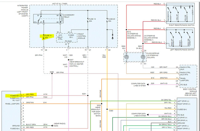

If you look at pic 2, I highlighted two fuses I need you to check. In addition to checking the fuse, I need you to confirm there is power to the fuse and out from it. Here is a link you may find helpful:

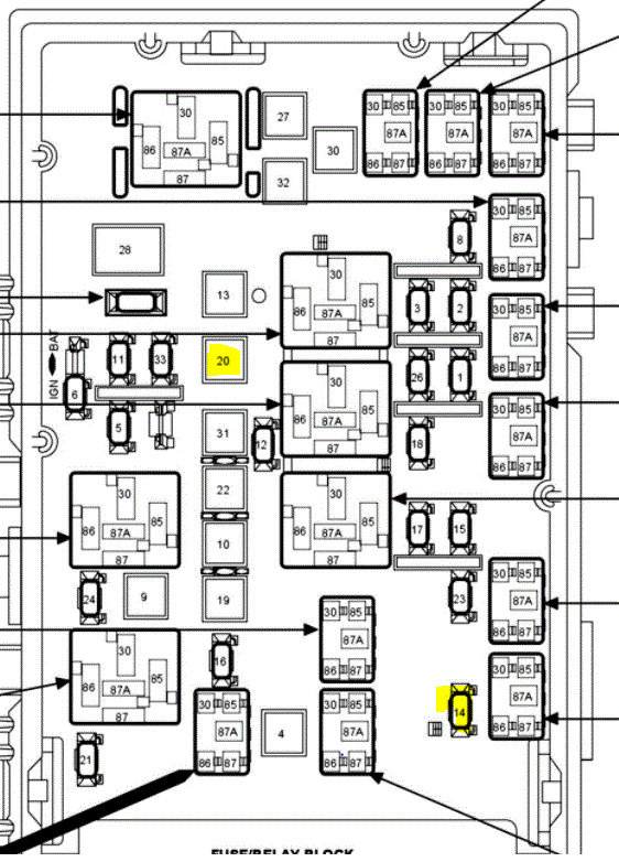

Pic 3 shows the locations in the power distribution box.
Let me know what you find and if I have the correct radio.

The radio in the van is the AM/FM, CD player, cassette player then heat in the middle but heat work). I've checked fuses and relays and still have no power to any of the above! Also my key fob (I only have 1 key) does not work to do any functions other then start the van. I replaced the battery to the fob today.

The schematics I added above should work. When you checked the fuses, is there power at that point?
Let me know. I have to be honest, they used what is called a totally integrated power module on these vehicles (TIPM). They have a ton of tiny pin connectors which are known to break, corrode, and not make a connection. So, we are going to have to work backwards on this.
If you haven't already (and I think you have), confirm there is no power to the radio. Next, at the fuse, confirm if there is power or not, and let me know what you find.

Yes, there is power on the wires, 2nd or 3rd pin on the wires lights up the tester.
