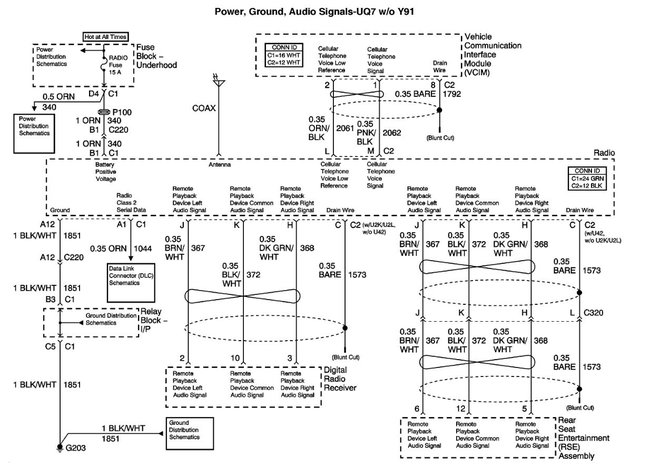

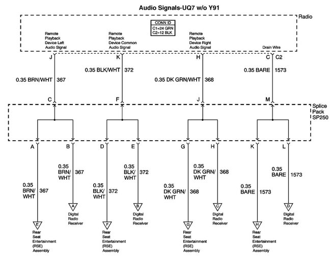

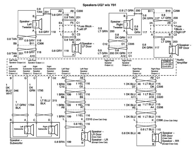

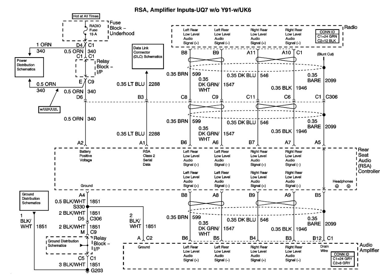

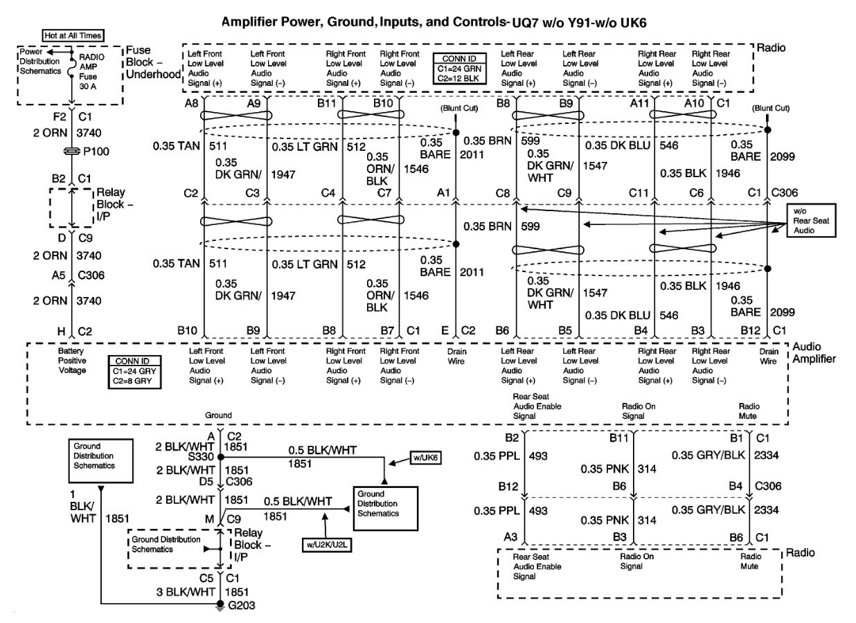

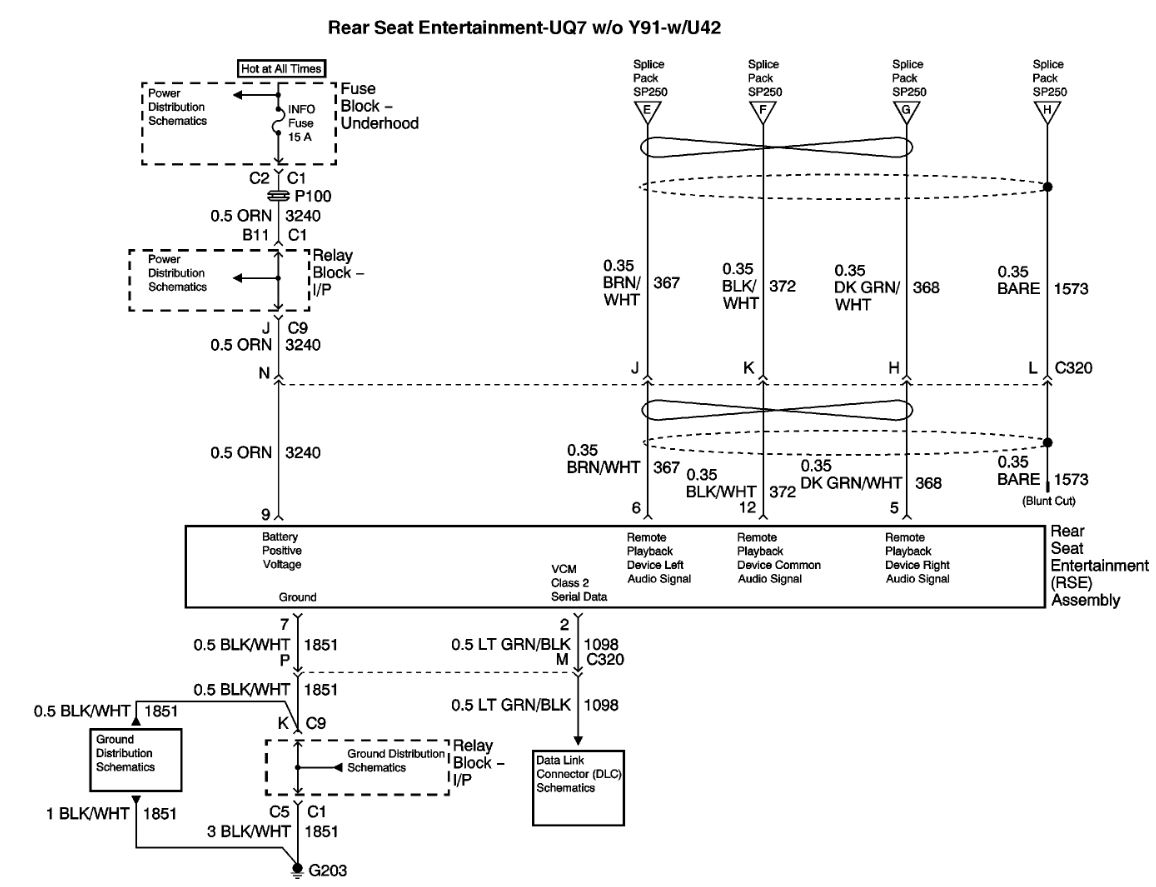

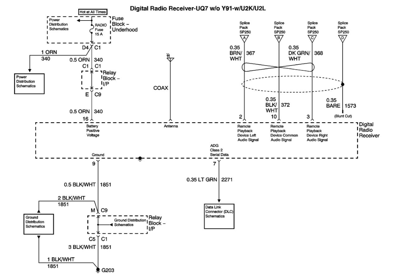

I would like to have the wiring diagram of the radio with sound system Bose for the truck listed above, LT model, but without the roof, tv.
Sep 1, 2021 at 7:19 AM
STEVE W.
  • 15,299 POSTS
These should be the diagrams for the Bose system in that truck. It covers the audio unit, amp, speakers and the controls. What is the issue you are having with the system? The entertainment system is option U42 but the only part of that which connects to the rest are the control signals and the audio lines.
