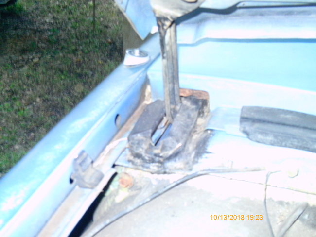

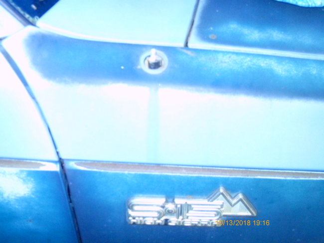

Hello, I have a question for you. I have a small pickup listed above. The pickup’s radio antenna broke off from the antenna base. I need to replace the antenna cable wire and base, but none of my repair manuals show how to get to the antenna mount. The radio antenna and mount and cable wire is built into right front fender (back end of fender). I cannot find any way to get to the antenna base and cable. I have looked under the hood and open the right side door and I still cannot find a way to get to where the base and cable are. I need your help. If you have any pictures of how to do this repair, plus step by step instructions.

I was unable to find anything that lists step by step. However, I will do my best to explain.
First, there are three parts to this assembly, the mast, top mount (exterior of the fender) and under that (cannot be seen is a threaded mount which is not welded to the fender).
What you need to do is remove the inner fender to access the threaded mount while you turn the top mount to loosen. The two parts will come apart for removal. Once apart, remove both items. New ones should be included with the new antenna.
I wish I could do better for you. If you look on line for universal replacements, you will see how the two parts bolt together. The worst part is you cannot get to it until the inner fender is removed.
Let me know if this helps.

Thank you very much. When you say inner fender, do you mean the metal cover that you see up under the fender when you take a tire off that runs from under the front of the fender to the back of the fender?

That is the only way I was ever able to do it. If I recall on the early year trucks, there are two (approximately 8mm) bolts you will find under the hood in line with the antenna. On some of these trucks, that is what held the mount in place, so check for that too.
